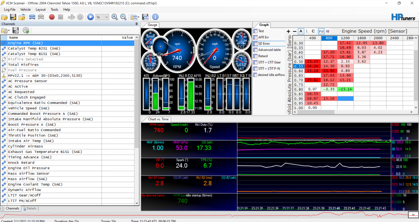

as long as its set up the same way your ve table is, using the wideband to find the error your gtg
but it doesnt look like it is...the left column on the VE table is manifold pressure in kpa 15-105 by 5s***nm just noticed you had it scrolled down
rpm prob right 400-8000 by 400rpm

Yeah, it's the same on scanner and editor, I typically copy and paste special by half then had interpolate. I did a desired idle AF log this morning since it was 39* and the only one I did before the intake temps were like 131 then I interpolated back. Guess I just have more fine-tuning to do which I've been needing to its just annoying having to have a power source and bench harness every time I write a new tune. I need to pull the damn radio out and chop the chime adapter because that's the last thing I know to try to get it to stop failing mid-write.
I guess the work never ends, thank you for the help.

never had problems writing - does it just abort halfway thru? can you use a power inverter on the laptop charger or something?
i usually dont interpolate with the VE i usually blend in by hand (phsycially drag the points up/down as needed) it isnt always a linear transition between points
It's not the laptop that needs constant power it's the ECU itself. So I have a harness that sends a solid 12v straight to the blue plug on the ECU. If I don't it will typically have a time-out error either during the erase or the write. Sometimes if I try it a dozen times and turn high speed off it will eventually work but that's 1-100. It was bad about it when I got the truck but then the new radio, back up/dashcam, and amp install it went total fuckery and I really don't want to pull the radio birds nest out unless I have another reason to. (I didn't install the radio)
I don't interpolate by highlighting a bunch of cells and clicking the button. I typically look at the numbers and find discrepancies that stand out then smooth them or at least remove an obvious oddity for example 40-33-51 would likely get corrected to 40-45-51 then note that for the next log in case it shows that was a mistake in the next log. I'm terrible at manipulating the 3D graph.

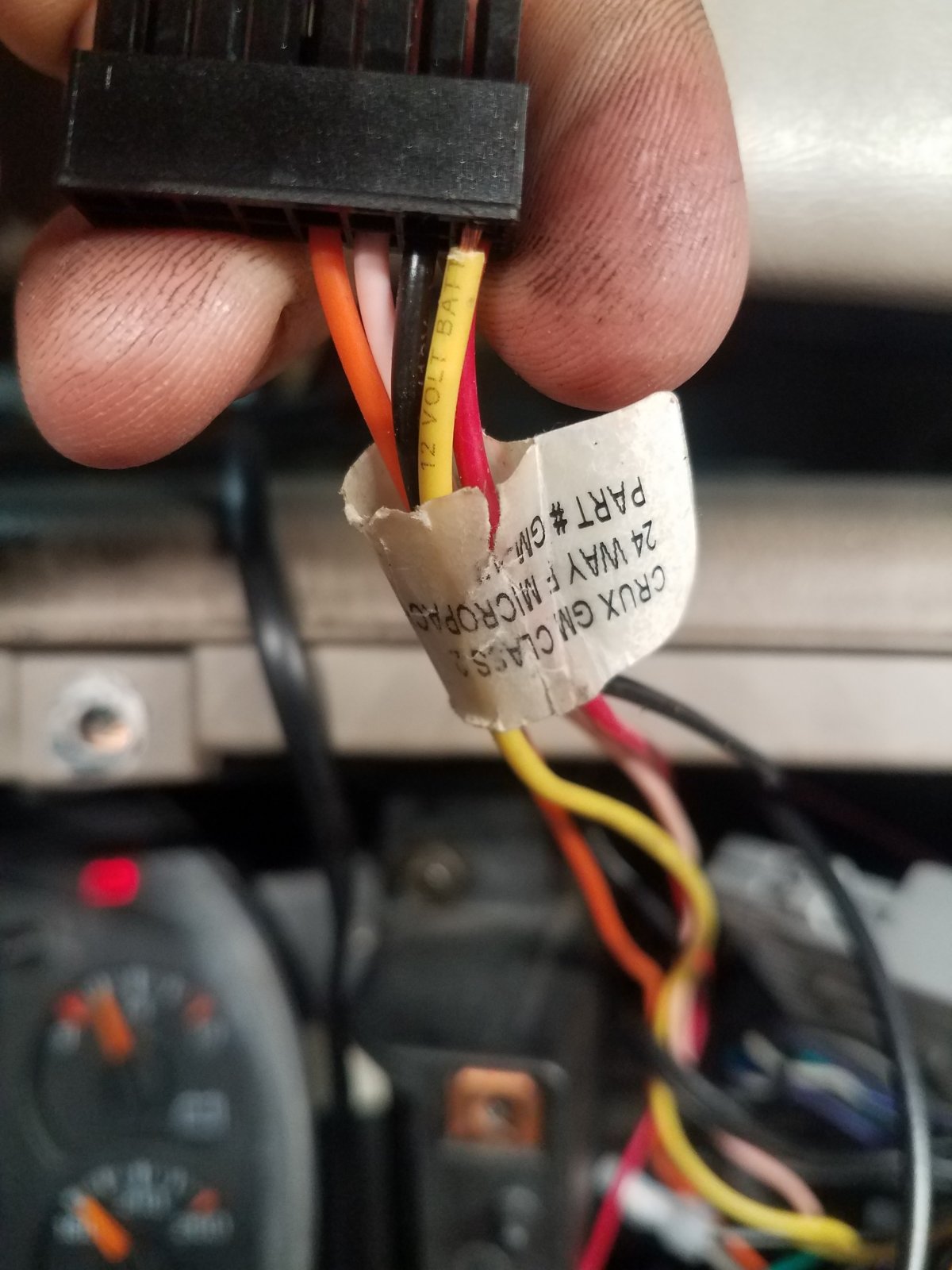

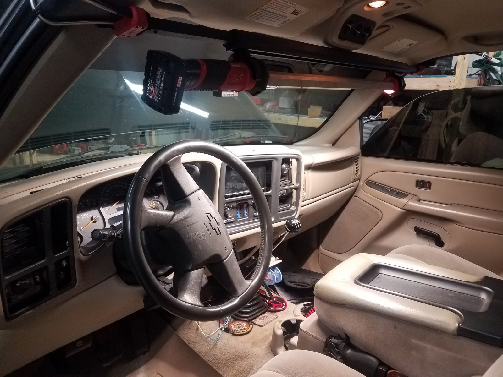

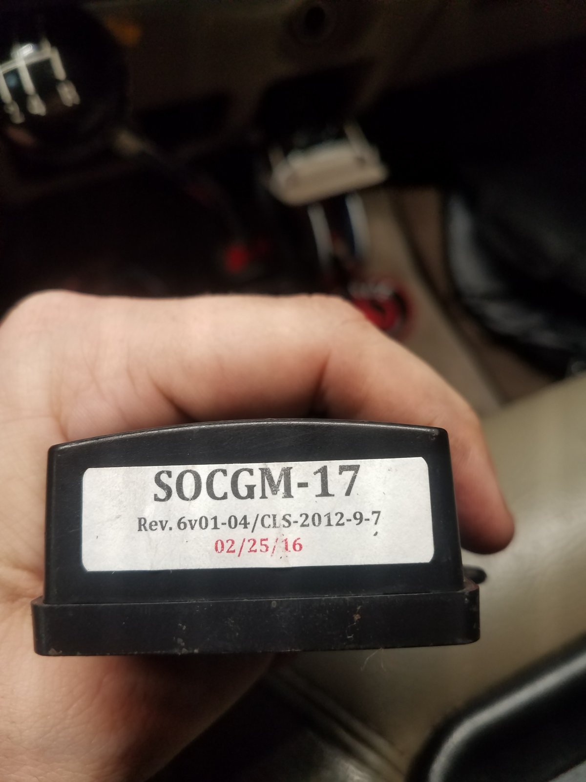

Since it's cold I decided to do what I despise to do during the summer. Found out the Milwaukee engine light is perfect for dash work!

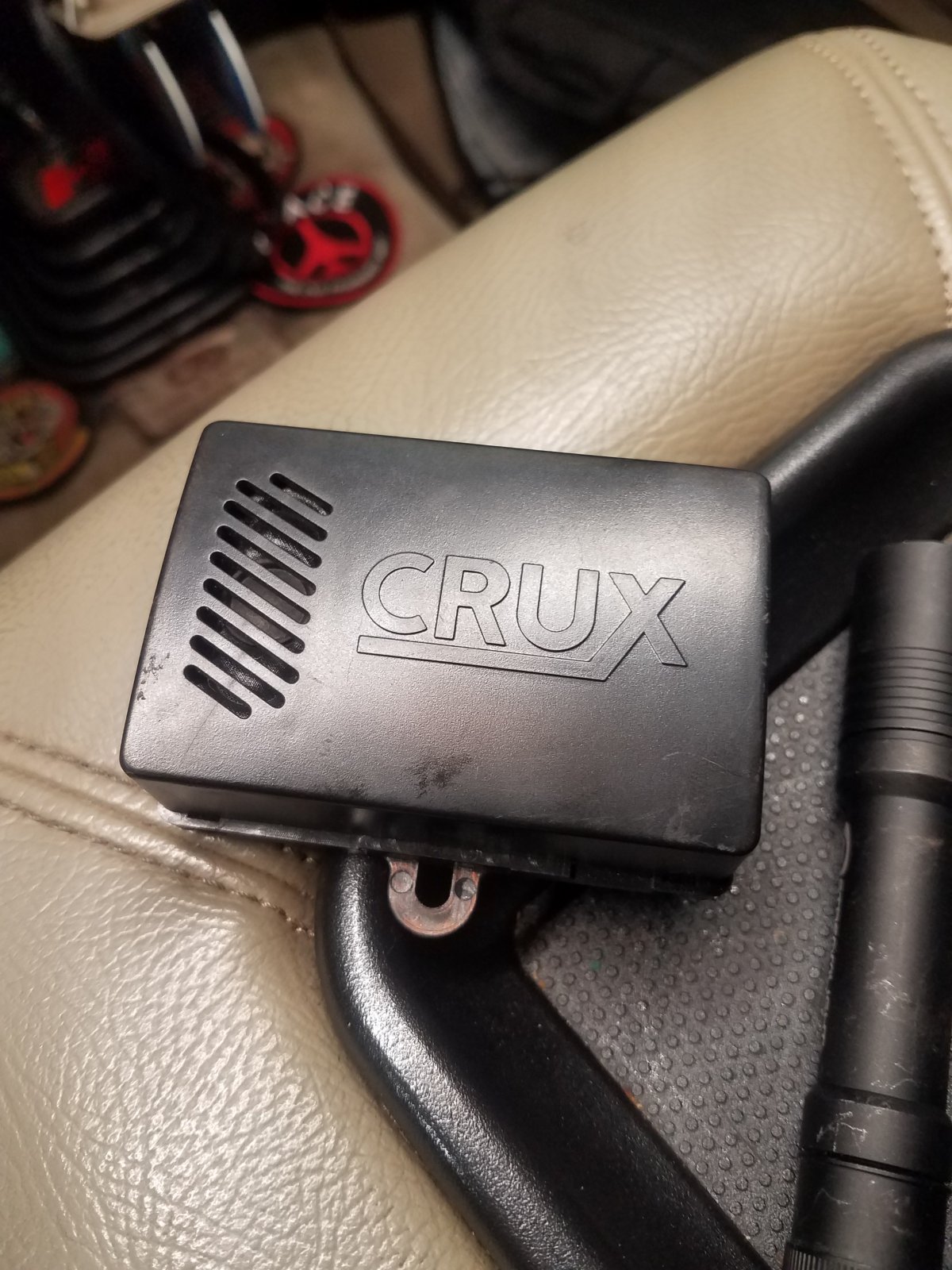

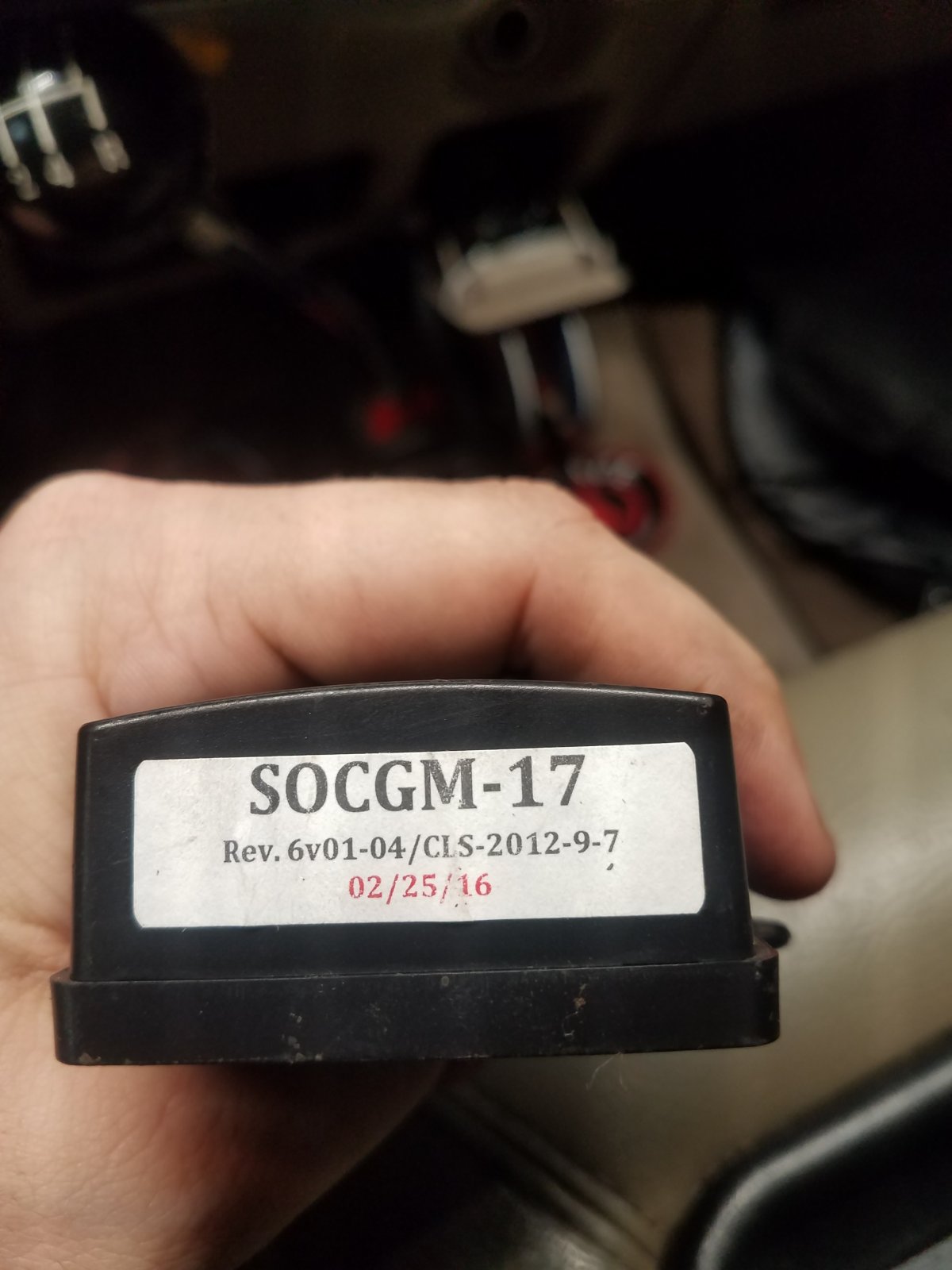

Chime adapter BS is the problem. Dug it out of the dash and unplugged then loaded a tune in less than a minute. It was glorious! But with it removed the radio doesn't come on, can I hook some wires together or something to bypass it?

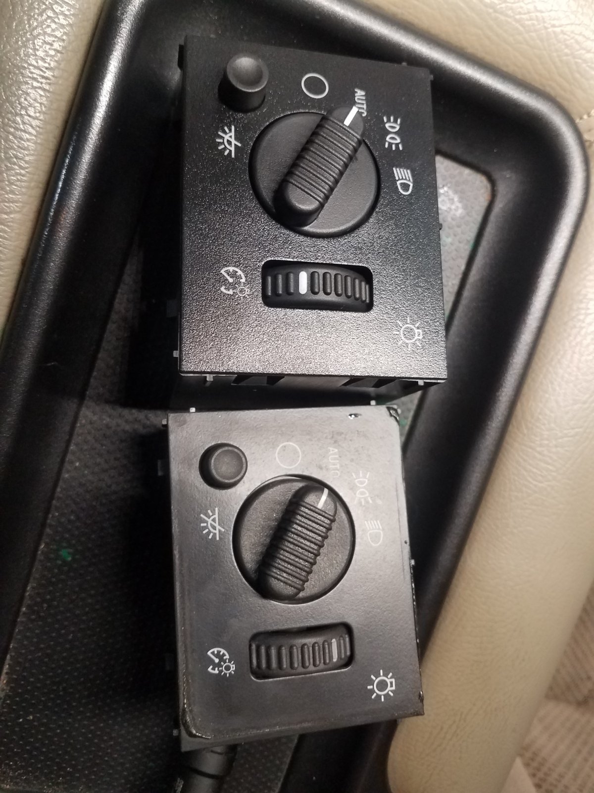

Also replaced the lights button and dome light seems to be working as they should.

View attachment 269548 View attachment 269549 View attachment 269550 View attachment 269551 View attachment 269552
Glad you found the problem. Maybe you can wire up a quick disconnect for the power wire to that adapter, that hangs down for easy reach next time? That light is perfect for dash work! Very good...! [emoji16][emoji106]

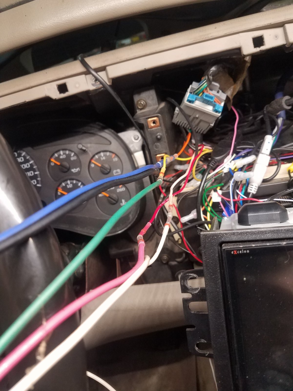

Great minds think alike! Wiring extension harness now to relocate it under the dash for quick disconnection access during tune writing!
My colored wire selection is poor so these are all scraps lol.
Haha! Whatever works! As long as you use heat shrink tubing, who cares? lol. Git-r-done!
