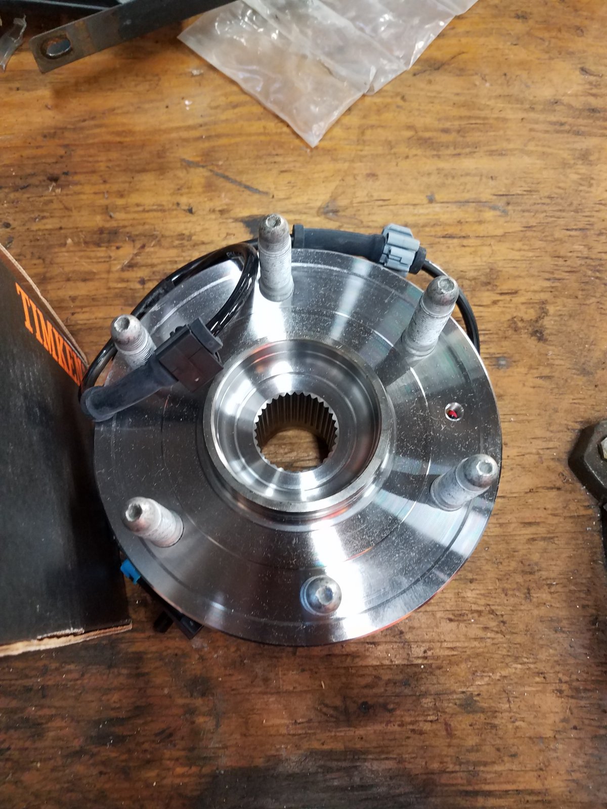

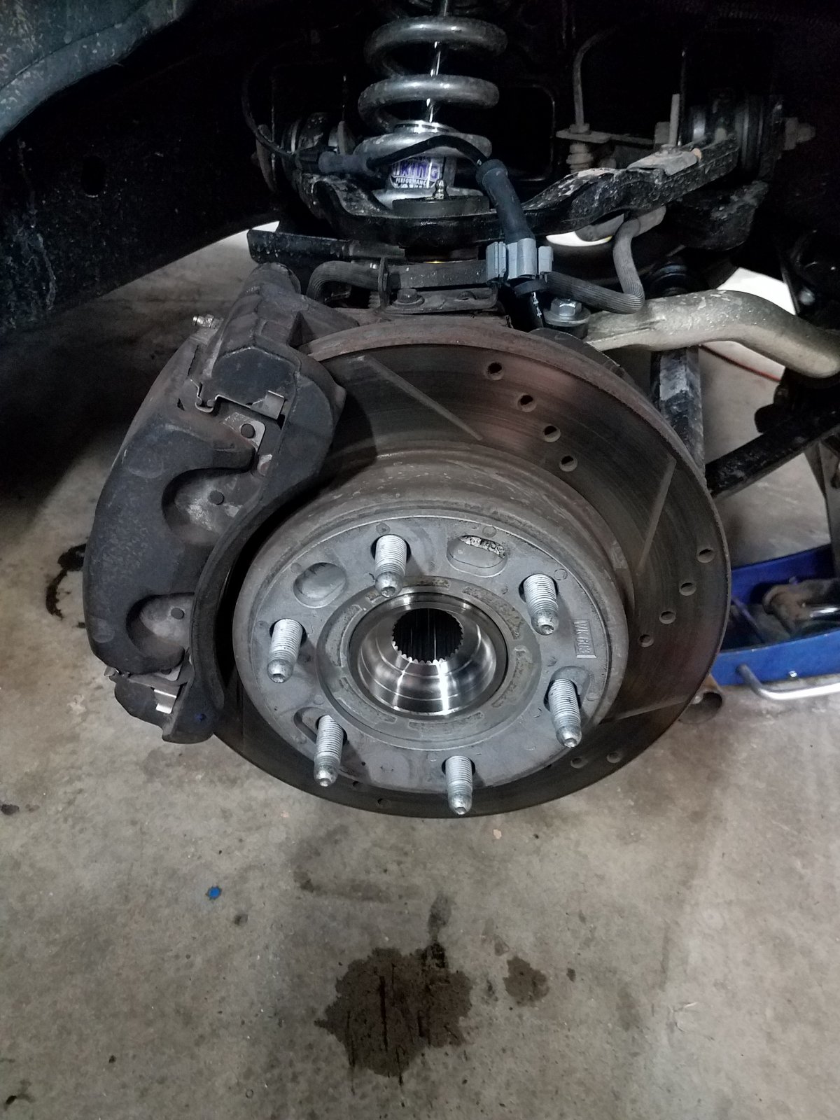

Time to replace the very last OEM item on the front of this POS. I find it funny that I used to dread doing a wheel bearing or really any suspension/drivetrain work. Now it's my favourite and I'm not sure why.

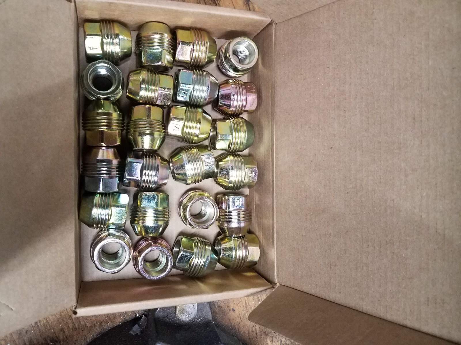

Sonsofbitches!
It's ok they can talk shit cause its true, these new nuts are much nicer than what I was using before idk where I even got the other ones because the front half of the truck has cheesy 19mm and the rear has 22mm. Idk if I did that or if it was like that when I got it. I rarely have both the front and back off at the same time.
