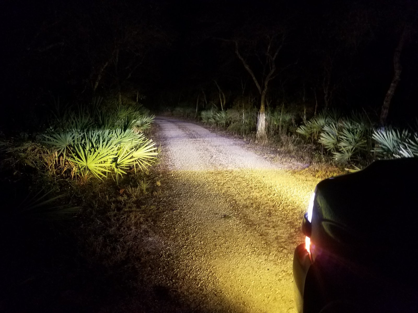

Anyway need to find a better mount option for the fogs still, they sit way to far back in the holes.
Here's a cool pic of the lowbeams+fogs illuminating my new driveway. I love the output from such a simple setup. I'm hoping pulling the fogs out of the hole allows their pattern to widen.

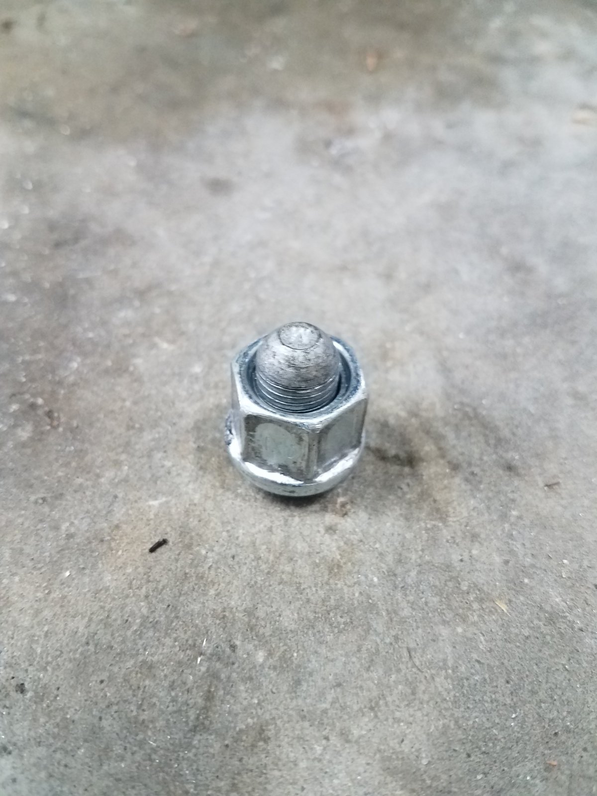

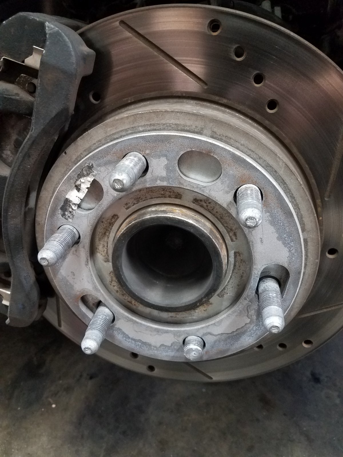

Alright, re-measured and the driver side continues to drop a little down to 33.5" so I decided rather than continue to crank it since it rides amazing I dropped the passenger side to match. While doing so I decided I always wanted to do a 5lug swap and the last OEM part on the entire front end was happy to oblige :banghead:
That sides lug studs have been finicky for a while and I always hand tighten before dugga dugga but I may have forgotten to do that last time since I've had them on and off 13Gazzilion times in the last week. Oh well, I'm not worried and If another one does it then I'll replace the hub otherwise it'll ride till it gets noisy. :head3:
