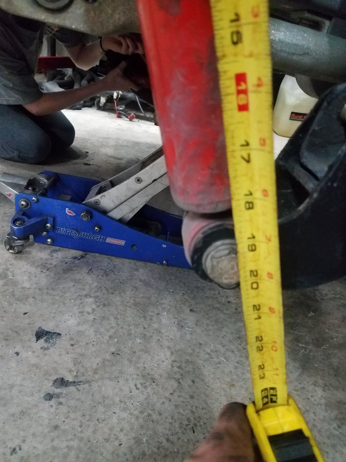

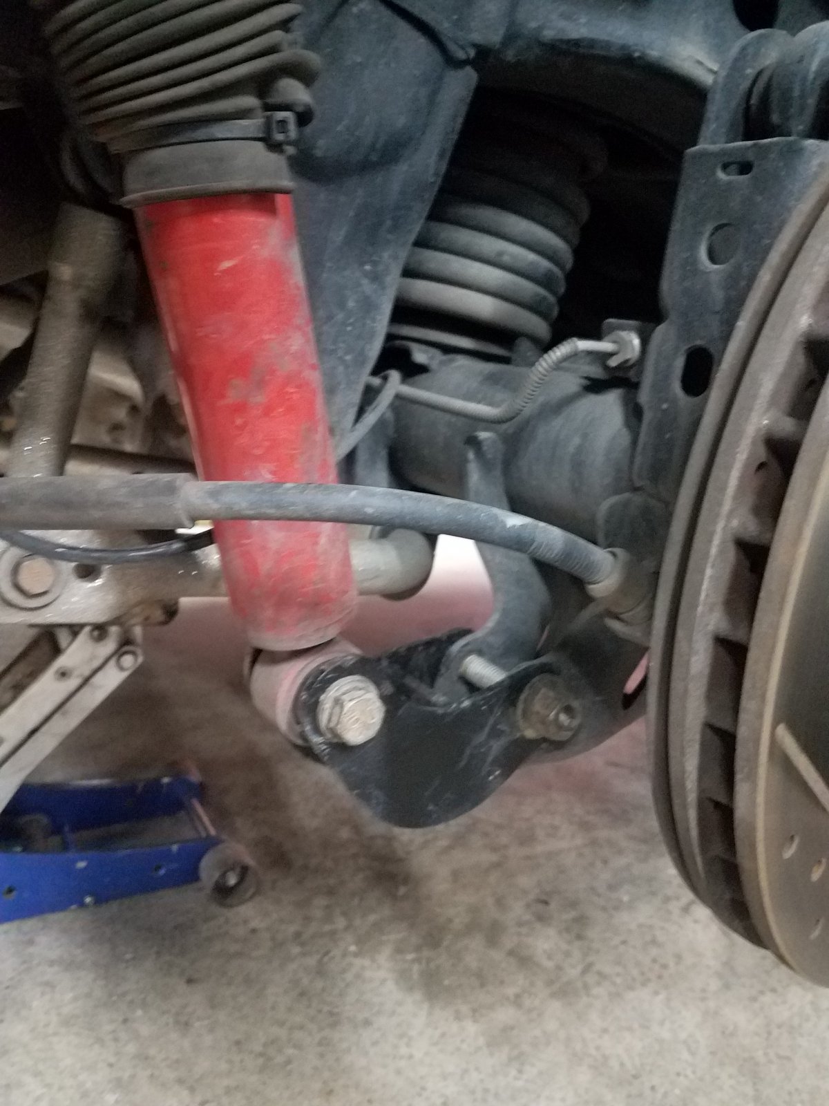

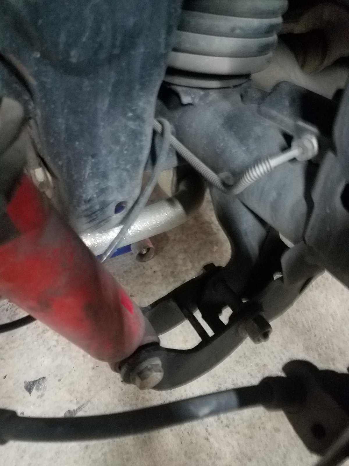

Well that ain't right. Looks like skipping the bolt that keeps the shock extenders pin in the downward position was a bad idea. I only skipped them because I couldn't find them so I swung by ace the expensive place and got some grade 8 boys.
Also measured for shocks for the third time but now I have a picture to refer back to. I also measure distance before bump out and its 4.5" which is more than I expected. I forgot to put a dab of grease to see of its bottoming out but i don't think it is. Personally I feel like the springs binding because at ride height the lower coils are already bound up tight which is odd. You can kinda see the coil in the last pic.
Also added a little more preload to the driver side it dropped about 3/4" and the passenger dropped 1/4". Brought driver up to Passenger height at 33.75" which gives it a tad more rake which is okay in my book.

just ran out and measured mine, its sitting right at 16.5". need to find the sheet that lays out all the sizes for the vikings
