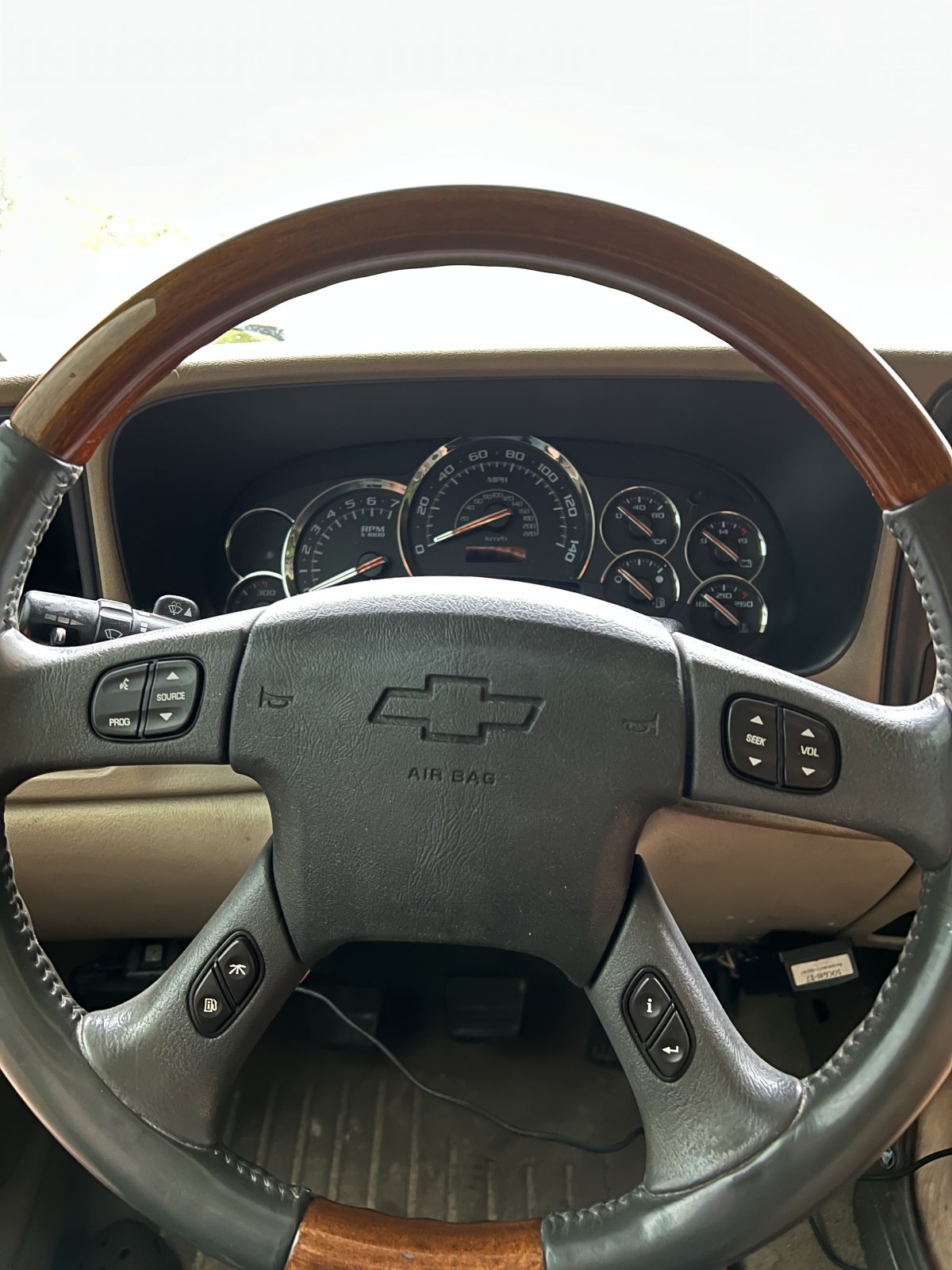

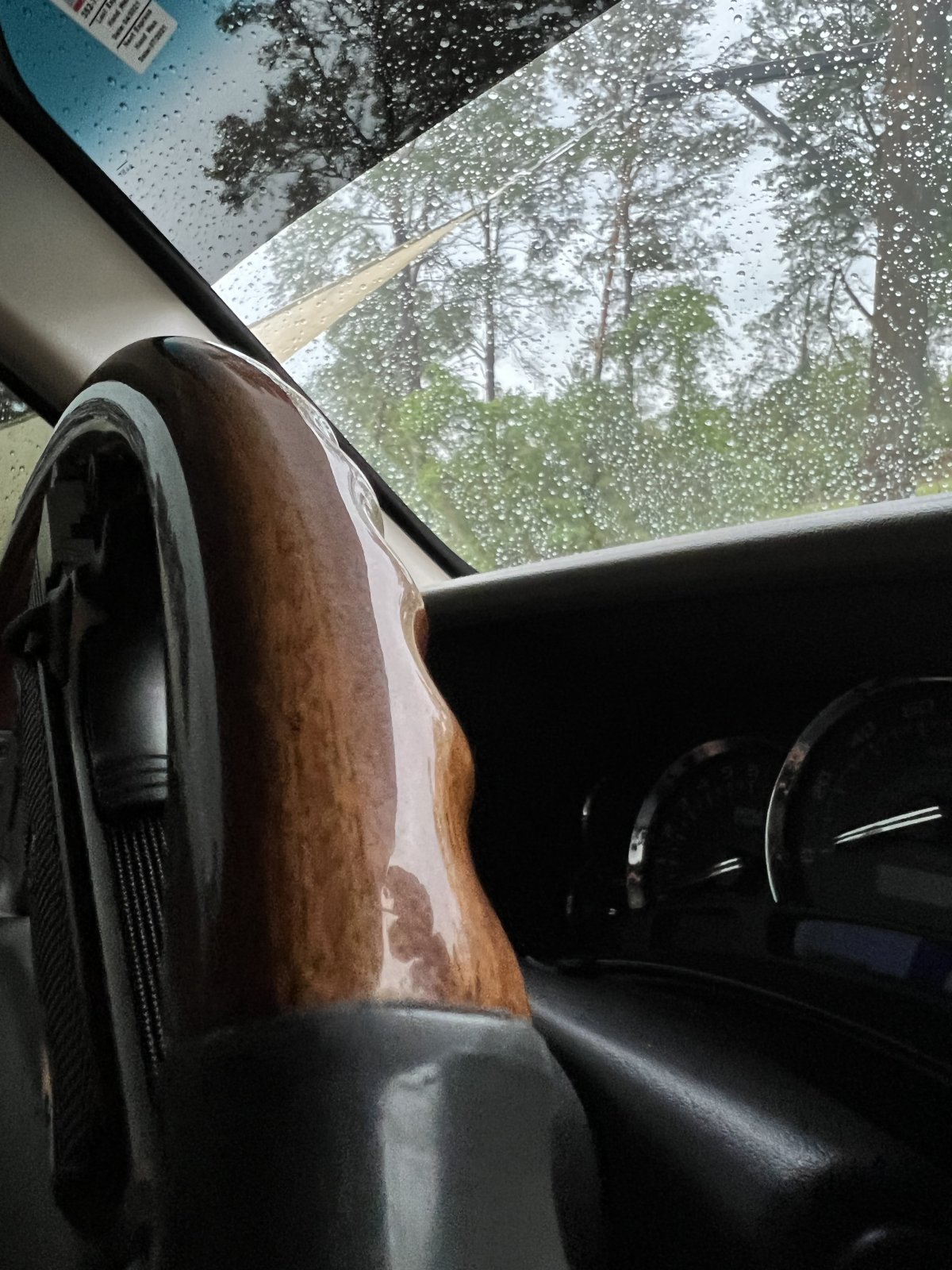

Got the new wheel on during what felt like a hurricane earlier today. Feels much better than the falling apart old wheel, it definitely needs a cleaning tho and the grey doesn’t perfectly match the airbag but I really don’t care the interior isn’t all that good to look at anyway.

Mmmm... Grip dat wood, boy.

Wheel looks nice in there:)

Agreed. Looks wheely nice! Is that hardwood? ;)
The hardwood is actually just below the wheel and cropped out of this picture ;)

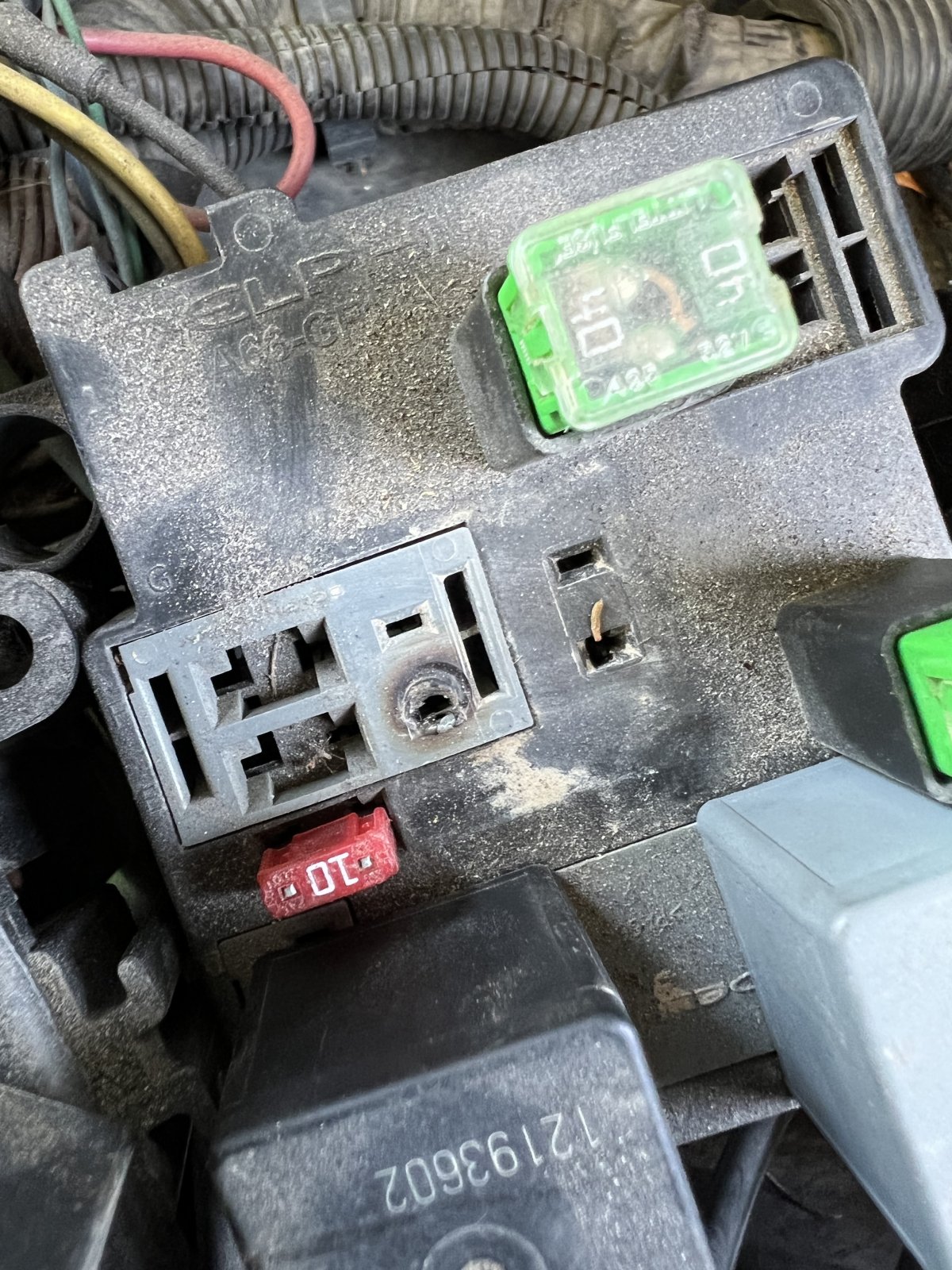

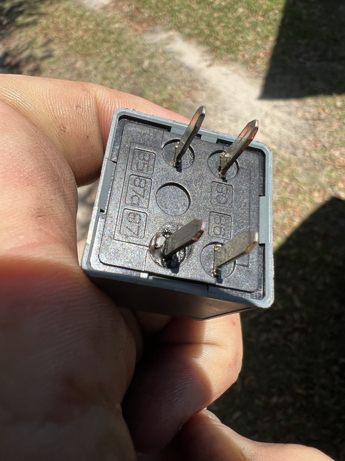

Might have found my ac issue. Relay is burned up for the driver side fan so it’s not kicking on. The question is what’s causing it to burn up like this.

As far as the fan relay, any wires messed up in the harness? Maybe it's just a case of a failed part?

As for the AC I did two things to fix it. (God I hope it’s fixed and wasn’t just playing nice for a few miles).
1 was the relay which I think might have burned up when I was playing with ram settings last year, I remember having it to kick on and off much to often and after a few weeks I switch it but it may have already burned up the one relay it looked old.
2 I copied all the idle adaptive parameters from my buddies Denali tune to mine and it seems to work great!
