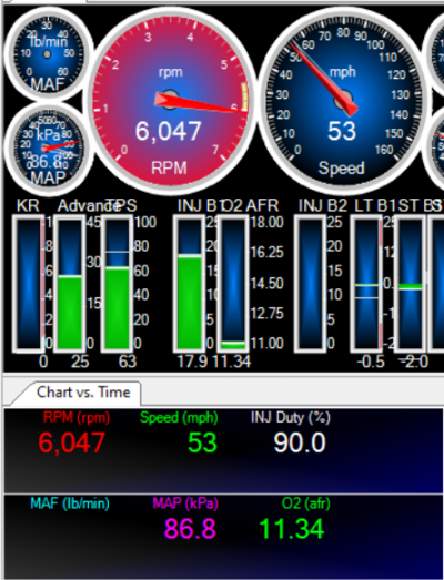

Can't remember what is considered safe IDC but I'm at 90% at 6k but 11.5afr so once its leaned out I don't think I'll be any higher that 90% even at 6,500rpm.
Still having that weird ass rich condition that shows up in the first minute of driving. as well as the AC compressor not always wanting to stay on. I need to put a set of gauges on it still but I don 't think its a pressure issue, Fairly convinced its a tune issue.

tuning sucks
yea 90% is ok every once and a while at the top of a pull - you on e85?
my ac is still assfucking me too. idle is dead nuts on without ac on, with ac on and compressor always pulled in stable all day too. soon as compressor starts cycling it all goes to shit rpm swings from 400-1200.

Yep that's exactly what symptoms I'm having. I tried adding stuff to the engine>torque model>loss> AC compressor vs pressure table before I did these heads but I was having a little bit of high idling so I just zerod it out and I'm about to try it without it. I have a feeling its gonna be worse and then I'll end up adding more than before. assfucking assfucking assfucking assfucking assfucking.

yea ive tried adding to the torque loss tables n crap, more and less, the gen4 crap has like a fade in/out of the torque ive tried moving those all over and it just gets worse.
i havent tried to completely remove it all which i guess i probably should to just see if its not needed
