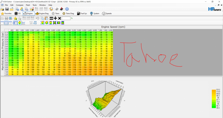

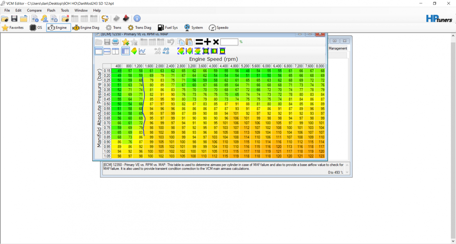

Something I find very odd about my VE table is this massive jump between 1,200 and 1,600. Looking at my last log its showing the cells in 1,600 are actually 6% lean and the cells in 1,200 are about dead on and below 1,200 is actually rich by 9%ish. It just doesn't seem right to me having such massive jumps so drastic and I feel like it would cause issues.
pwtr02ss
Apr 1, 2013
14,240
33,406
Tennessee
Do you have another map sensor you could swap in and see if it changes?

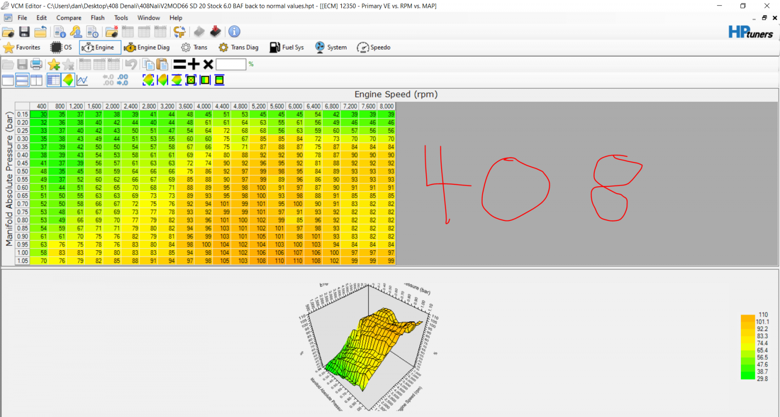

No I don't, but I don't think it would really make a change anyway because if the AFR is reading 14.7 while the map is calling for that amount then its working correctly. Let me compare my 408 denali buddies VE table in that area, it has an even crazier cam and heads.
Dantheman1540
Dantheman1540
Feb 13, 2020
4,975
10,828
Sugar Loaf Mountain
Although the 408 table could use some smoothing is a few random cells, its makes more sense in my head where fuel is increased as airmass and RPM pick up not randomly at 1,600 and then again at the top end. I think I'll try dropping those cells down a bunch and seeing how it acts.

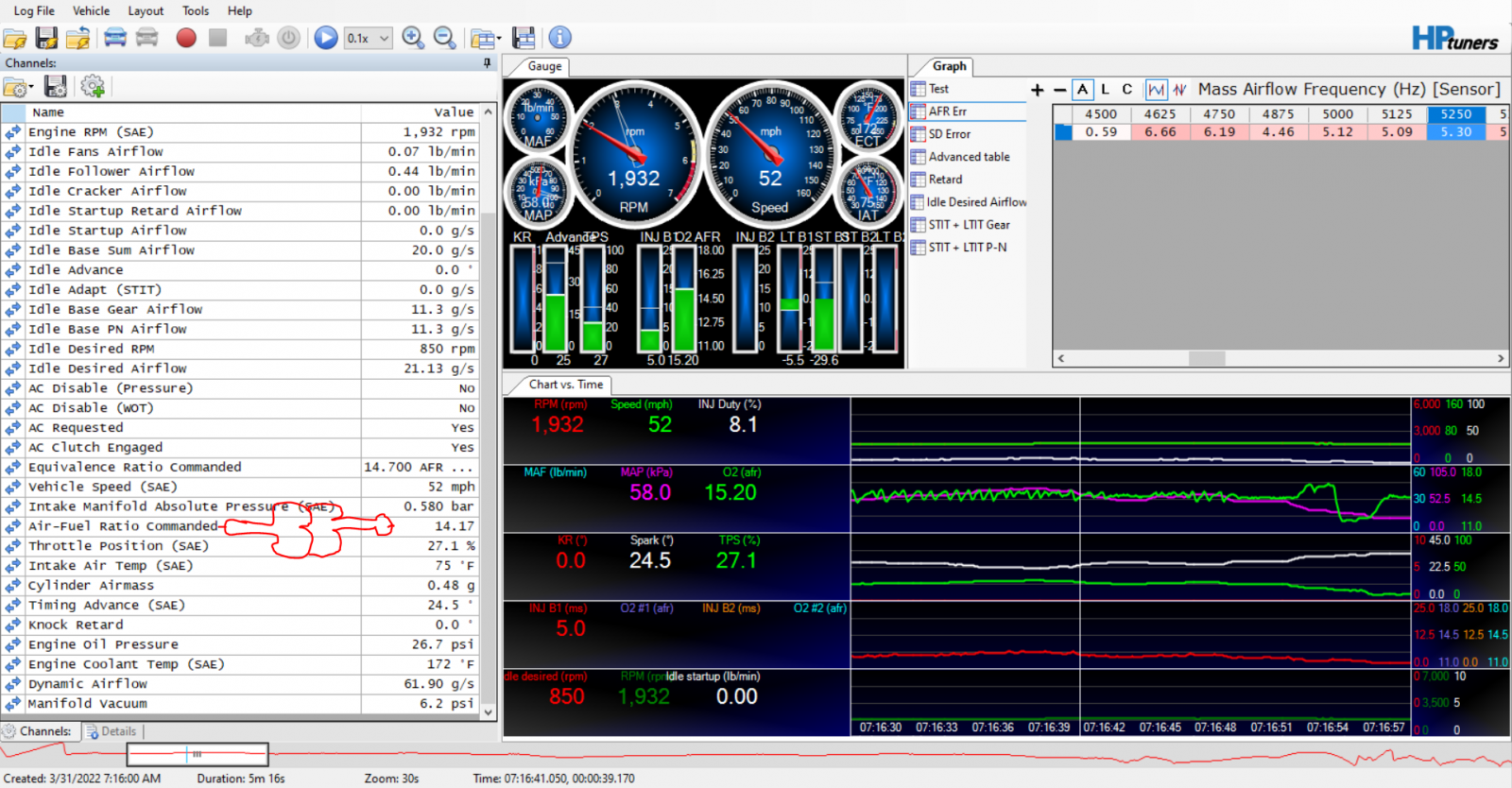

Ok @randeez why is my air-fuel ratio commanded showing 14.17 not 14.7? I can not for the life of me remember how to change that but I also have no idea why it would ever have been put as something other than 14.7.
randeez
Sep 29, 2017
8,197
25,967
south florida
engine>fuel>general> stoich afr
thats what the stoich should be on E10(pump gas), does your truck have a flex fuel sensor?
pwtr02ss
Apr 1, 2013
14,240
33,406
Tennessee
I think I remember @randeez talking about some math formula to get that number correct along time ago. I believe you changed that when you were initially having stalling issues.
Dantheman1540
Dantheman1540
Feb 13, 2020
4,975
10,828
Sugar Loaf Mountain
No FF, thank you I remembered you mentioning this and I couldn't find that post.
I remember that now, I guess I should have just looked to see if it was reading stoich even tho its showing 14.17 commanded.
