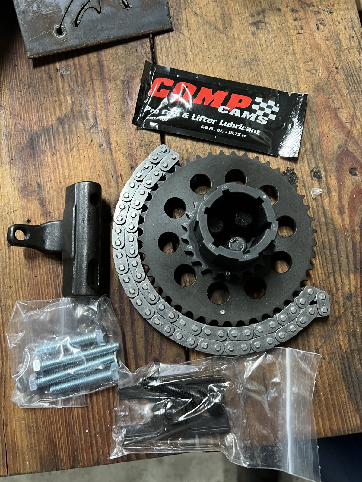

The new Comp Cams spring compressor came in as did the Elite timing set, can't wait to get back cracking at this thing.

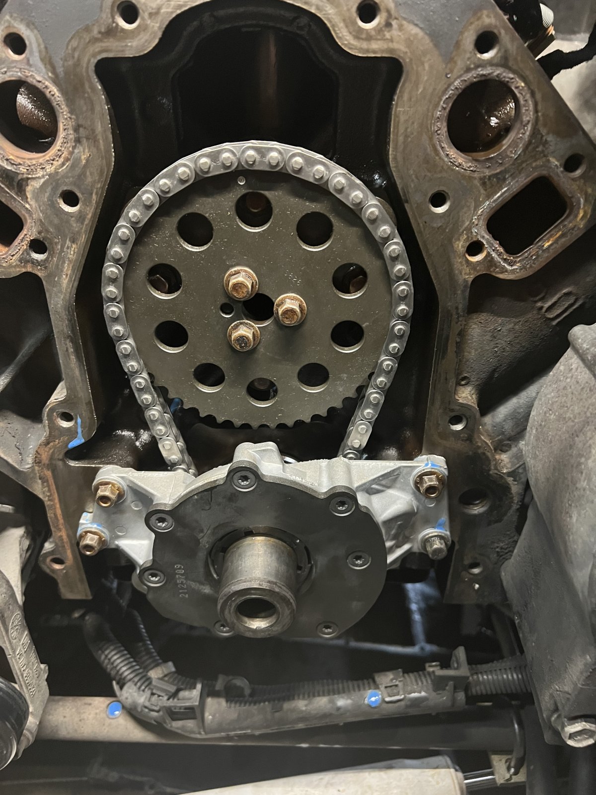

New spring tool worked like a charm except I bent 2 rocker bolts so I need to find new ones. I also got the crank bolt right off after yanking the fans and getting the impact on without a wobble joint.
Didn’t make much more progress other than cleaning up gasket surfaces and getting the timing set and oil pump on. I tried to remove and reuse the old valve seals but they were being stubborn so I just ordered new ones.
