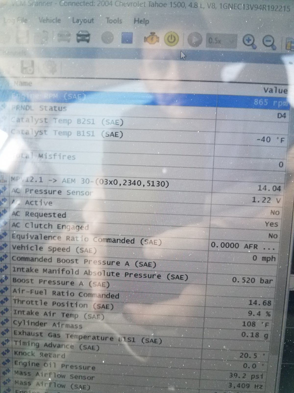

no i meant, can you log the pressure?

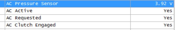

oh uh yes but no, instead of showing a pressure reading it just shows voltage from 1-5v. I suppose I could change the parameters to readout psi but I'm not sure what algorithm I'd use. I suppose if its showing voltage that might tell me something as well, here's a snippet of when I had the compressor manually turned on with HPT.

yea my bad didnt realize thats all you had to go on. dont know that doesnt really tell you anything.
log it koeo, running compressor off, running compressor on, unplugged and see what voltage it shows for each to get an idea.
in my truck you can just log the pressure reading from the sensor - recently had a sensor just showing 100psi when i completely removed it from the port
the range on it is like 0-500psi i think so it may think the pressure in the system is high af
Yep pretty terrible options for diagnosis lol. Here is a log with the AC off and the pressure changes, also as the log moves its obviously sensing pressure changes and the readout changes .xx so I don't think the sensor is bad according to this log. However, this log is a week or so old I hadn't been saving logs lately.

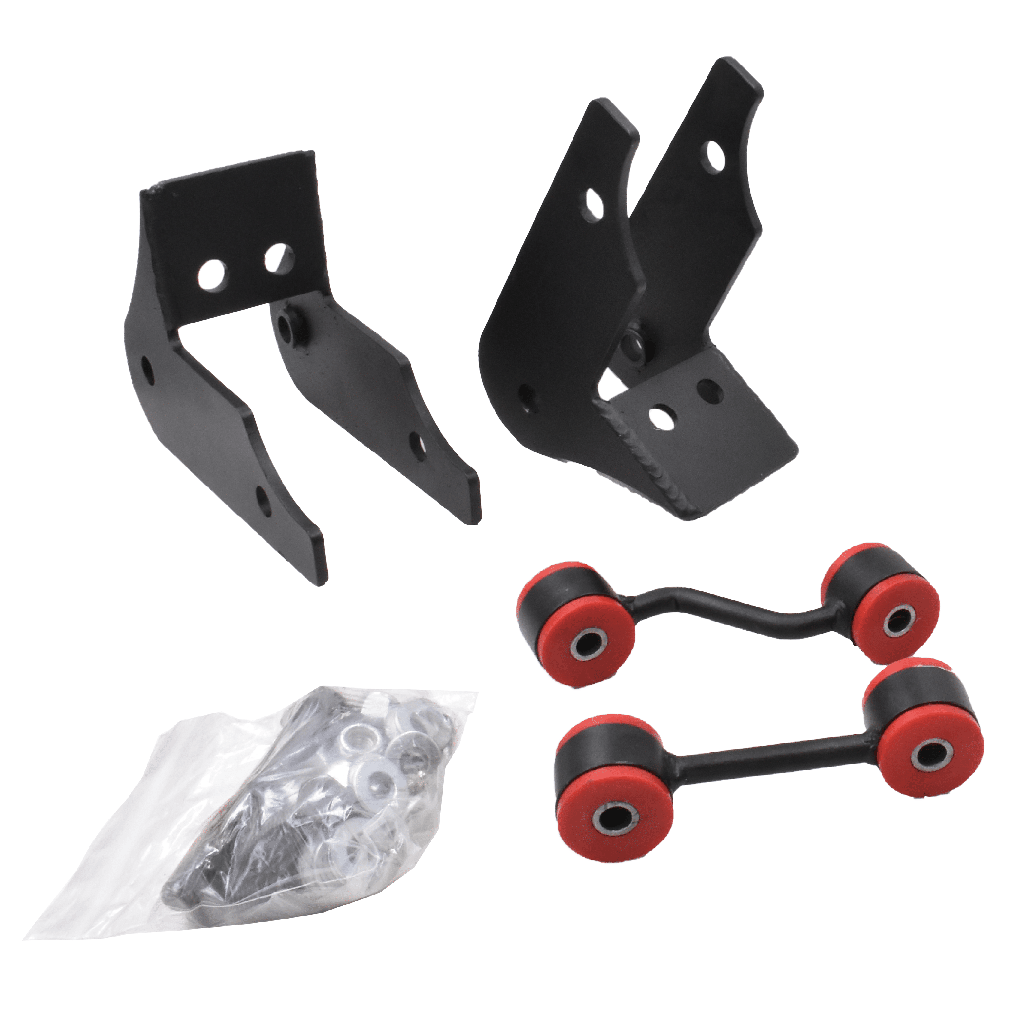

Checked on the Tahoe at the exhaust shop today, it's been there all week and to progress looks great but I have no pics of it yet because my phone is trash. I mentioned how the yoke has been hitting the frame and that I had adjustable UCAs on the way. He thinks it's not so much a pinion angle problem but a lower control arm problem. Basically since its lowered they lose the leverage they have on keeping the axle from rotating.
I remember seeing a kit that may have been discontinued that's essentially relocated the rear LCA mount and I believe it was bolt on. Anyone have any leads it?

Thank you thats exactly what I was looking for! Anyone have pictures of the kit installed other than the black and white ones in the DJM instructions?

Wow that moves the LCA down a ton! Might just fix my pinion angle problem at the same time too. I do hope theres no difference in the brackets for NBS and NNBS because I forgot my axle was from a 2011. Doubts theres a difference tho.
I think there is a difference in that whole shock mount/LCA box thing. You'll find out soon enough!
