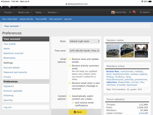

How do you do the disliking? Is that just the angry or sad face?
How do I run the lighter version? I have real trouble seeing the shading differences with quotes and stuff.
Yes to the dislikes and the light version is under preferences in your account.
