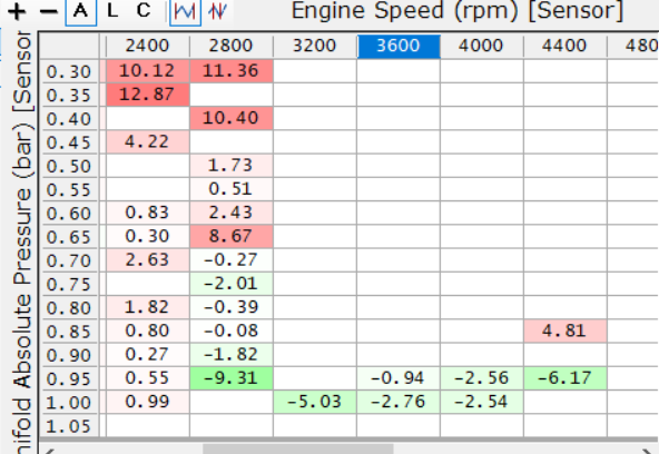

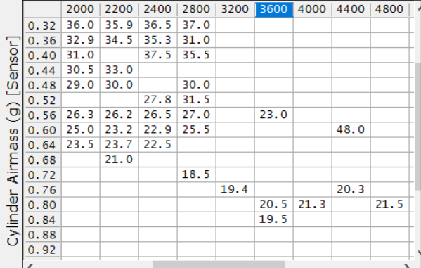

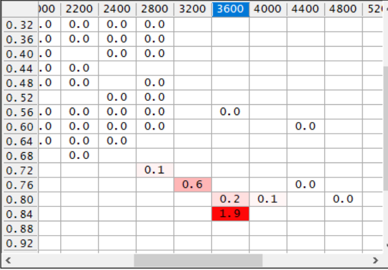

I do also have some KR at such weird kinda low RPM areas, usually pops up between 2,200-3,400rpm despite that being the lowest area in the spark table at about 19* which ain't shit. I have been bumping up the timing 1* at a time in the middle and lower area just to see what it will take.
Heres some snipits showing fuel is good in the area of the KR and that its not making much timing anyway.

I don't feel or hear anything during that KR, it only drinks 93 with no additives. I don't think its going lean or rich it's pretty much always within 2% or better. Truck runs great IMO, smooth acceleration and besides a little bog off the line which is my poor pedal management it never seems down on power or that its misfiring.
Maybe I will pull some plugs tomorrow and see what they look like

Is theres a magic amount of KR that makes an engine explode? Is it extended periods of KR? I feel a basic NA motor should be able to handle a fair amount

if youre not hearing it, feeling it, and not blowing black smoke i wouldnt been too concerned.
i spark knocked the shit out of my few engines while/when learning to tune
data logging most stock tunes show 3-4* of retard pretty regularly

Oh wow 3-4*on a stock tune that sounds terrible lol. It does emit a little black smoke on the shifts but that's about it. I might desensitize a tad and try adding some timing else where. Never more than 1*at a time. Idk how much is considered a lot for a basic engine but I know I have close to 27*in my buddies 408 Denali and it has no KR.
