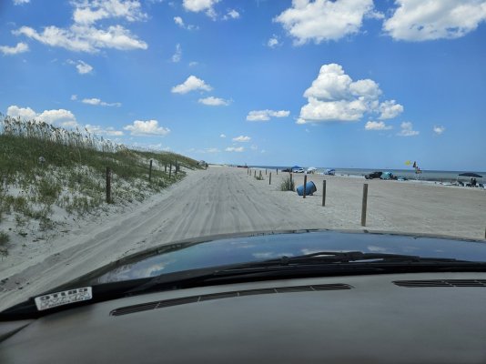

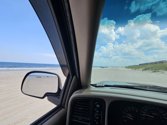

went back to the beach for redemption and put 4wd to use a little bit. put some miles around town on 4wd auto to try and get the gears at least some break in.

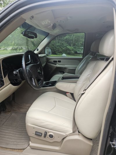

replaced driver bottom seat cover and armrest leather this time with leather from auto seat replacement, the price and quality is better than i expected its great.
i used cheap ebay vinyl before for almost the same price it was trash.
I have new leather for the steering wheel coming
