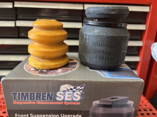

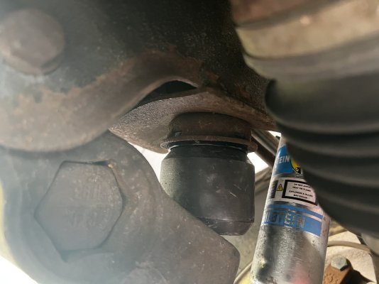

main reason i am considering them is my driver side torsion bar is cranked and suspension sagging on that side. my truck is perfectly level but the difference in torsion bars has the driver side riding on the bump stop. my truck is leveled on keys, was possibly considering dropping the truck down 1" all around
Moderator
16,655
34,475
People's Republic of Colorado
The front jounce stops should contact the lower control arms at ride height. It's not technically a bump stop, it's a fulcrum point for the front suspension.
