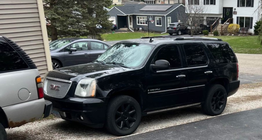

Was tired of making car payments and wanted to save up to get back into racing. Used to have a 392, then an all out hell cat that I put twin turbos on. Life changed, had a kid, moved to a more expensive house. Bought the truck for around $5,000 put about $5,000 in it so far, and will keep chasing down some problems to make it better than stock, but she is well on her way.
Overall, pretty clean truck, had normal maintenance but not "keep it nice" maintenance or upgrades.
As soon as I bought it I drove it for a couple days, really try to see what all i needed to do. Really it wasn't bad, but i didn't want not bad and given the 20 years of playing with cars in my past, I just started tackling things.
At 184,000, a couple weeks after I bought it i went ahead and did the following:

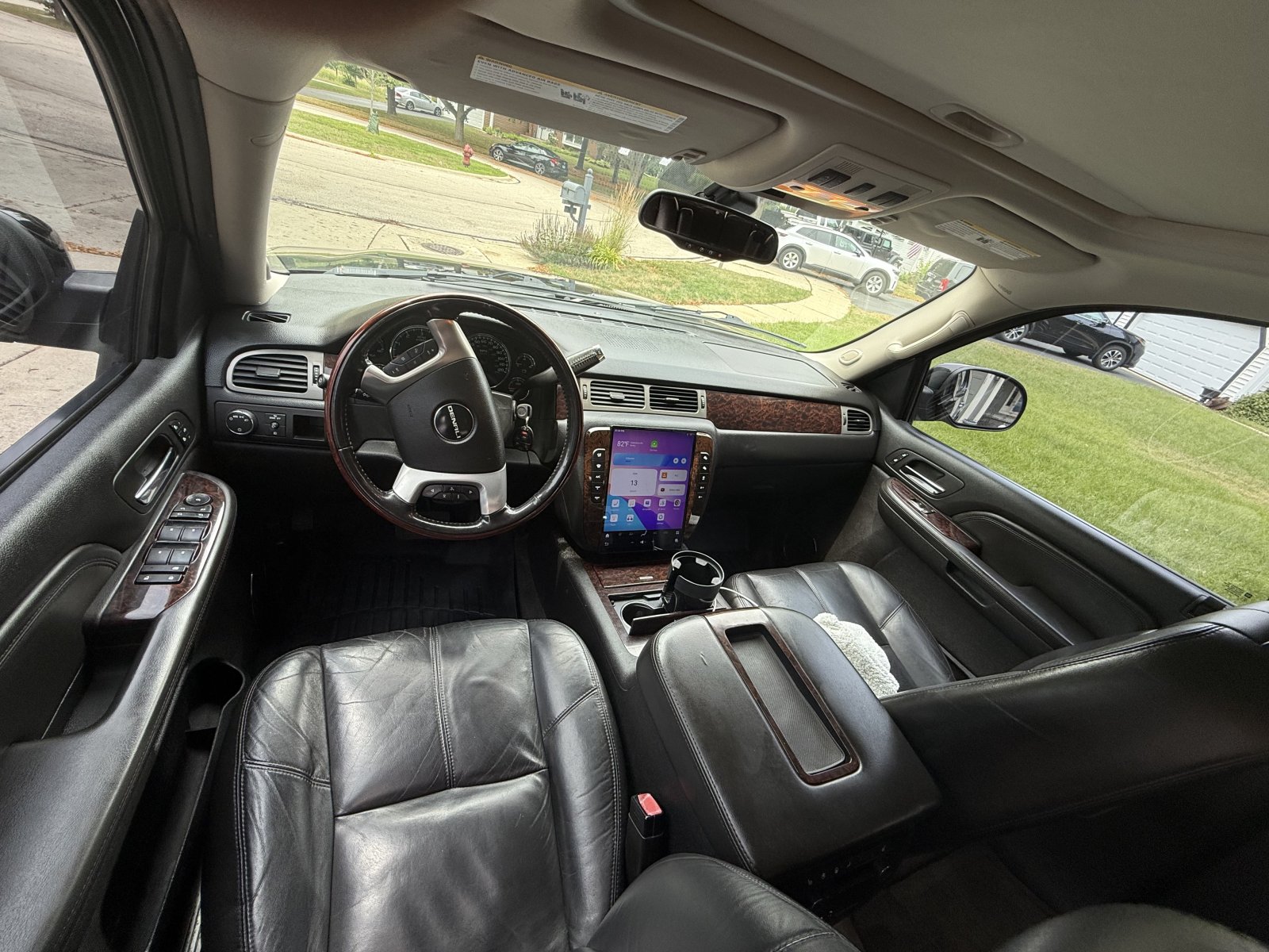

-13.1” provision Tesla style screen

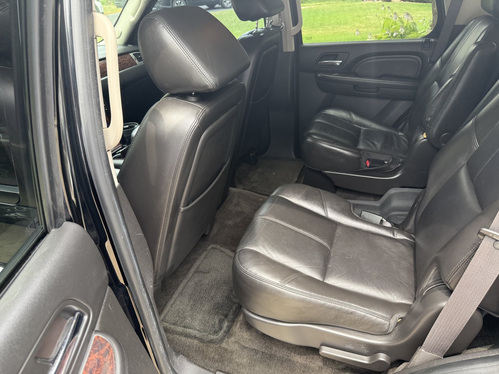

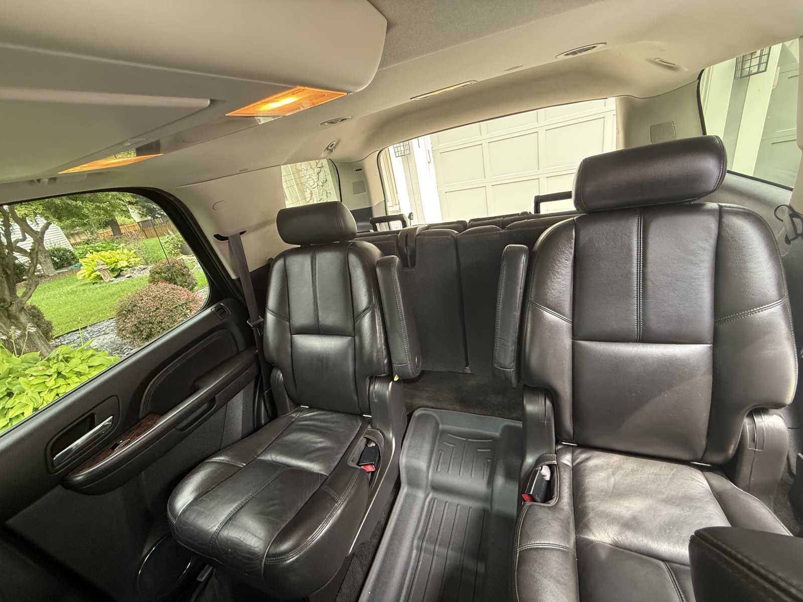

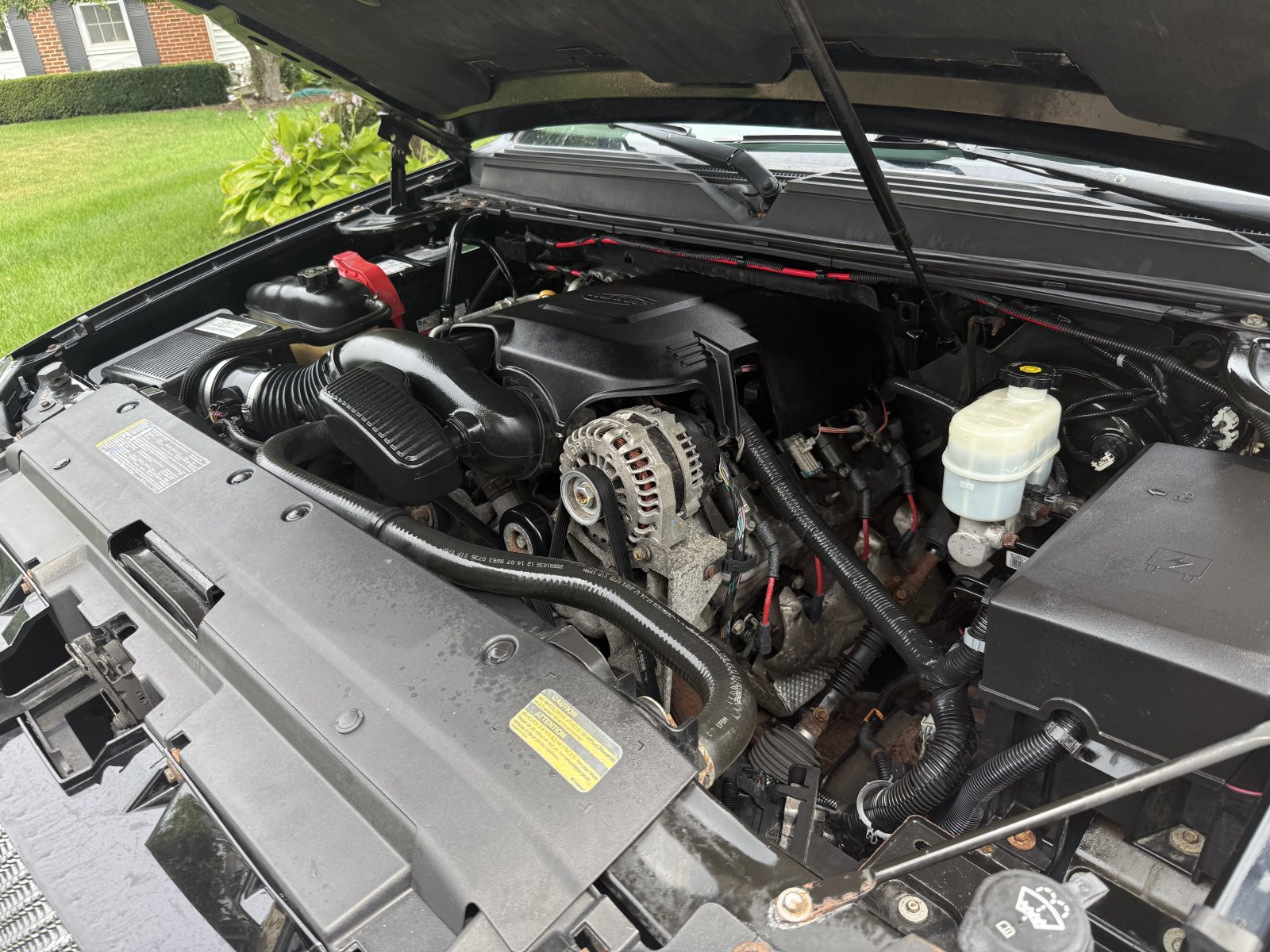

Stole the wheels of my 90 RCSB temporarily to get going and did a full interior exterior detail, headlights, painted the mirror caps, and some of the mechanical work above:

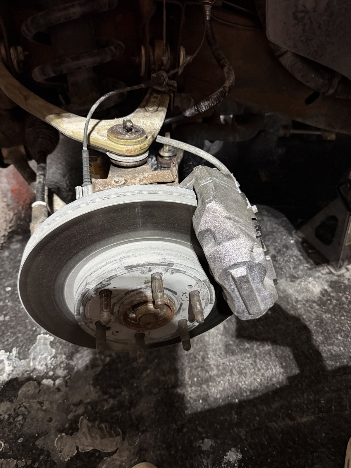

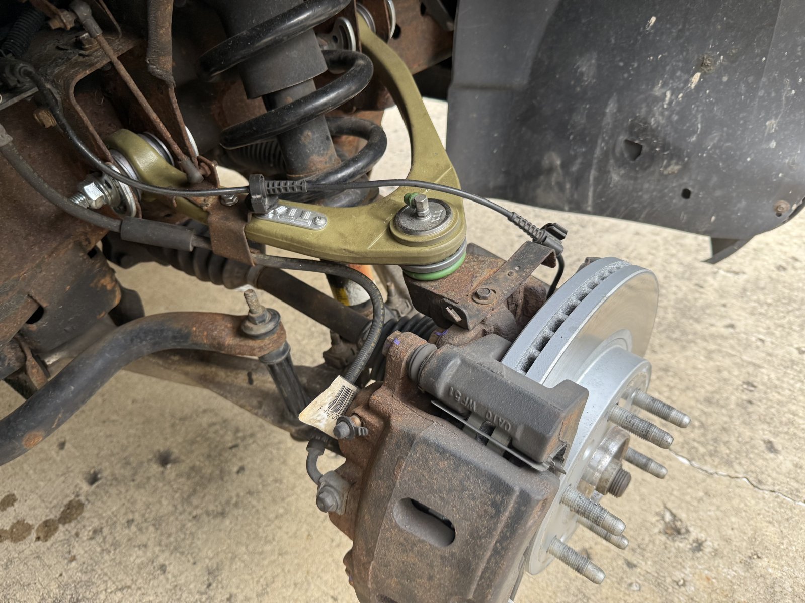

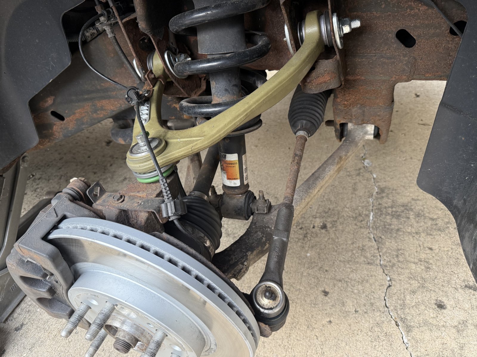

Control Arms and Brakes were needed:

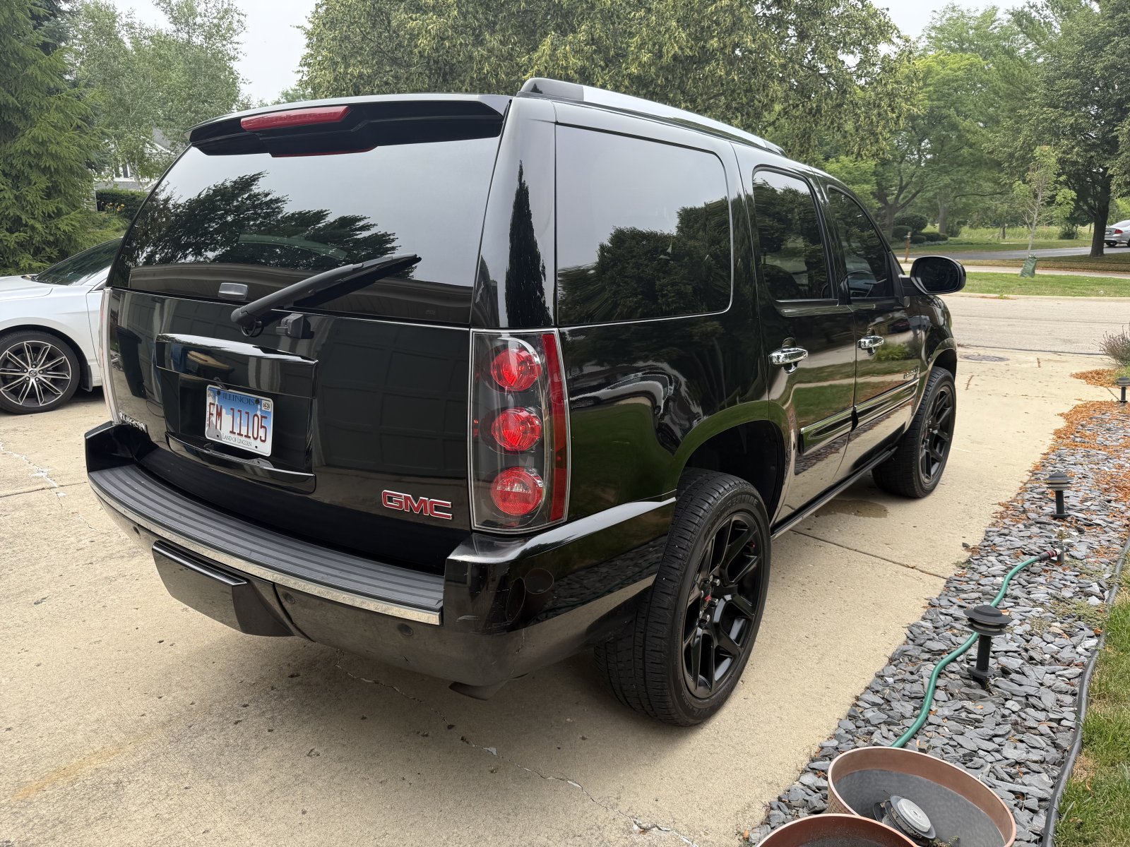

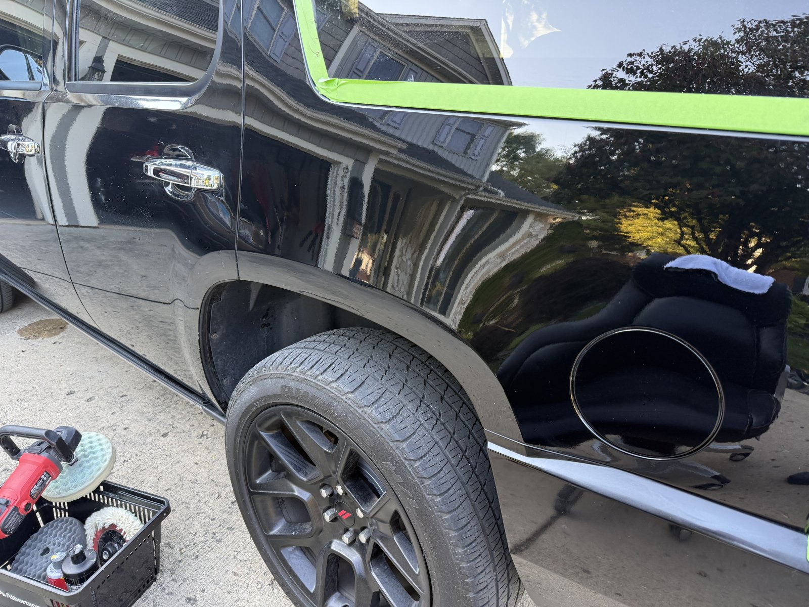

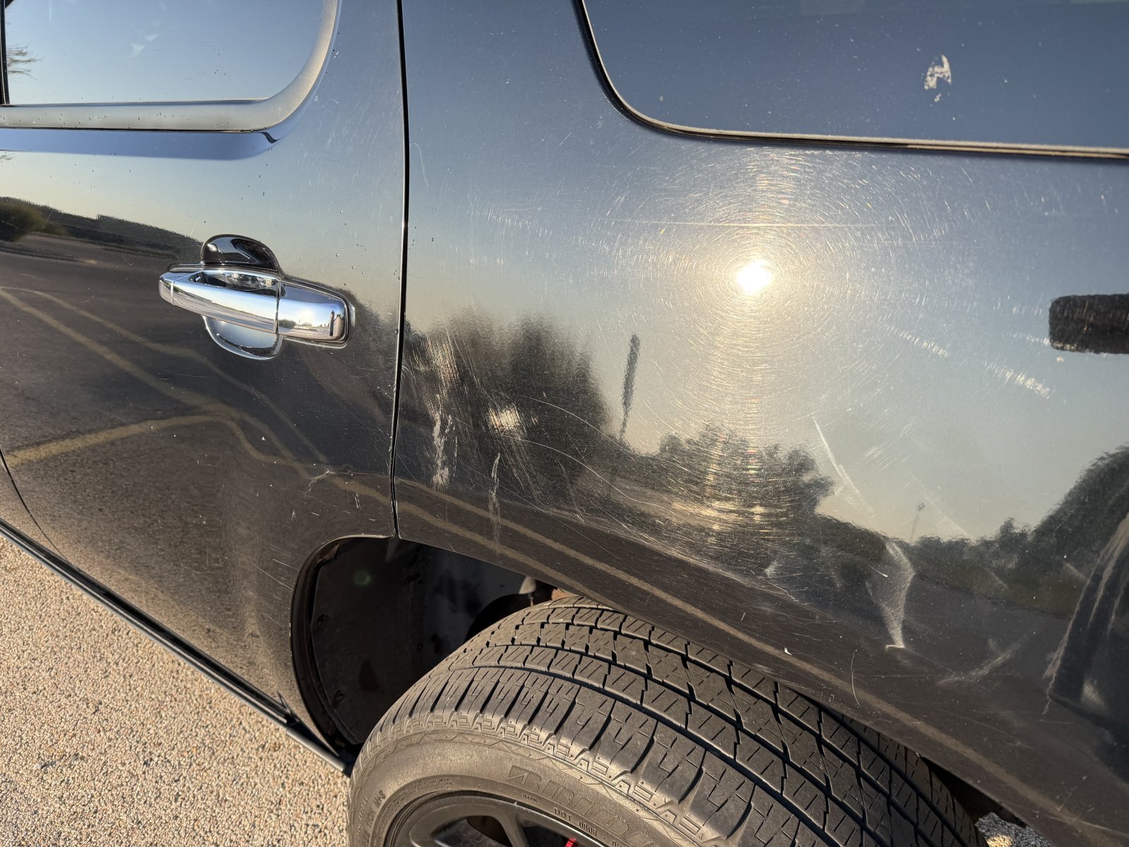

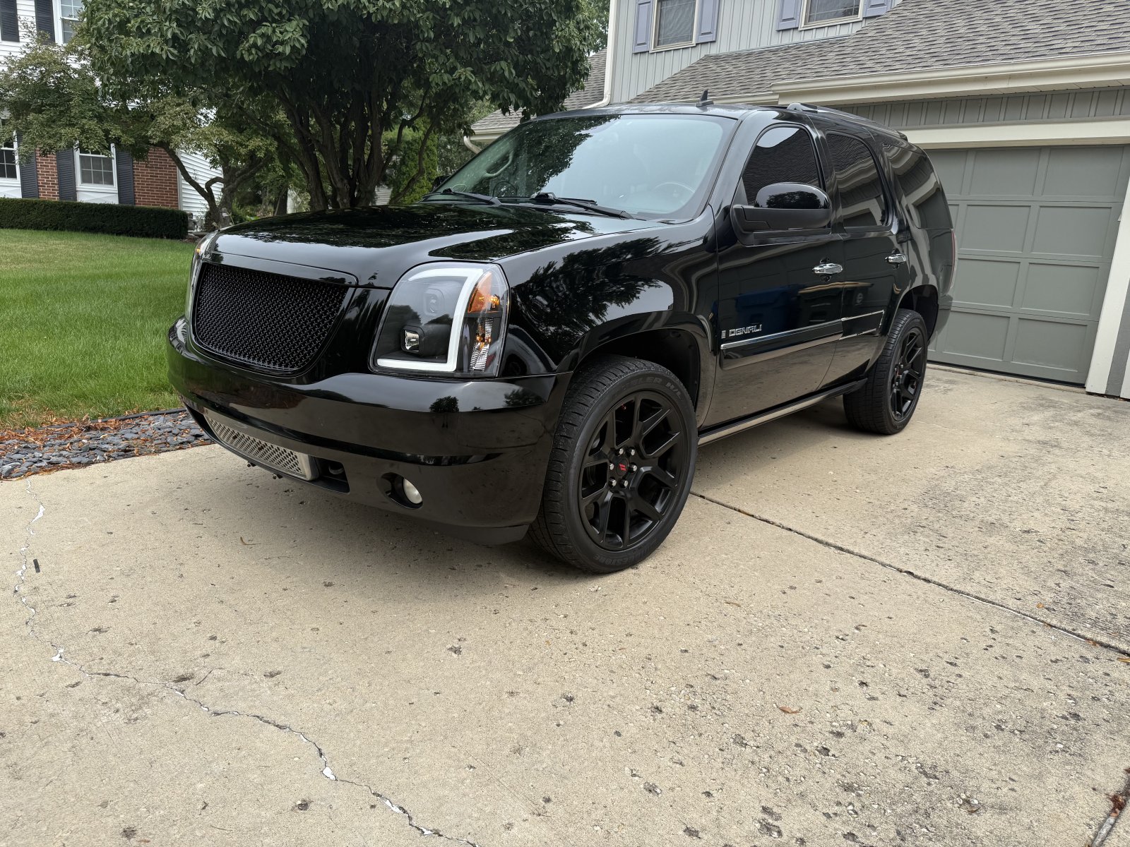

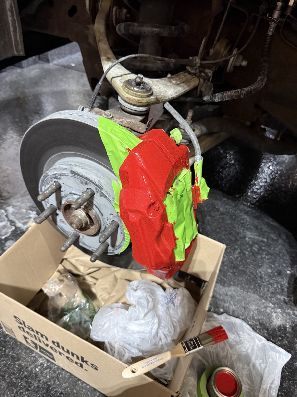

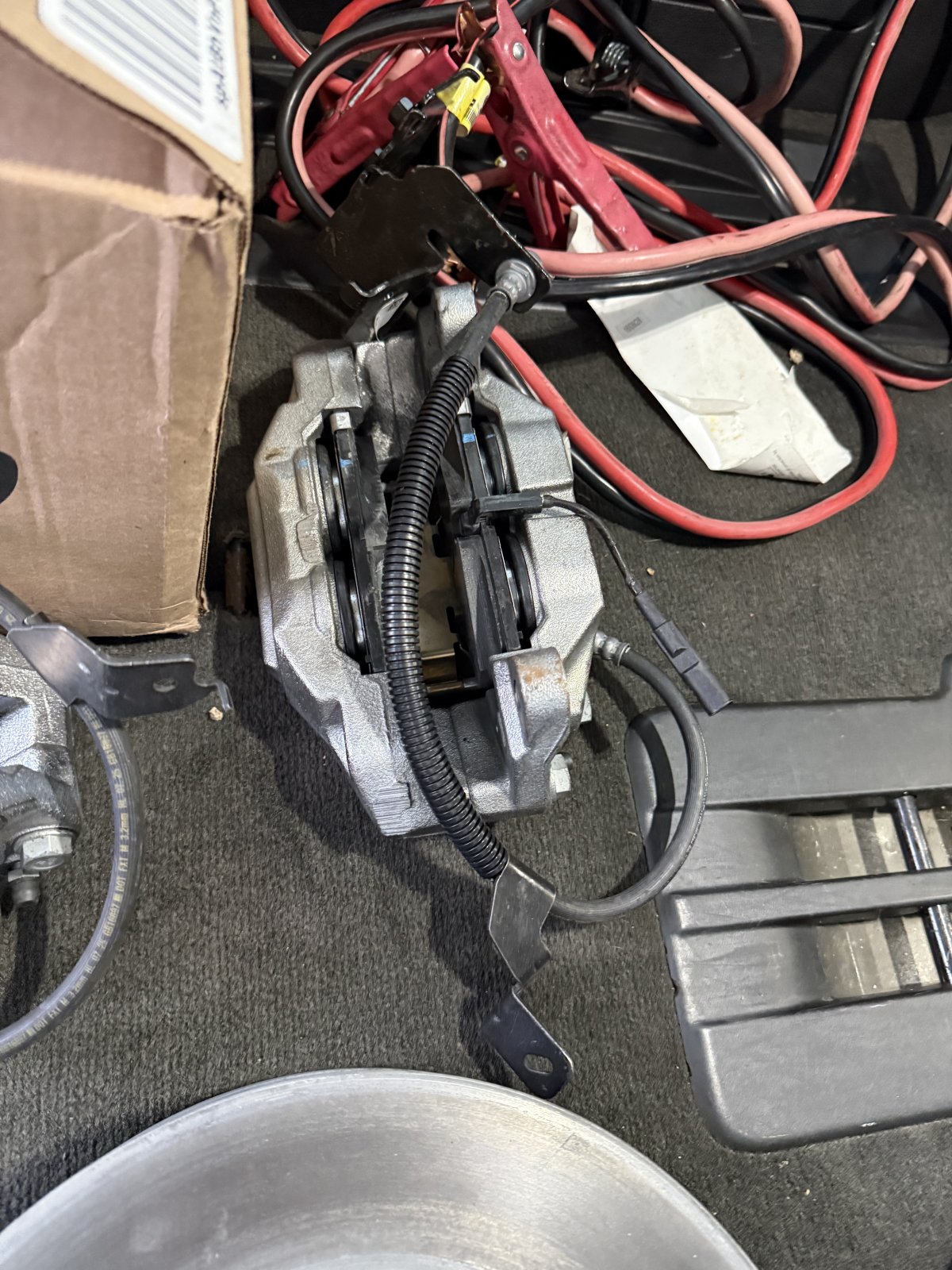

After I got mostly everything working as it should I started trying to clean it up. It does have rust on the passenger front fender (new one body worked sprayed PPG black, just waiting for my bumper to be done in paint to swap over the new parts. Rear hatch same thing, has rust in the corner, have my new one in paint to swap this summer. I also wasn't thrilled with the stopping, so I threw on some 2025 escalade 4 piston fronts. Tried my hand at my first real cut and buff and it turned out great. Removed the moldings and got the ol girl some wheels that she deserved. Threw on an airaid tube and tuned it using HPTuners! Trans tune did wonders, she gets better gas mileage and even feels a bit peppier now.
Now at 190-191k i decided to get it really in line, and were almost there.

Front pad/rotor/caliper 2025 OEM Escalade 4 Piston front upgrade

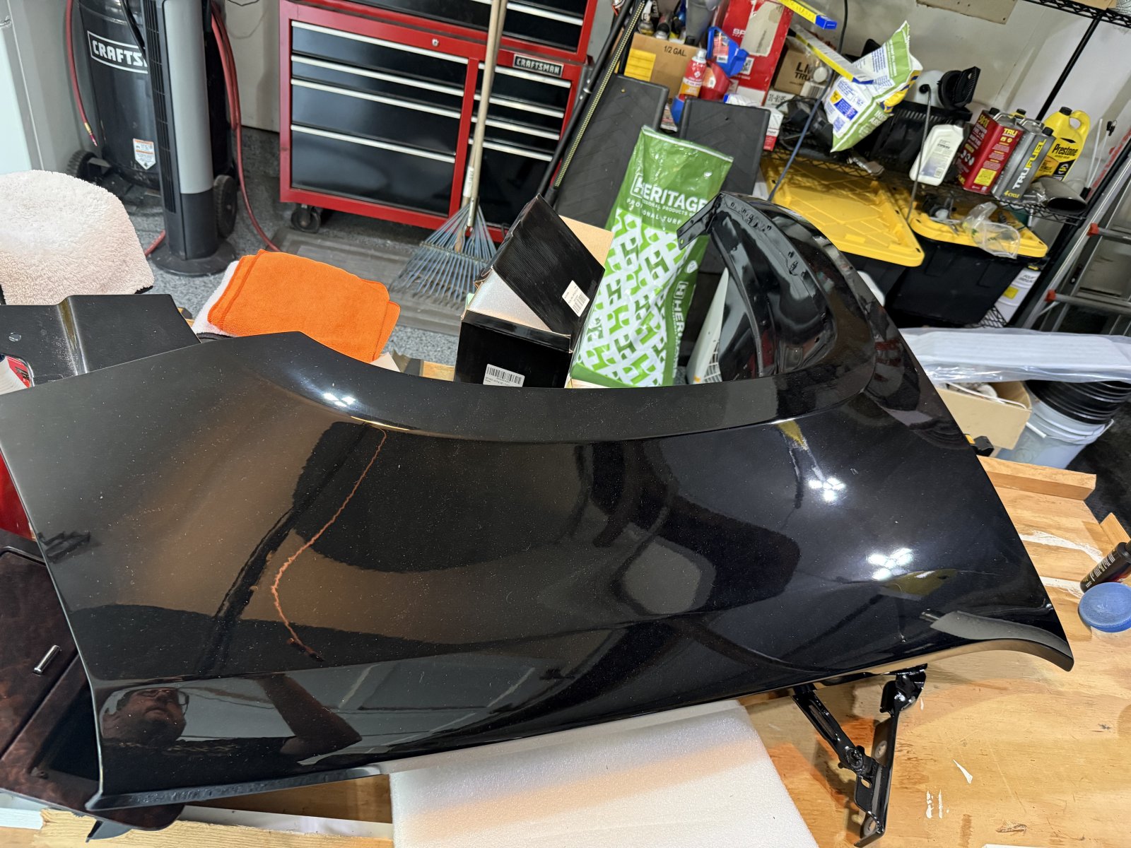

Passenger Front fender new Ppg black and clear ready for when bumper is done

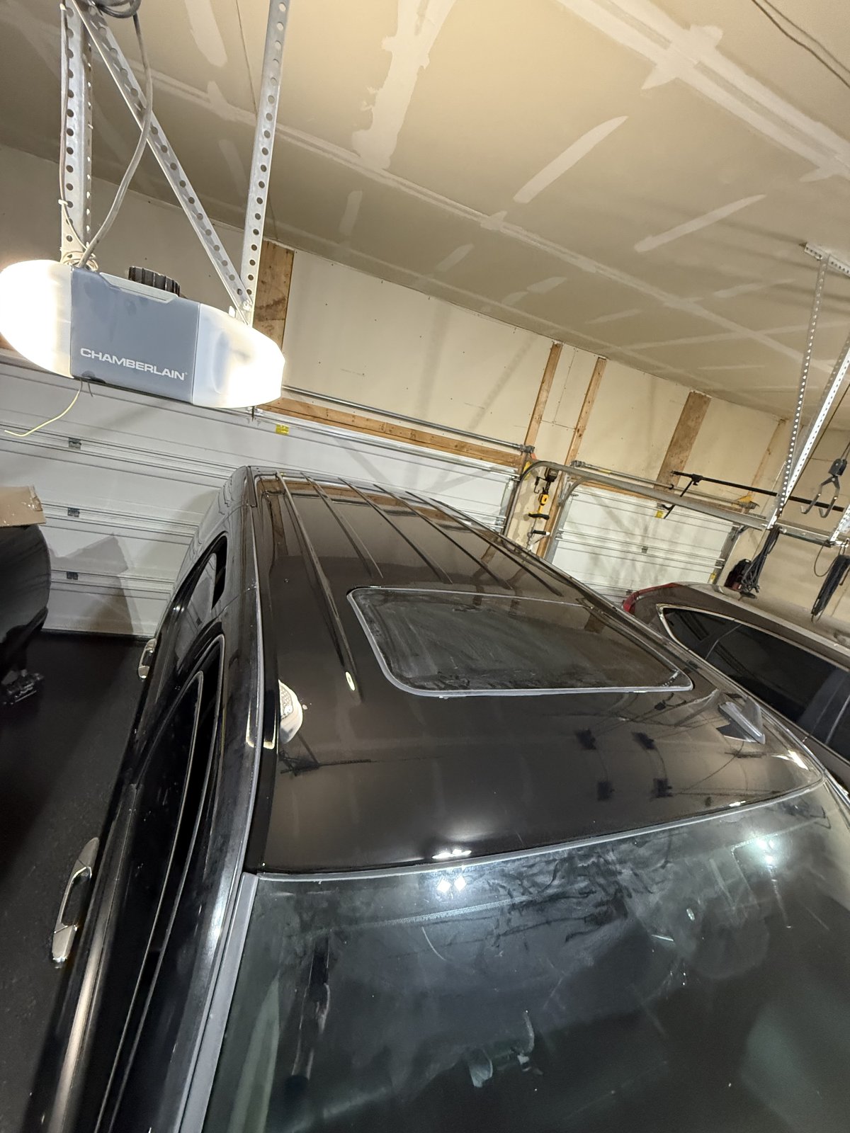

Rear hatch new Ppg black and clear in paint

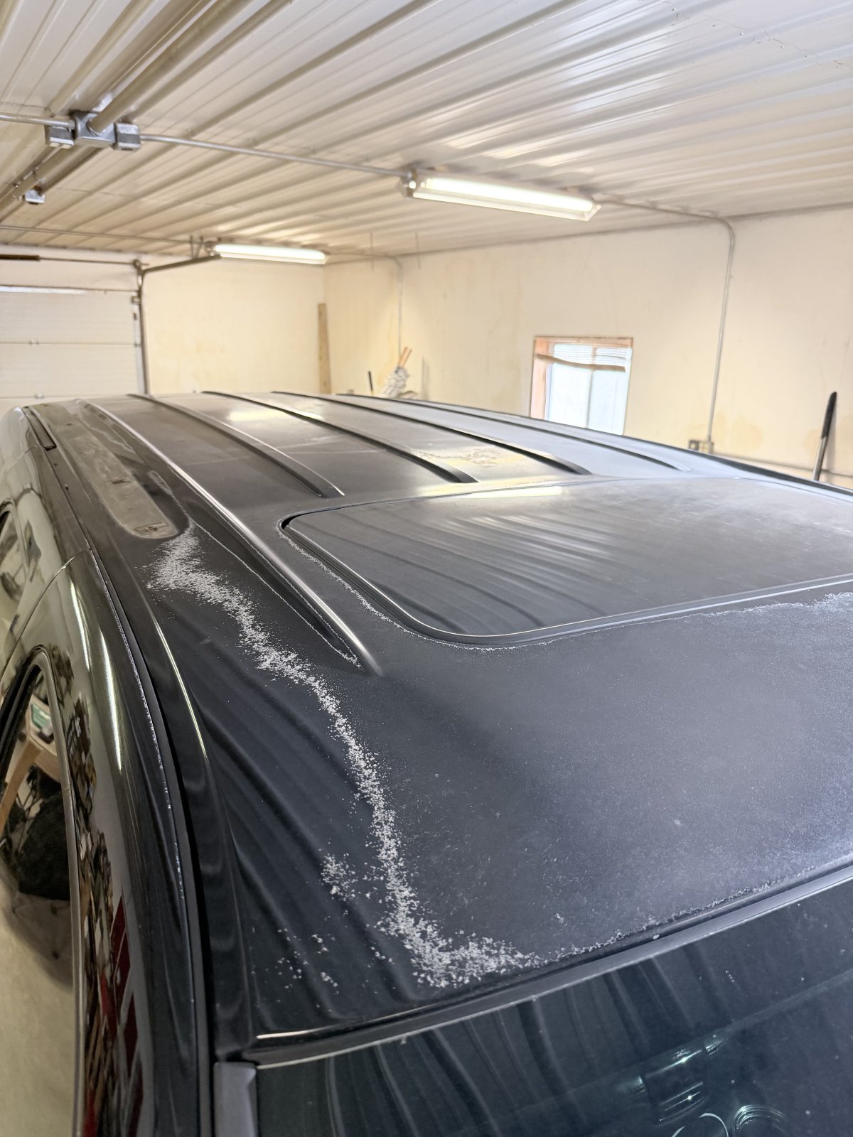

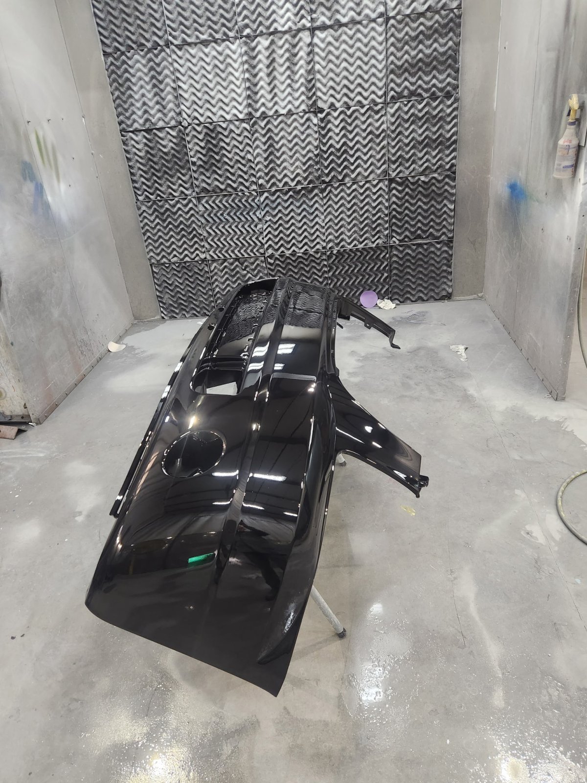

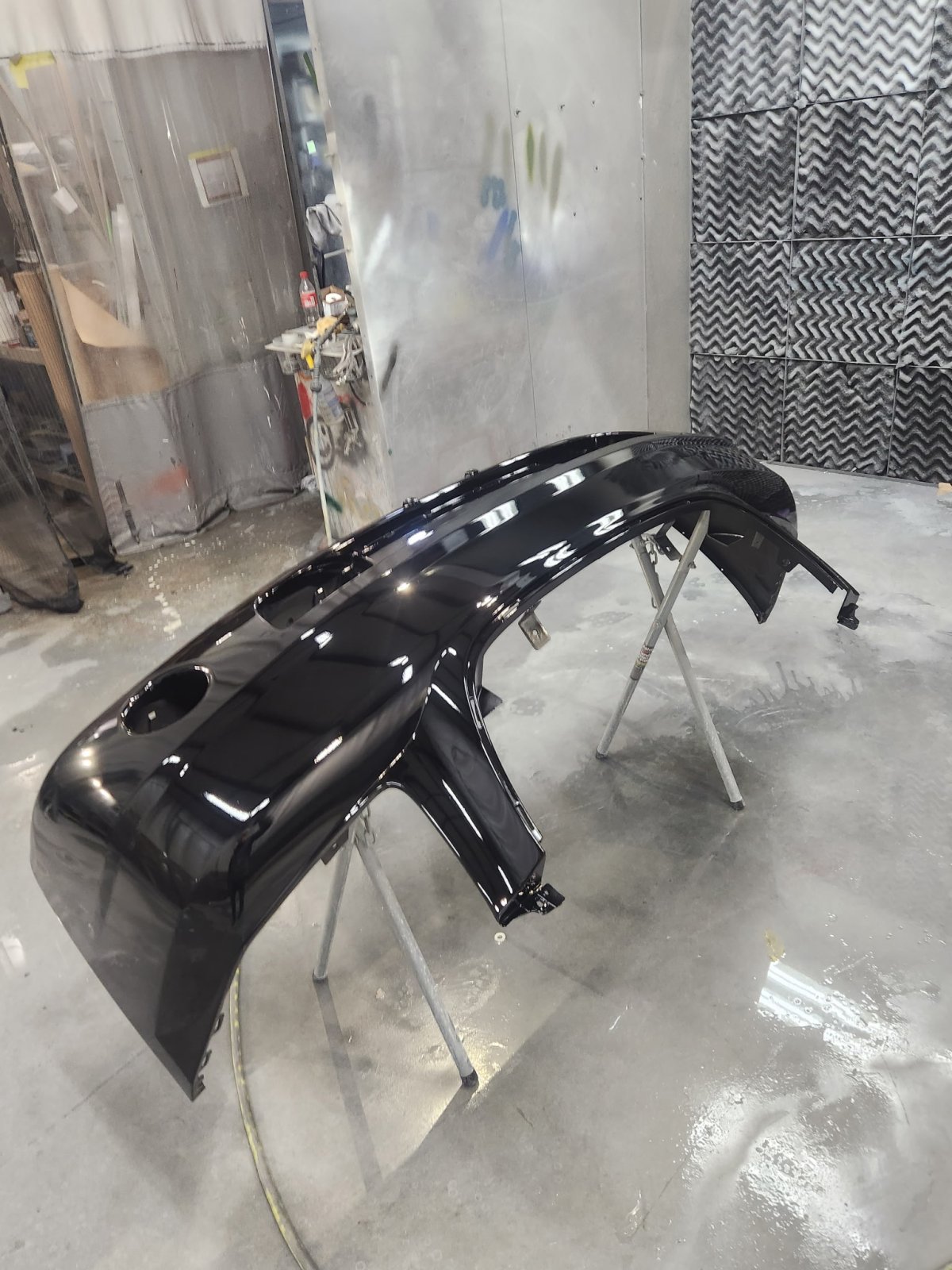

Got the roof repainted with PPG and the bumper finished too. Hoping to get the new fender and bumper on in a couple weeks. New oem fender liners, oem valance, led fogs and black lower grill going on when I do the swap. Really really need an Escalade or Denali rear bumper then we’re getting close! Unfortunate that the tops of a couple doors are roasted but that’ll be a little bit until I paint the whole thing.
