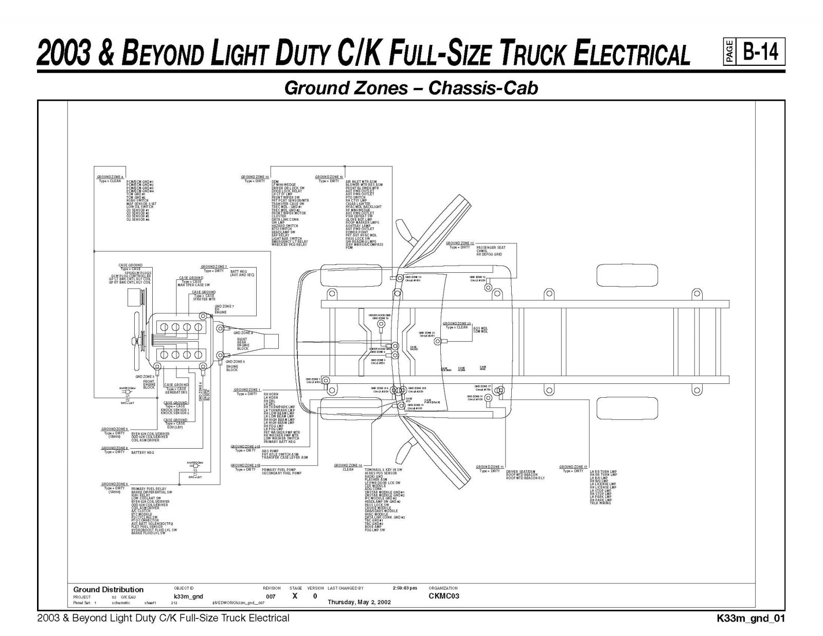

Sorry for your loss.
GM Upfitters site has manuals. I had pulled the 2003 Elecrical info and there is a great Grounding Schematic (picture below). As you will see on the site, bad grounds cause all kinds of gremlins.
Here is the link for 2003 and up electical (2003 and up manual was in 2004 folder)
https://www.gmupfitter.com/files/media/photo/123/2004_LD_CKFullSizeElectrical.pdf
Link to all years
https://www.gmupfitter.com/pdflists/view/6
Enjoy the burban!
