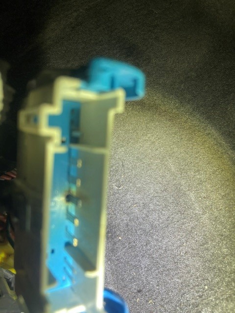

Thank you for your suggestions and links. Turns out this purple wire came out of a black box I think is called the rear auxiliary control module. The feed INTO this module from the front of the vehicle was dead. After several hours of testing, searching, drinking, many frustrating entanglements of my multi-tester probe wires and several temporarily lost tools (girlfriend claims is due to the the drinking, but I am not certain), and what feels like half of my interior disassembled, I traced this to an orange 12v wire in a 22-pin connector that is tucked away behind a kick panel to the left of the parking brake. The pins for this orange wire were burnt. See pic. Somehow this orange wire provides power to the rear auxiliary control module, but apparently is only done so through witchcraft because last night there did not seem to be a logical connection between this wire and the control module. Anyway, that problem is fixed. This evening I will attempt reassembly of the interior and finding the location of those tools. Thanks again for your comments and suggestions.

I'll refer you back to the link I posted earlier, schematic #5 specifically. Over at the far right is circuit #1740. I'm fairly certain the 22 pin connector you found the issue in is C206 and the terminal is A6. That supplies 12 volt power to the auxiliary blower speed control and the rear blower itself. Due to the degradation of the terminals in C206, A6 you were able to see 12 volts at the controller but it would have failed a load test if you had tried to light up say a headlamp bulb or similar. This is why load testing is important instead of just reading for voltage with a test meter.
Connector C206 can be seen here in the link below as item 6 in the first listing.
