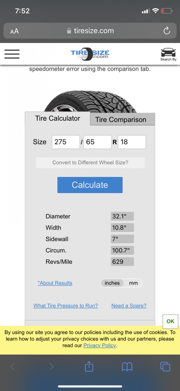

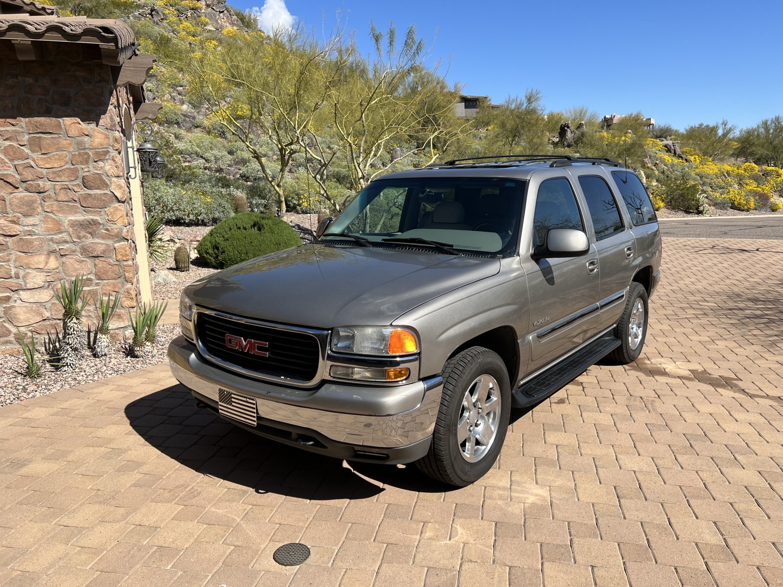

Hey everyone just purchased a 2000 GMC Yukon Denali 4x4 W/89k mi, very clean but in need of a wheel and tire upgrade.
Just purchased a set of 18" GMC Yukon wheels and need advice on tire size, looking at a 275/65/18 all terrain tire - Falken Wildpeak A/T3W.
Anyone have experience/advice with 18" tires on that year I would appreciate your feedback/comments.
Thanks

I'm running 2015 Silverado wheels with 265/65-18s ATs with no issues on my '04. Can't imagine a 275 width would cause any problem.

I have a 2001 xL same suspension geometry- I ran 265 60 r18’s before my wheel spacers and suspension tinkering and they weren’t rubbing before the spacers (I lightly rub my ws washer reservoir at full lock) on basically 30.5’s 32’s wouldn’t be a issue unless you have mad suspension sag
