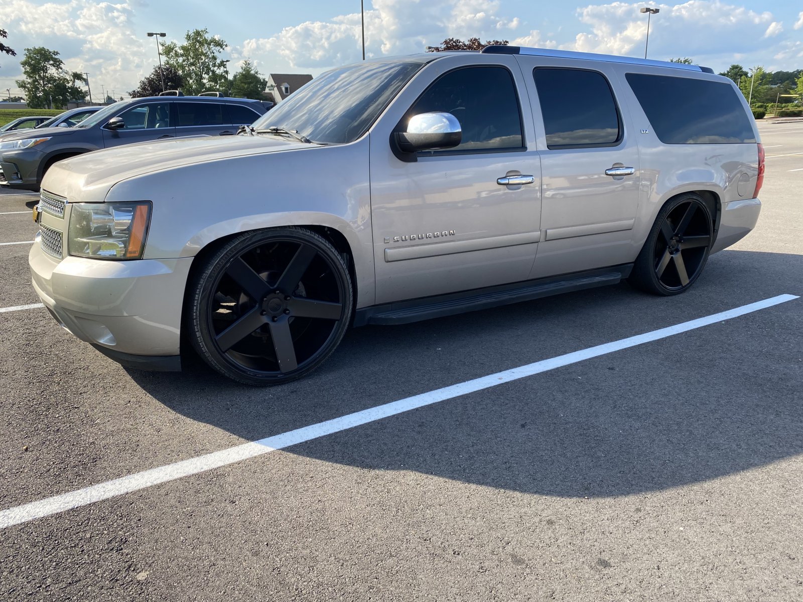

24's on these SUV's and a drop....asking for the exact issues you are having. 24's are going to rub and I would advice to go back to stock...sorry but my .02 cents. My Denali has 22's and thats about the biggest you can get on these SUV...
That’s just false. The size of the wheel has absolutely nothing to do with whether or not the tire will rub. You can have 26’s that have a smaller OD than a factory 22” tire
