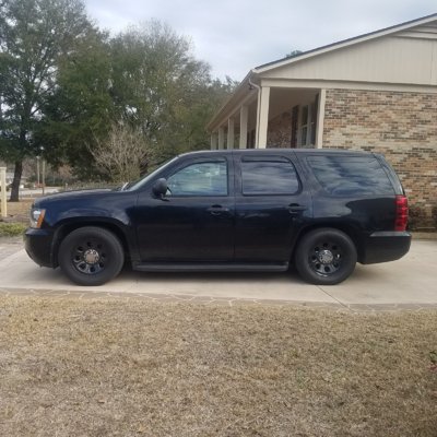

4/6 drop on 24s
295/35/24

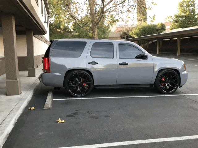

I have the same tire size and I’m looking to drop my hoe I was gonna go 2/4 but want the 4/6 ... the thing I really don’t want to lose is ride quality that’s y I’m thinking 2/4 but how’s the ride on 4/6
I bought it completely stock with 85,*** miles and absolutely hated the ride. Bought the 2/4 kit with swaybar endlinks from Norcalss and it made a huge improvement (stability & handling). I rode that for about 6 months and LOVED it.
I collected the rest of the parts from NorcalSS and went on down. I love the ride even more. It's a smooth ride that handles really well to be a big whole tank. With the factory wheels it rode terrific. On the 24s, it stiffened it up some but definitely worth it!!!
