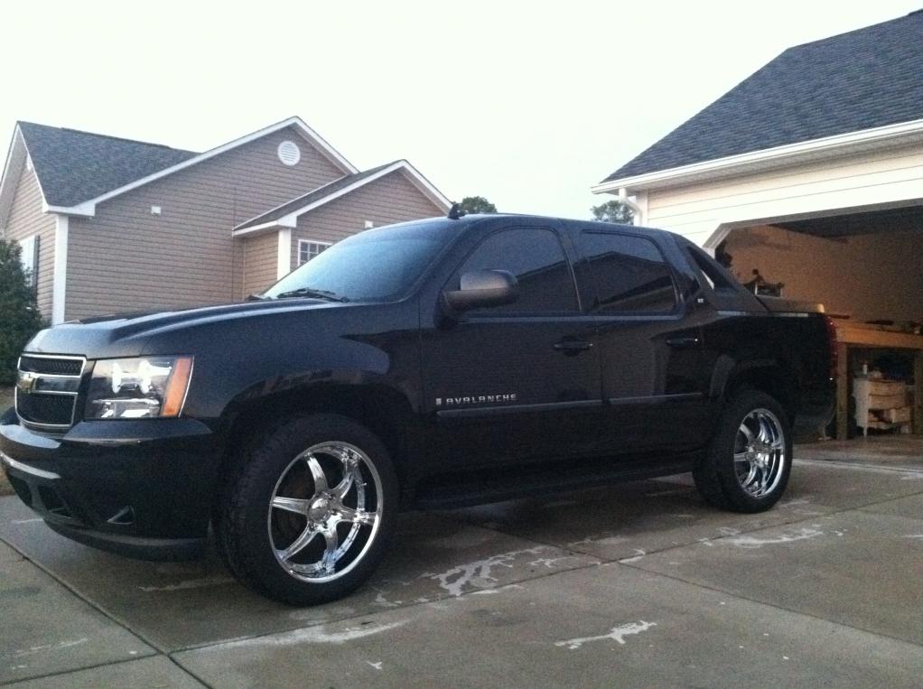

I've been lurking for some time, finally decided to register. I understand this is a Tahoe Yukon forum and I have an 08 Avalanche, but have you seen the choices for Avalanche forums? This place is awesome!!!
So, Tony.....
08 Avalanche without autoride
I have 305/45/22's, want to keep these tires. I would love to squueze the 2/3 kit you have if you think I can just because I assume the 3/5.5 is too much??

Good looking Av, man! :waytogo:
50,933
19,329
You might just PM Tony...
50,933
19,329
:rocking: awesome man!!

Tony, what will I have to do to fit the 305/45's under the 2/4? I am hearing "lots of trimming and move the window washer container"
TRUE???
Anything else?
Tony, as I told you in our text conversation I already have the 23301 springs and shock extenders. Is there anyway to exclude the extenders from your kit since I already have them? The company I bought the 23301's from are willing to take them back with return shipping on me and no restock fee!!!

this is why i put the kit above. Ive seen different avalances use different springs some sit 1 inch ihgher than others. with this kit since its adjustable you can have a 0-2 inch drop in .5 incraments. I would do a 2 inch front drop then go from there.
You're the man--THANKS
What about the shock extensions Tony?
