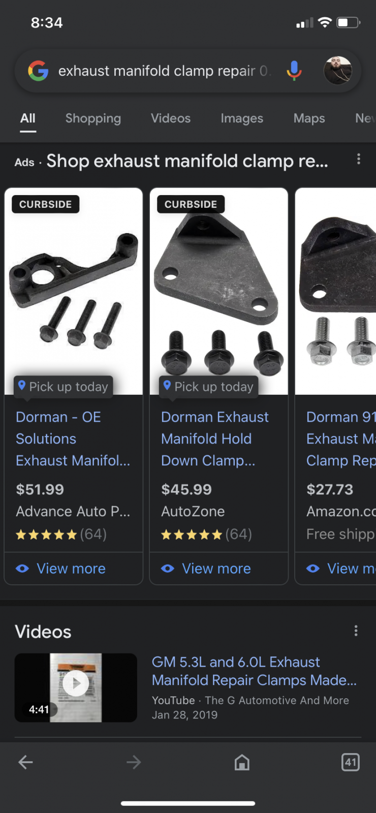

Check your manifold bolts and see if one has broken or is loose.
What is your oil pressure like at start-up? Does it come straight up and level off right away or does it build?
Might put a can of Seafoam in your oil, run it for 50 miles or so and change the oil and filter out with fresh synthetic and see what happens.
I did this and had a few loose ones and 2 broken ones. Replaced the ones I could and used a repair clamp on the broken ones.
