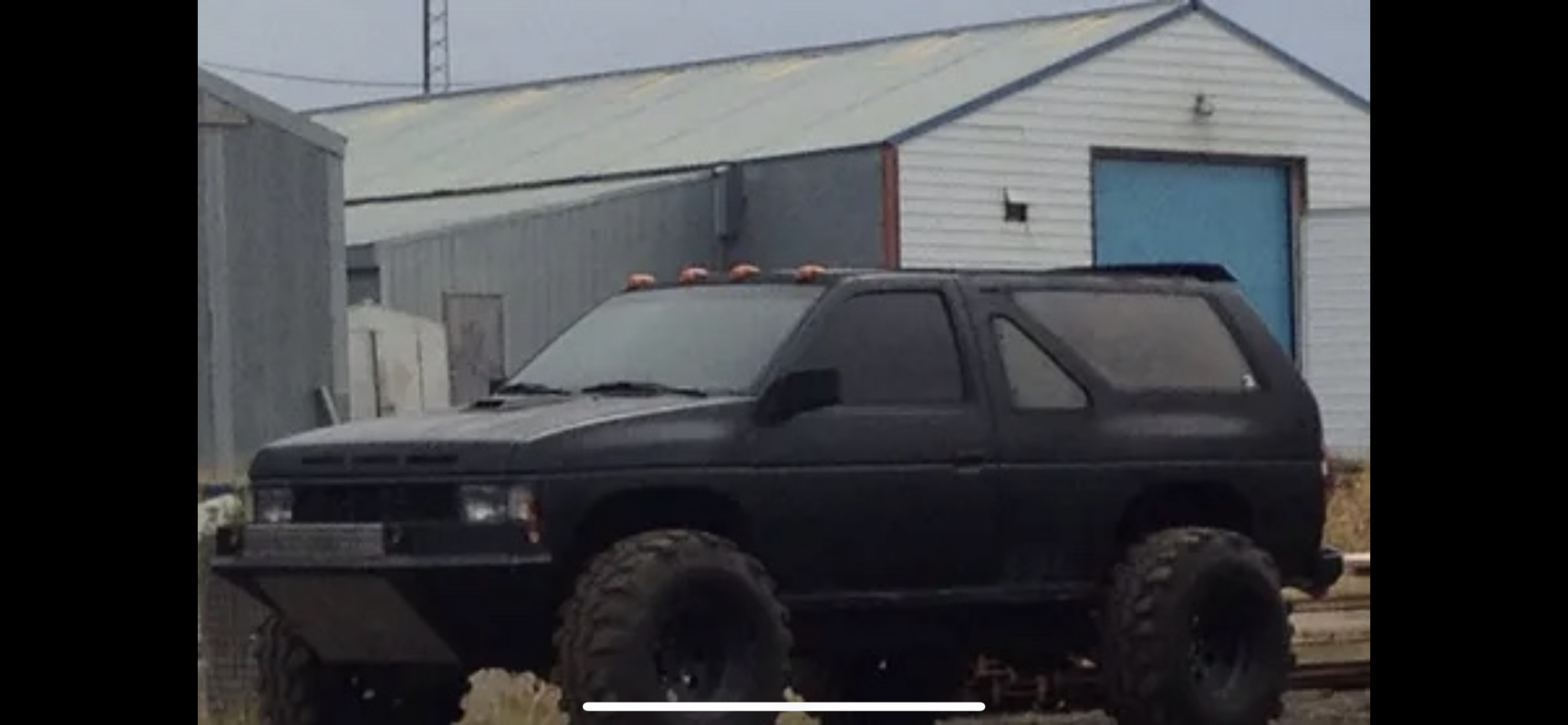

Heres a photo of the ol Rickshaw form back in the day, 87 Pathfinder 35x15.5 TSL’s.
