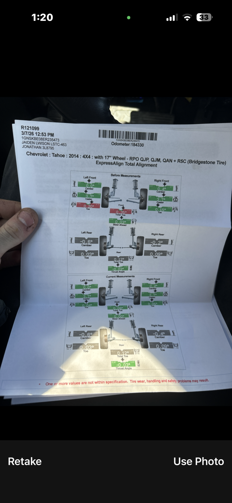

Took it back for alignment today — printout showed barely out of spec (minor toe/caster tweaks). Tech did thrust-angle total alignment, said it’s good. But… still drifting slowly right when I let go of the wheel on flat roads like Sixth Ave SE in Aberdeen (no crown). Not bad, but noticeable — feels like same pull or maybe a hair more now.

Your camber being the same on both sides could be doing this. Most alignment settings for our trucks have more caster on the right than the left, depending on the type of tire used. The trucks with 20" Goodyear tires run 3.10 degrees of caster on both sides. There are guys on here who have forgotten more about alignments than I'll ever know. @91RS

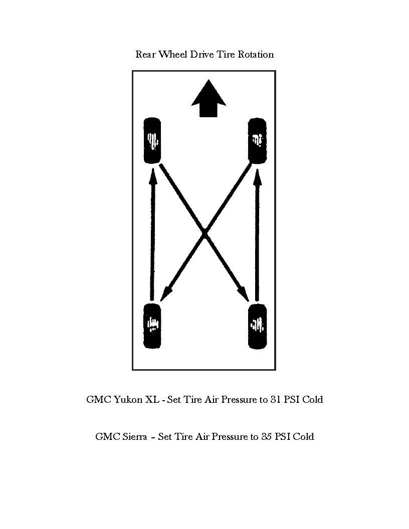

If you don't normally do a RWD tire rotation then it could be a slight tire pull.
This is how mine are maintained with each oil change, every 4-5K miles or so.

Printout had caster dead even at 3.7° both sides — maybe that’s part of it like @swathdiver said (no right-side bias to fight crown). Thrust angle was -0.03° to -0.05° — tech said good, but pull/drift right still there slowly hands-off on flat roads. Or what is flat to me anyways.
Could be the tires I guess I haven’t tried swapping the front ones.Brakes spin even/light drag both sides — ruled that pit.
Thinking go back under 30-day warranty and ask them to re-check thrust and see if they can add a touch more right caster if adjustable. Or second opinion at another shop.
