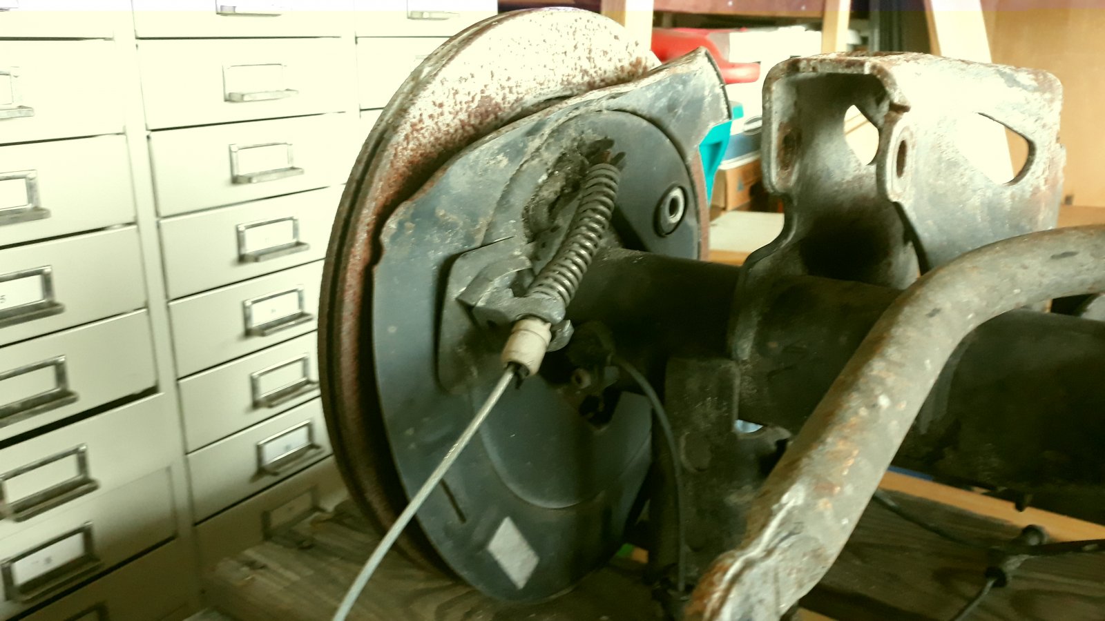

Don't know for sure. My axles have raised bosses for the sensor to screw into and internally, the axle tube diameter is stepped to seat the reluctor wheels.
See the white bushing for the parking brake cable? Just to the right and behind is the wheel speed sensor and screw securing it to the axle. The wire is dropping off to the right. In this view the axle is upside down and we're looking at the driver's side.
