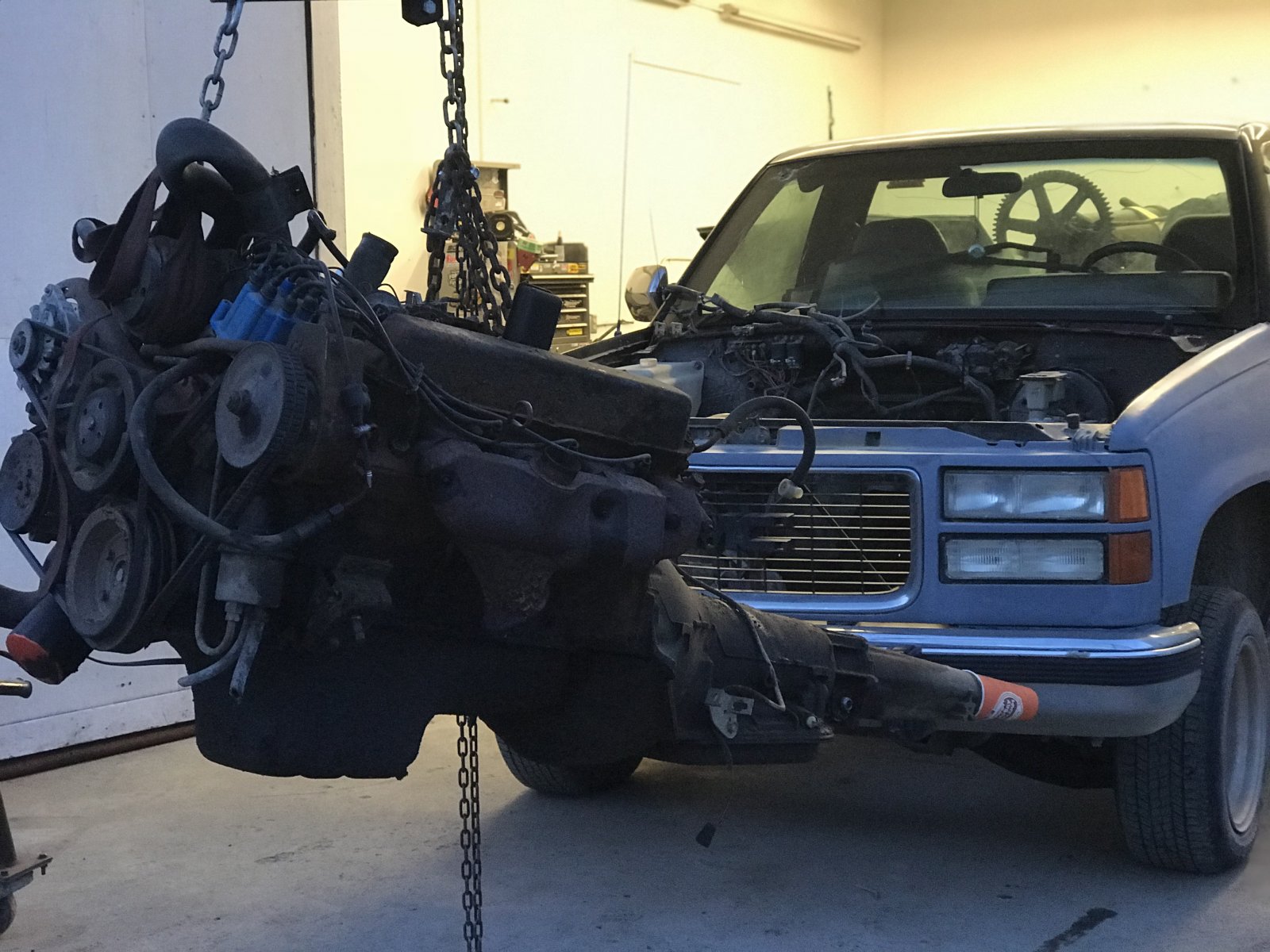

Photo for context, the low mile hookerbeat 3500 is the potential donor for my sweet Tahoe. Then make the Tahoe gang-bang low on her 24’s ‍:anitoof:
