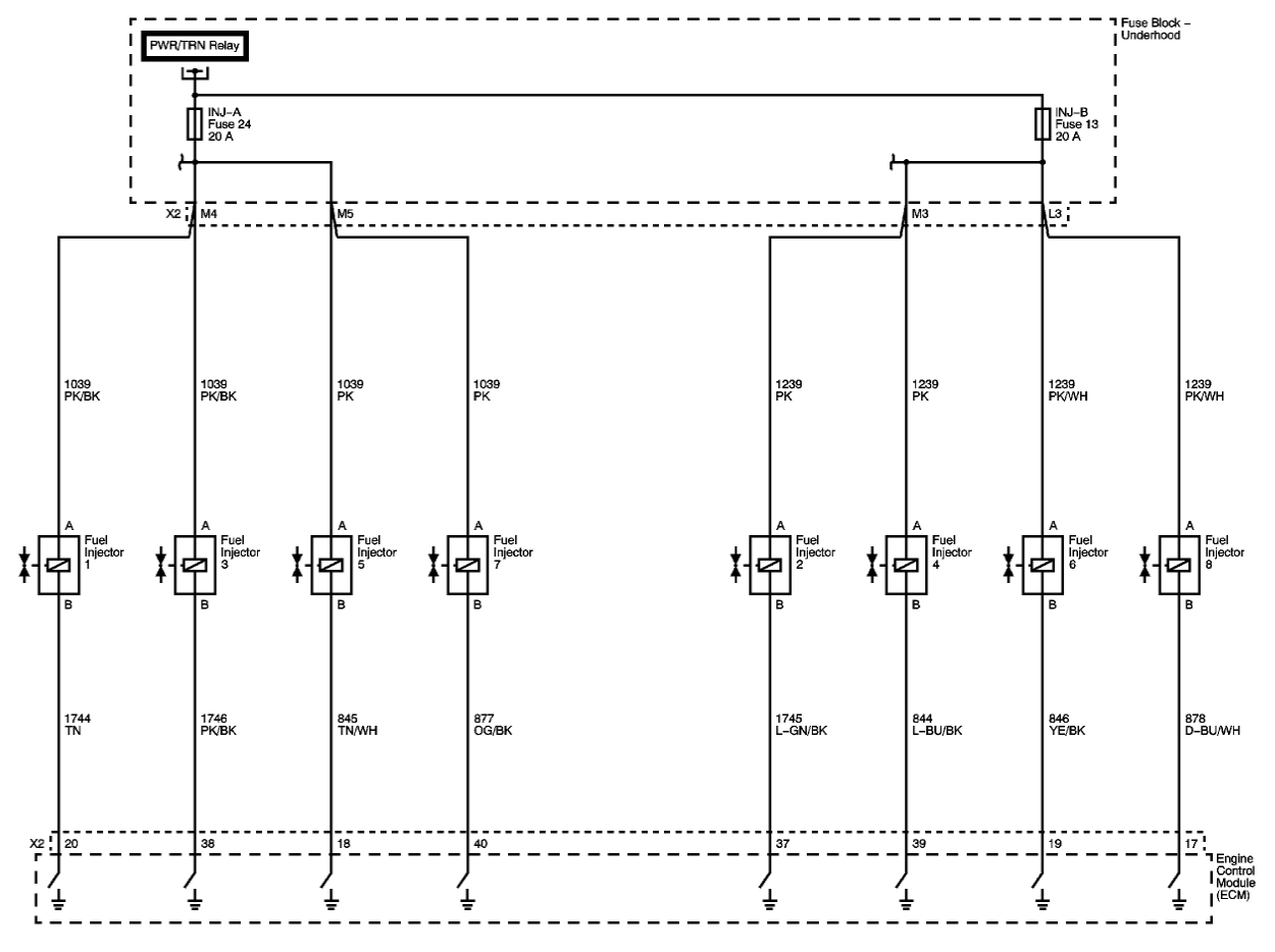

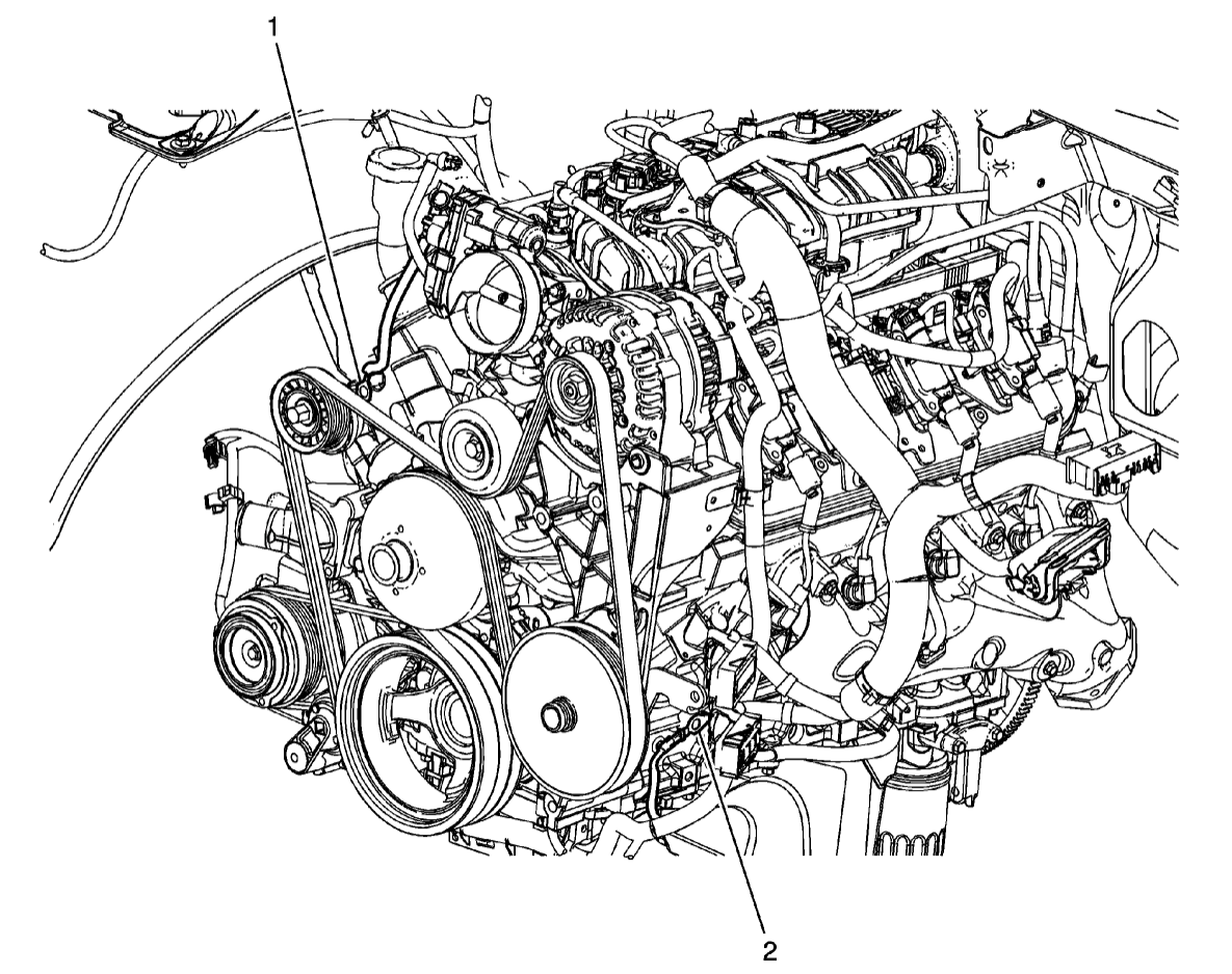

Best I've found is to subscribe to alldatadiy. Here are the ground points for the engine harness. I believe the ECU will ground the injectors through either #1 or #2, depending on the side of the engine. Note that I have also updated my post above with more details.

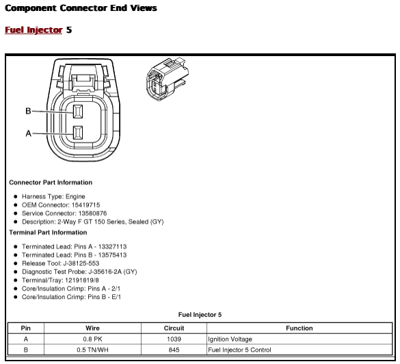

Something to keep in mind: It's worth tracing the wires for the non-firing injectors back to the ECU - in particular the pulse signal wire. Each injector has two wires - one for the coil voltage and the other for the pulse signal from the ECU. The wiring diagrams above show what these are. You may find a damaged pin either at the injectors or the next connector upstream, or back at the ECU. My bet would be at the injectors or the next upstream connector, unless you removed the big bulk connectors at the ECU to complete the DoD delete work for some reason.

this feels like the thing to do, especially since you've tried different ecm's.
back probe the switched ground from the ecm to injector at the ecm plug itself. something like this to not damage the wires, pins or seals.
I think you'll find you have it there but not at the injectors, meaning harness issues. if you don't have a switched ground at the ecm injector pin with multiple different test ecm's, that's whole difference level of broken that's byond me lol
