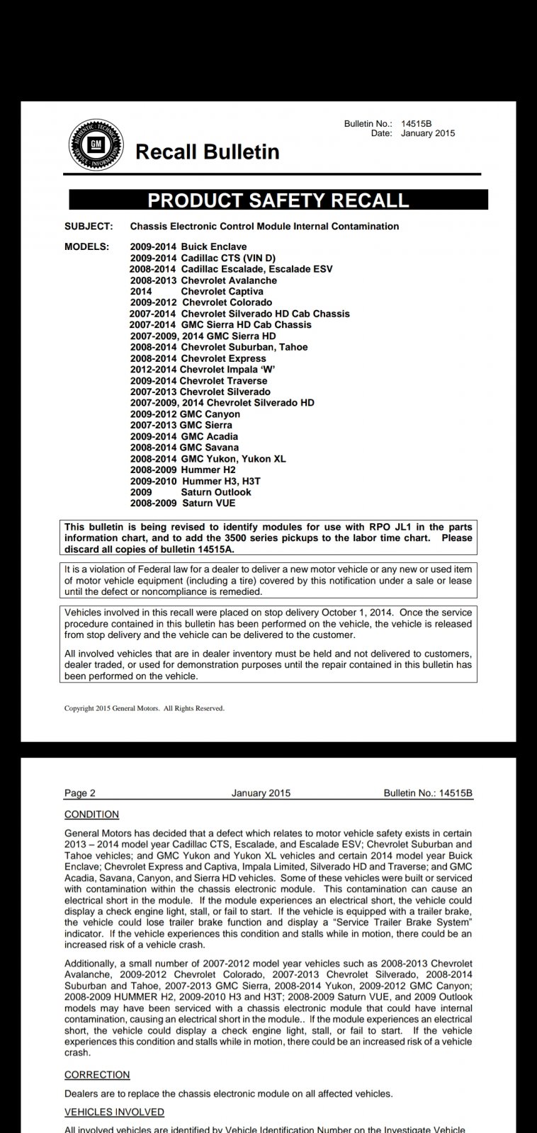

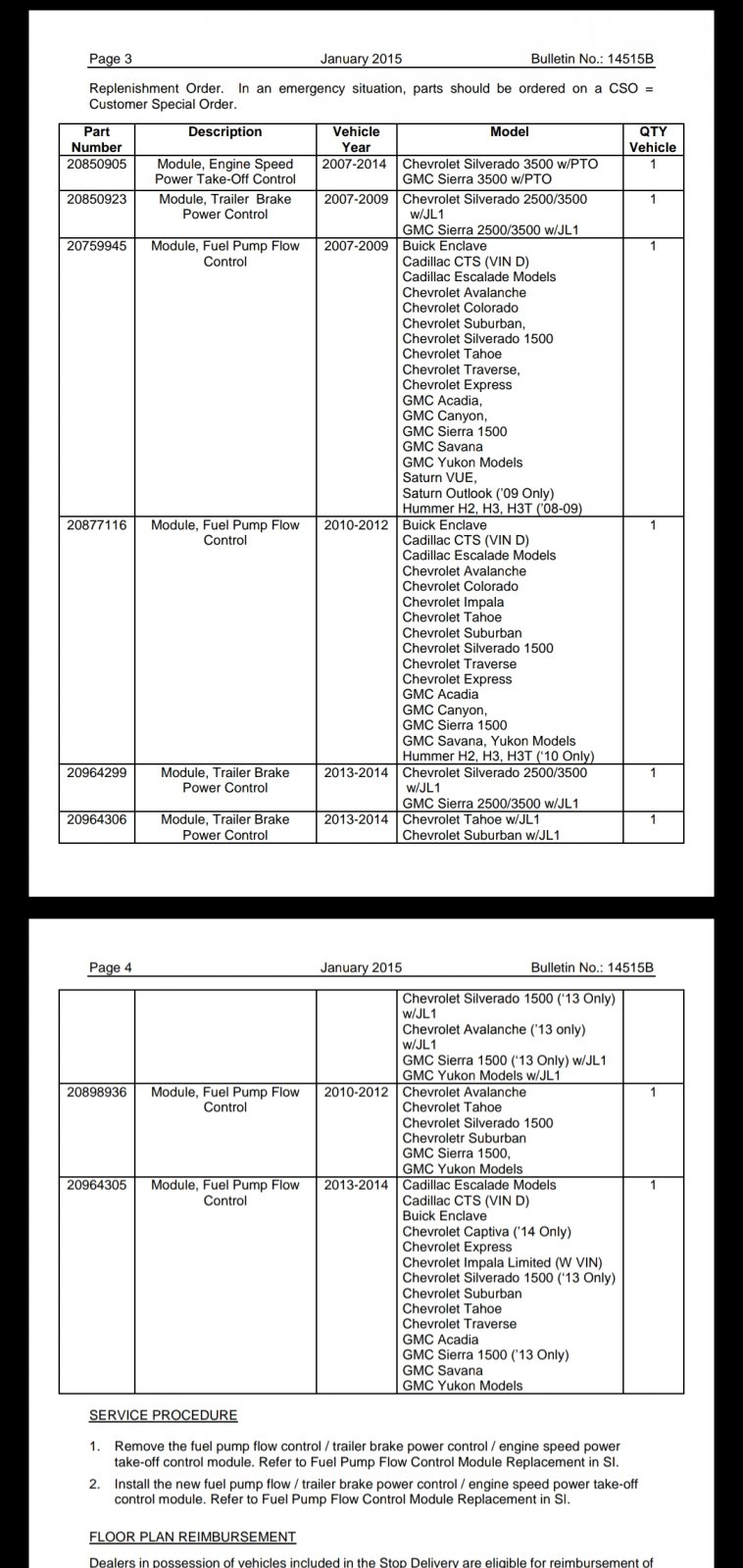

May want to look into the fuel pump contro
l module. There is also a recall on them. May want to look into it.

Thanks guys.. this is our primary vehicle, been paid off for a couple years now. And we live about 20 miles from the nearest dealer.. or person with a tech2 that I know of. Anyway so hypothetical situation here. Say a person was replacing a fuel pump right? And the main pump connector broke so they ordered a replacement from Delphi. The wire colors did not match so the person might have had the first few attempts at running it with groups to the sensor, hot to maybe another sensor… sensor ref wire to a hot, you get the idea. Could this person had of maybe burnt something in this control module by chance?
But, more importantly how would this module stop fuel from reaching the engine?
Lastly, there are no codes being thrown presently.
