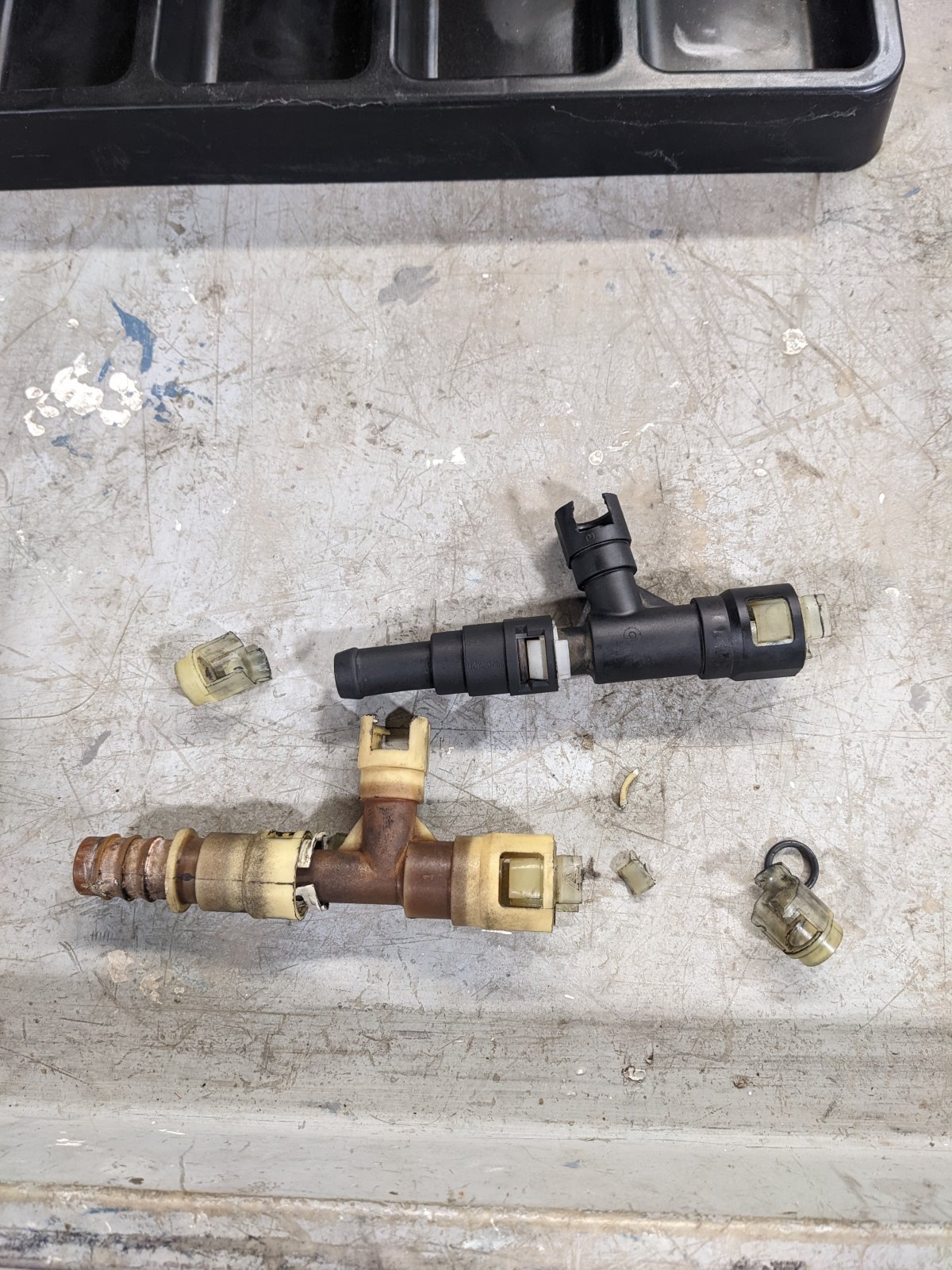

have you changed your 2 heater hose plastic T fittings in that area yet? They originals are 100% prone to leak/fail and then the engine overheats. Ask many of us here on the forum how we know.

It looks like you are right. Based on the location it's the only thing that makes sense. The liquid on top of the coils did have a more wet/slimey look to it rather than an oil sheen. And the smoke it was making was white, not blue. So coolant onto the manifold makes even more sense. Thank you for the tip. The hoses/connectors have definitely been rigged up before as the metal crimp is gone and the hose was shortened.
I just pulled off both T connectors and am going to replace them as well as both of the hoses today. We have 10"+ of snow coming in early this week so looks like I'll need to use the Dorman connectors as that's all I can get today.

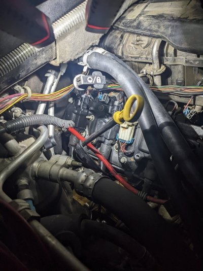

Well it's back again. It's definitely oil on TOP of the rear 2 coils on the passenger side. Where on earth would oil be coming from in that area to get oil on top of those coils?

Definitely oil unfortunately. I think my valve cover might not be sealed properly. The oil has a spray/spotty looking pattern, so maybe its seeping at the valve cover between Cyl 4 & 6, and then it gets sprayed rearwards with the wind. There is more oil down on the spark plug wires for the rear 2 cylinders too.
I drove the car around town (30mph~) for a while yesterday and everything was fine. It wasn't until I drove about 50 miles down the 80mph interstate that I noticed the oil on the coils, so I think it's getting sprayed back in the wind.
I'm just gonna pull that valve cover off again and double check my work. Need to rule that out first before chasing it more.

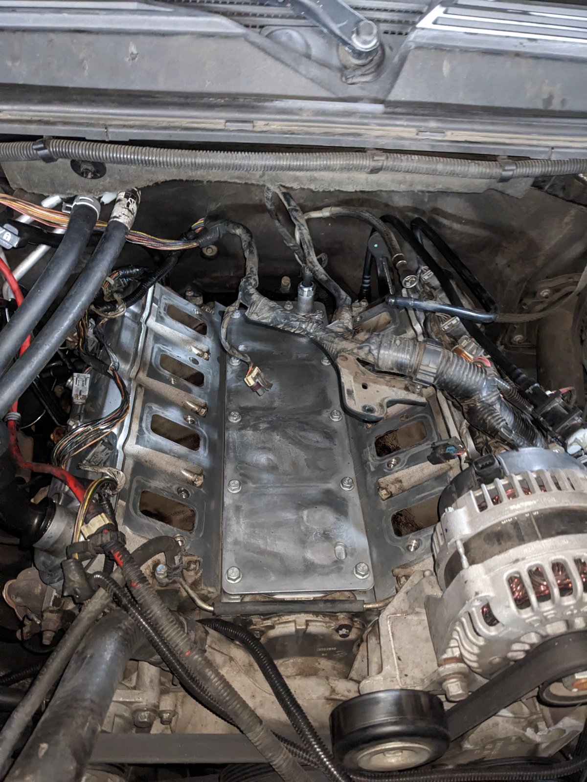

Pretty sure at this point its the valley pan gasket. The oil is not smoking off the exhaust manifold after all, its dripping onto the cat and appears to be getting onto the top of the valve cover through the intake manifold. Going to pull the intake manifold off and do the valley cover gasket, intake manifold gaskets, and throw in a new cam position sensor and oil pressure sensor while I'm back there. Anything else I should throw at it while I have the manifold off?
Foggy
Jul 25, 2019
1,406
1,924
KS
Just an idea: it may be transmission fluid coming out of your dipstick tube.....
Check and see if it's trans fluid instead of oil
If you are having a trans issue OR the trans housing vent is plugged, you certainly
could be getting some ATF mist/spray getting past the dipstick tube rubber sealy thingy

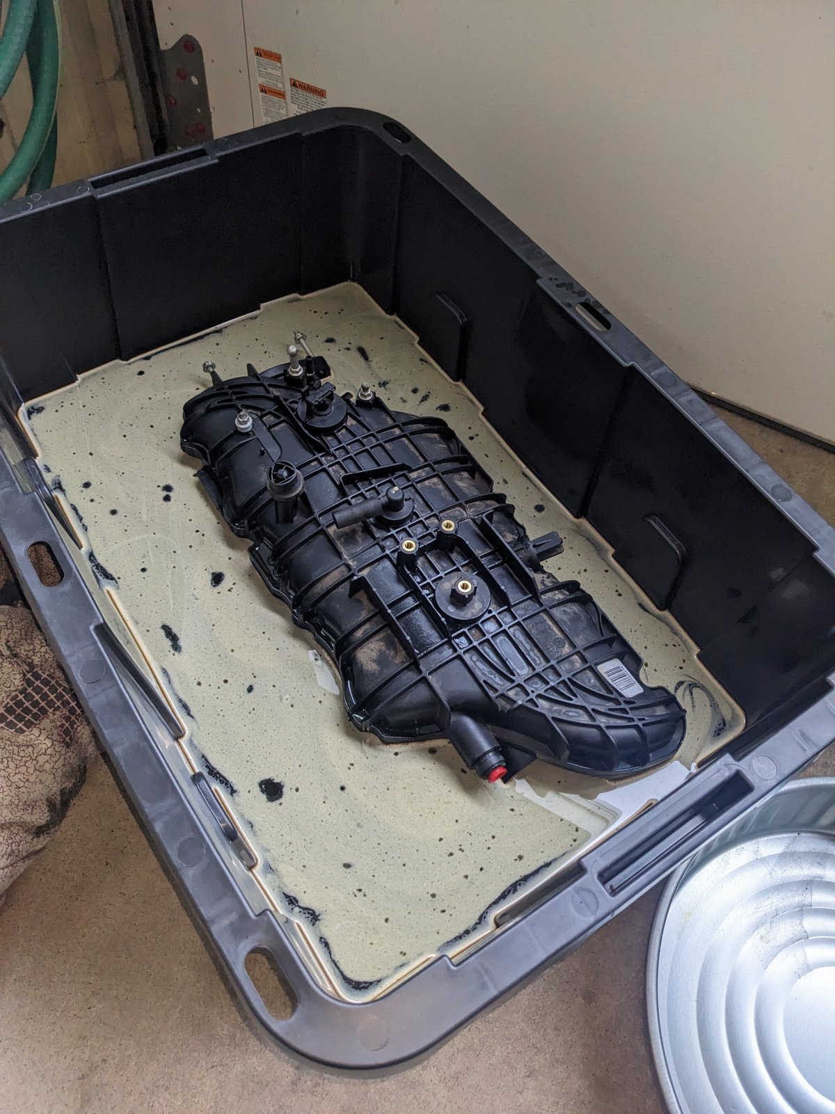

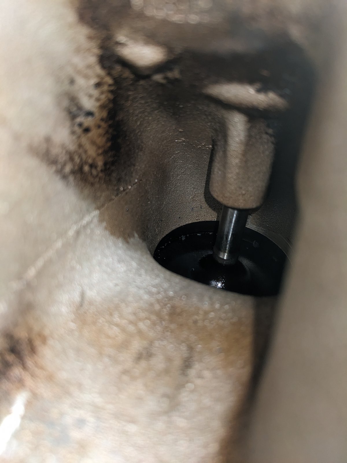

Got it mostly all cleaned up. Valves look pretty good for 230k. Intake manifold is nasty so I'll need to disassemble it and clean it out thoroughly. I think a catch can will be in my near future.

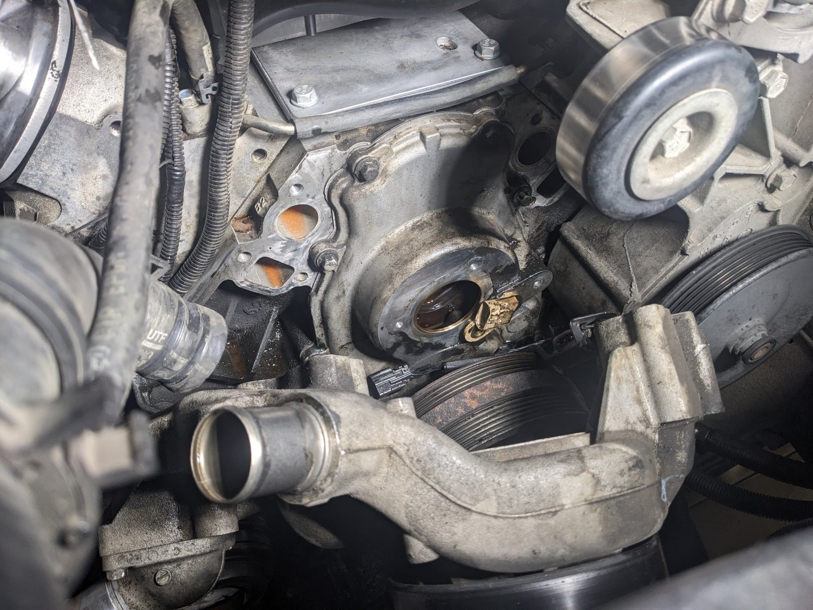

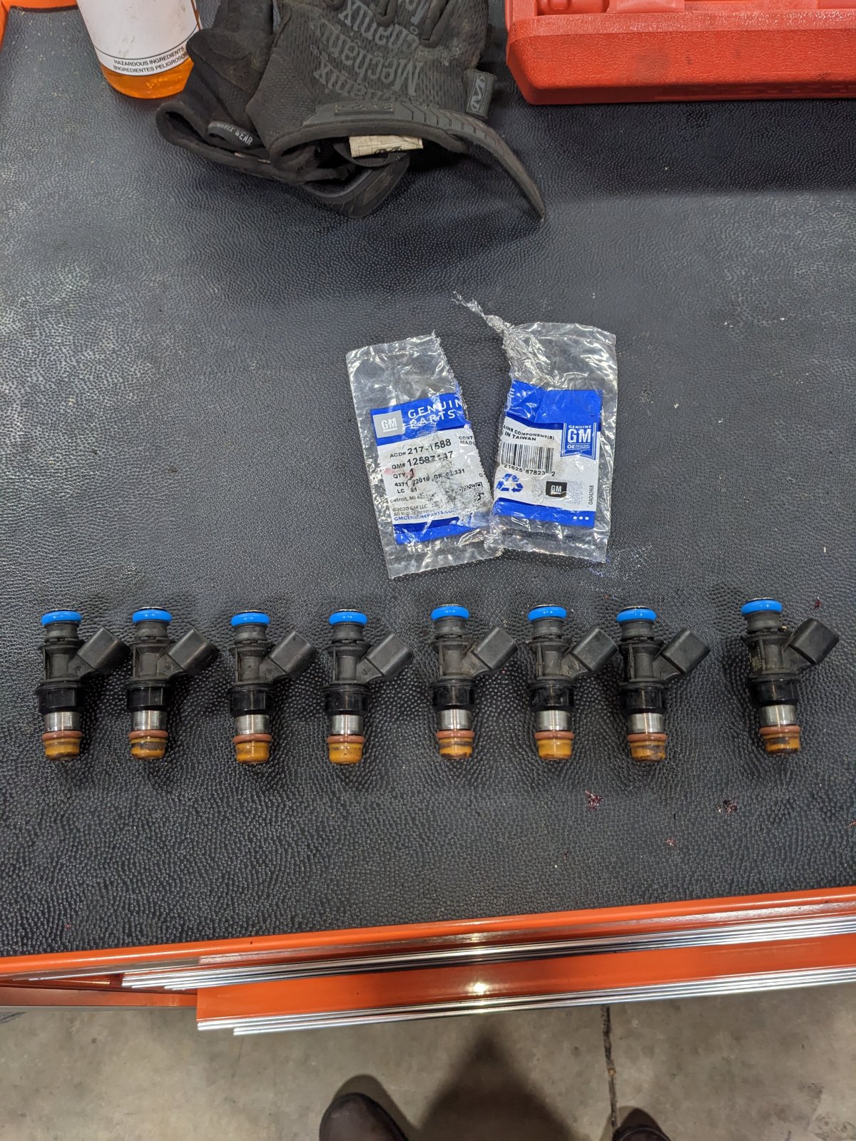

Got it all back together tonight after taking a few days off. Replaced the valley cover with gaskets (a new cover with gaskets + bolts was only $40 from GM via 12598832), intake manifold gaskets (GM 19207929), oil pressure sensor (GM 12677836), plugs + plug wires (ACD 41-162 & 9748RR), fuel injector o-rings (GM 12587147), vapor canister purge valve hose on top of the manifold (GM 12658354) and throttle body gasket (VR 711378100). Also soaked the intake manifold in degreaser for a day then soapy water for the day and it came out nice.

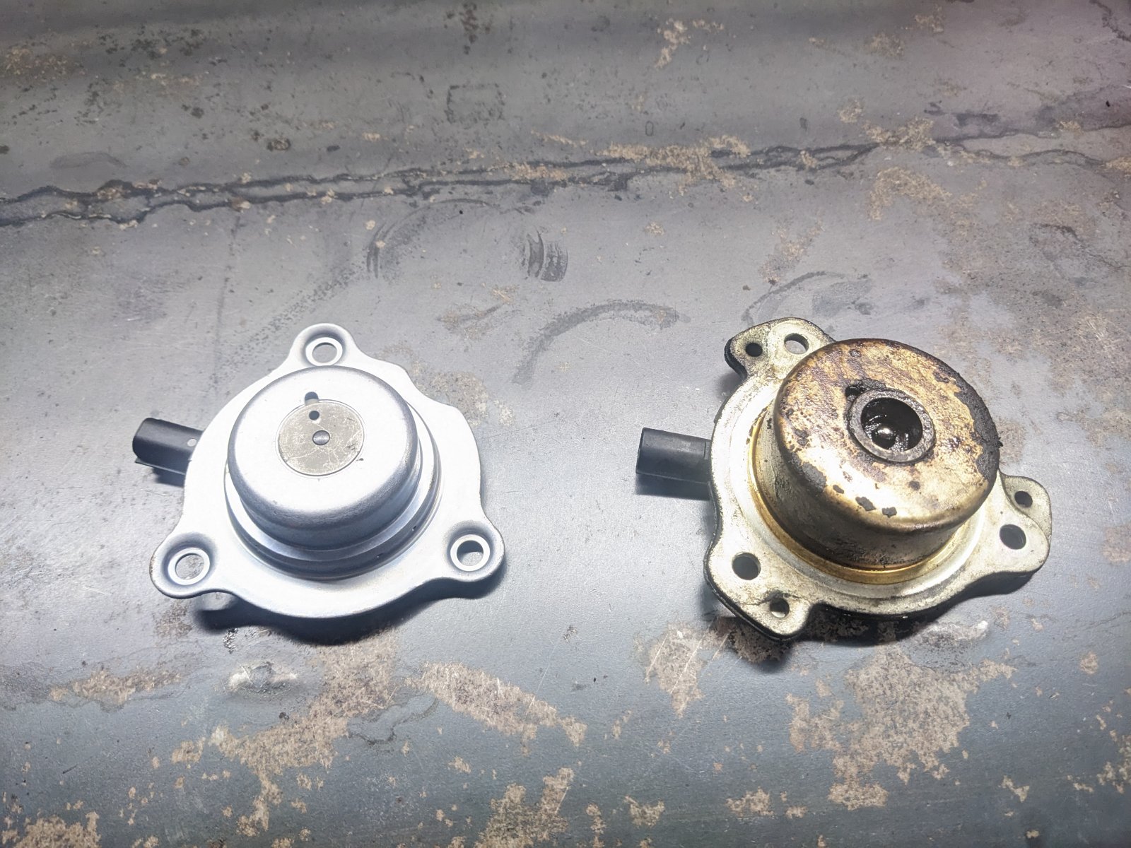

Onward and upward. Now tackling the 1 code I get every once in a while, a P0011 which also triggers the Stabilitrak lights. Camshaft actuator solenoid seems to be the issue there. Going to replace the cam position sensor while I'm in there (have it soaking with some Kroil oil now). Both parts going in are OEM GM.
Pulled the camshaft actuator solenoid and its really gunked up, the magnet inside barely moves at all. Hopefully can get it all done tonight, pending the camshaft position sensor doesn't fight me too much coming out.
