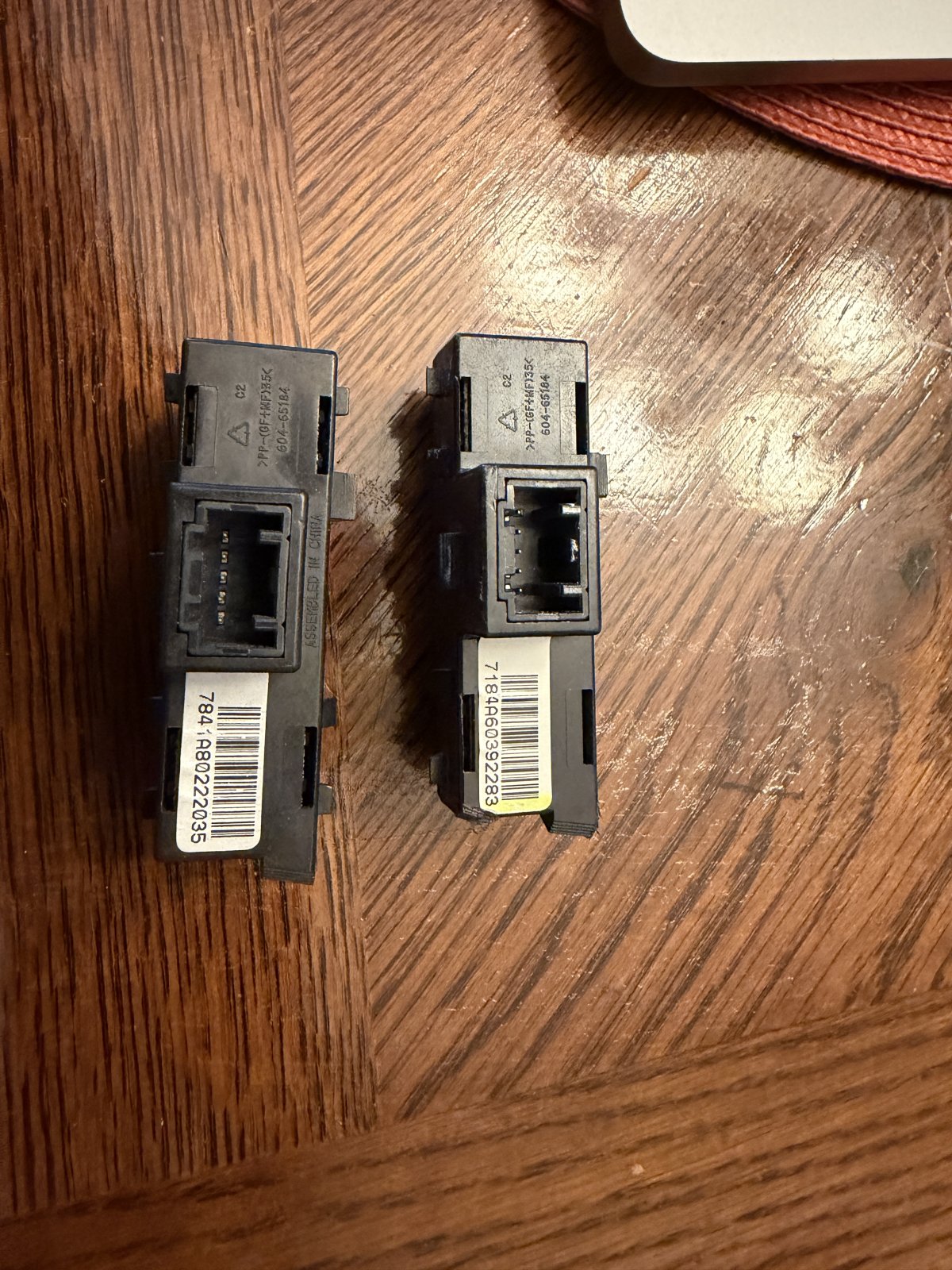

I learned that the 4 button module is unique to the specific model. The one I had left out all the key features I mentioned. I got the module from a Yukon Denali and I got all the missing features. The junk yard is full of of these. If you are looking to upgrade the part number on top is the LT and the part number on the bottom is the Yukon Denali

Wow! Nice detective work! That's the first I've heard about different buttons.
Odd that an LT Tahoe can be better optioned than a LT Yukon..
Maybe they standardized the upgrade at some date?
OR, your first switch was somehow faulty? (not seeing how...)

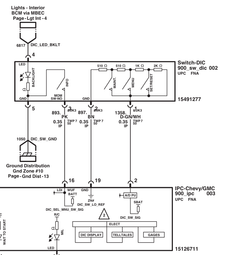

I only say that because the diagrams are the same for '07&'08 chevy/gmc & cadillac...
And the info button looks like a straight switch...
Based on the orientation of the picture, would you clarify which one on the left, and which on the right (instead of top and bottom)?
The part number that starts with the 718 is the DIC module that is from my LT Suburban.
