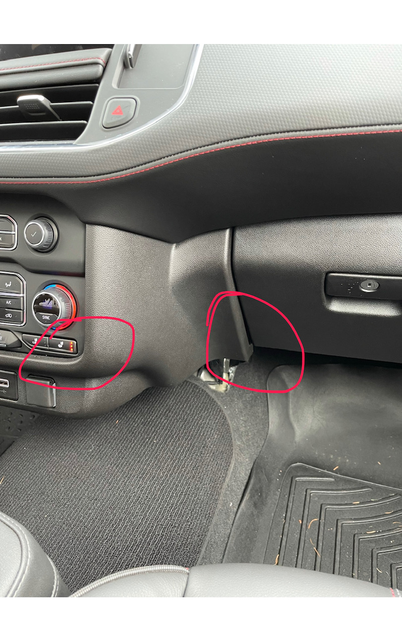

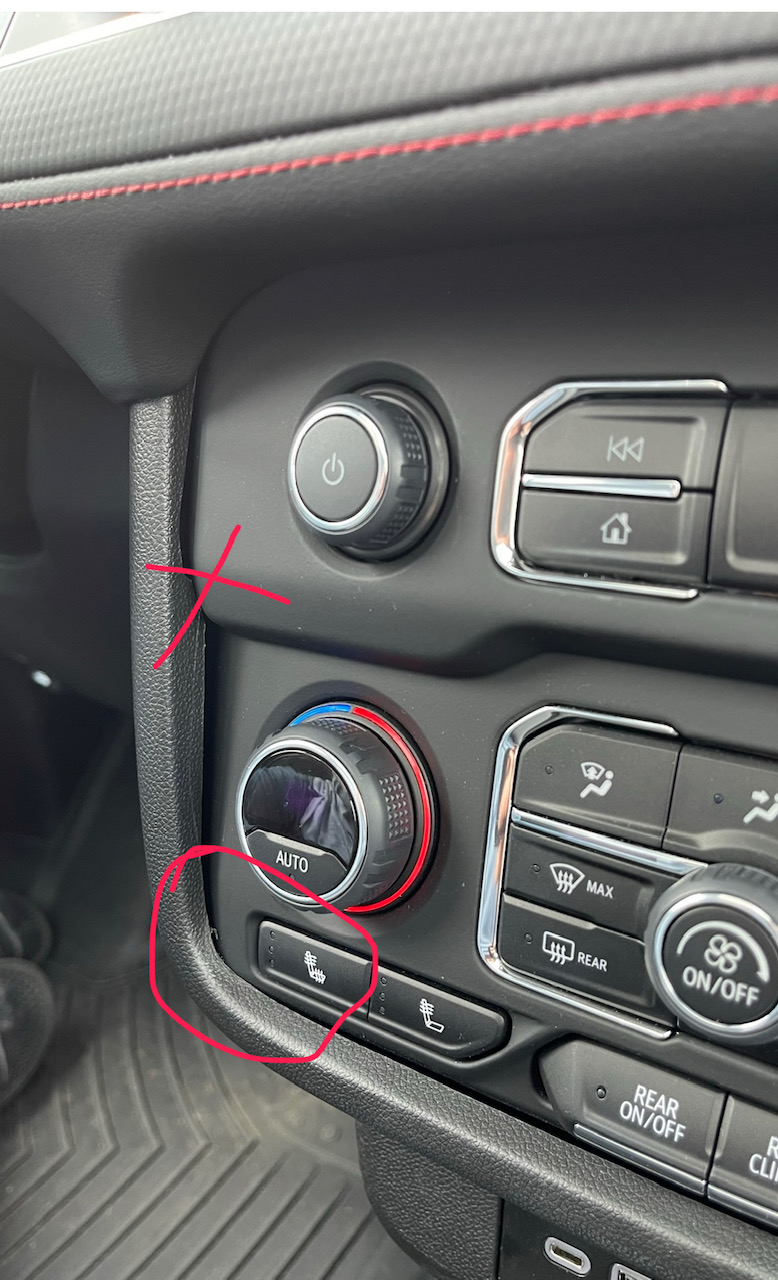

I just received the lower piece of the trim and still need to install it. The pictures I posted are taken from an angle that you cant see where carpet/floor meets the lower center console, because there is a gap/opening still below the center dash trim I installed. And the carpet has a hole in it on the hump where the console was, but I covered it with a oem rear floormat from my subaru legacy for now. I also purchased aftermarket all weather floor liners on amazon for pickup truck that come with one piece front liner that goes over the hump, and installed it, however, it is a bit too big, and is not a perfect fit over the hump, but overall looks good and is good protection (see photo). I will post more pictures when I am done. As far as overall effort, I thought it would be smoother/easier. The main issue I ran into is the center dash trim that covers heating controls, audio knobs and where front heated/cooled seats controls are, is different on LS/SLE trim compared to higher trims. (i whish it was the same, because it looked the same on dealers website pictures and videos of both trim levels i have seen... but it's not, and it is angled a little different, meaning the lower part of it comes out about 1/2 inch closer to the jump seat that I installed, so at the end, I believe the legroom in that center seat I installed has about 1/2 inch less space. And if I buy the correct dash cover from LS model, it will not have openings where heated/cooled front seats controls are located... so then you would have to cut them out, and I am not sure how easy it will be and how it will look) I am still very happy with results and It's not noticeable and it looks like original. (see pictures of parts i ordered and the difference in dash trim/cover, i installed #2, and just received #3 lower trim, i left #1 trim stock because it has heated seat controls in it) Hope that helps. Merry Christmas!

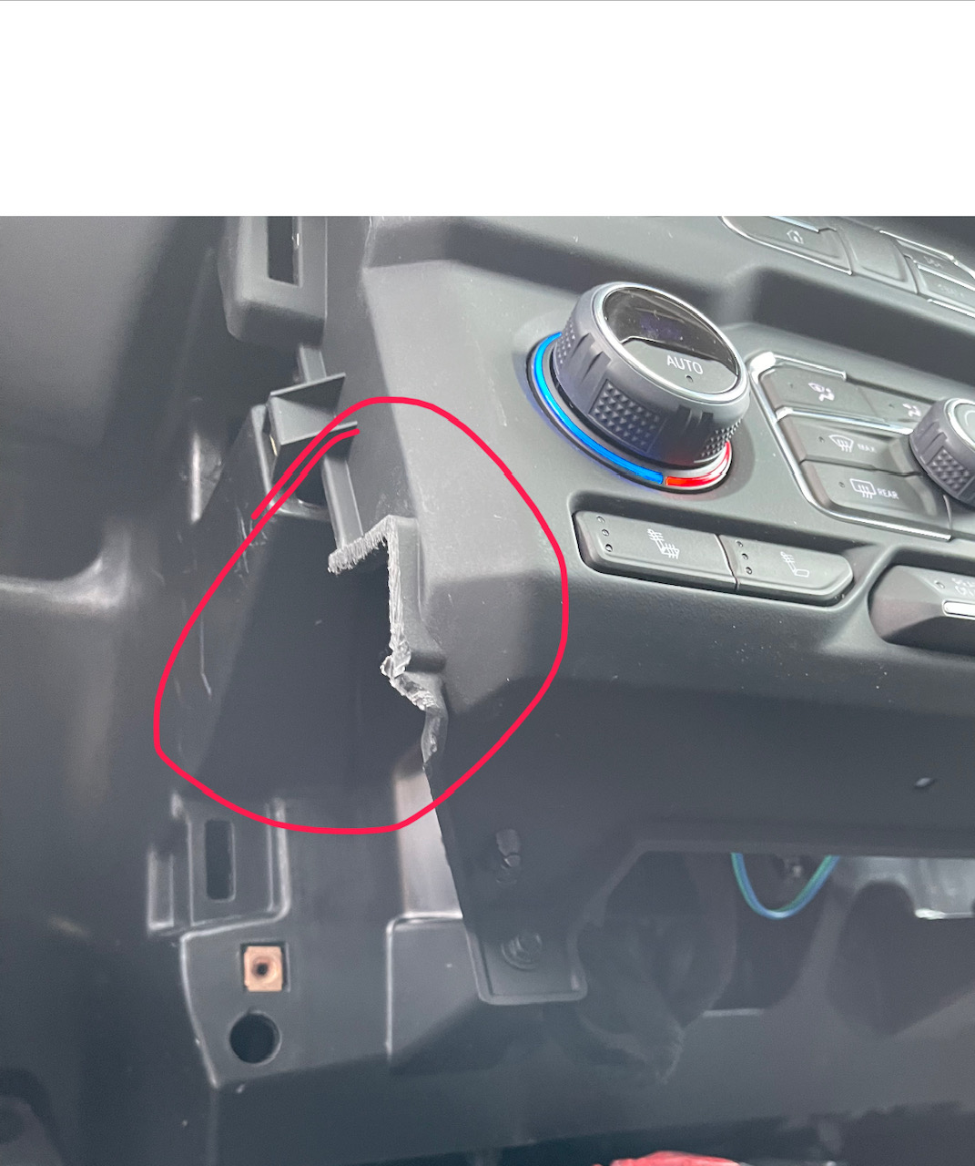

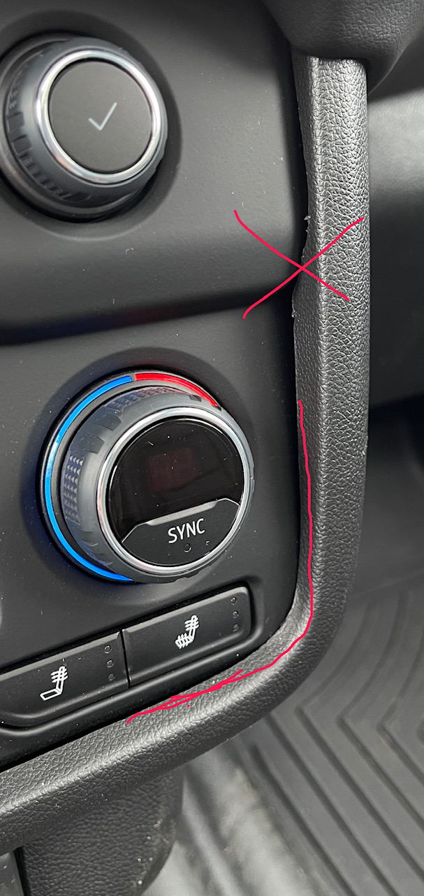

Update 7/11/22, So I finally got to trimming out the center dash to fit it around the center heating controls. Now both sides fit and are flush with glove box, and I am using all weather front mat for pickup truck that is one piece to cover the carpet hole. see pictures. I am pretty happy with results, If I would do it again I would be able to cut out/trim the dash better because now I know what sections need to be trimmed. At first, it looked like the sections where volume control/radio dial is located also needed to be trimmed but after I trimmed the lower section the whole dash panel sat more in and down and then I realized that I should have not touched/trimmed the upper sections, so now I have small gaps. Anyways, see some before after pictures.

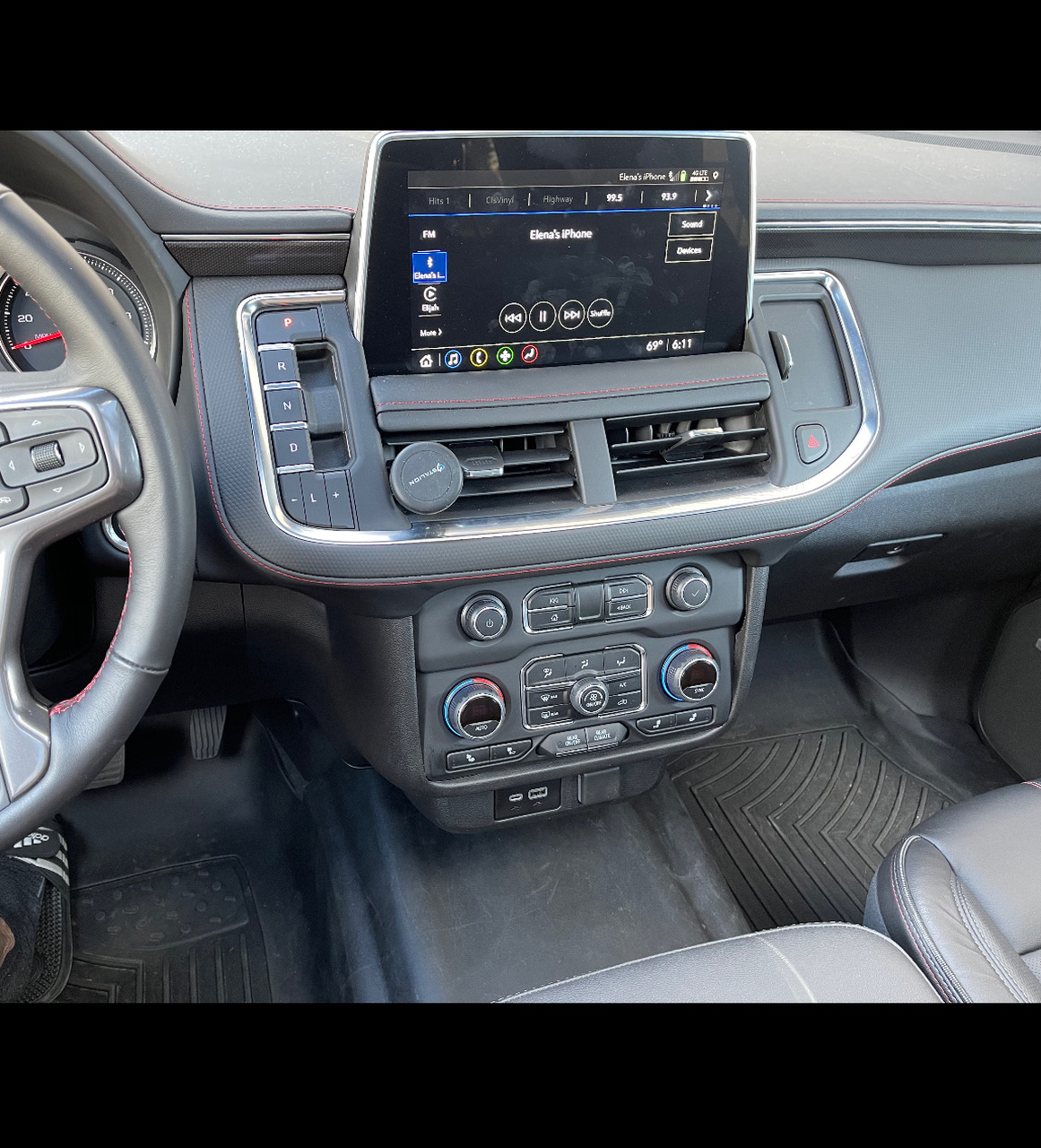

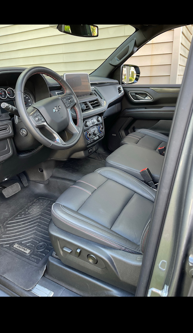

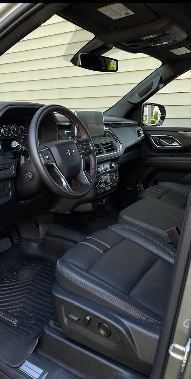

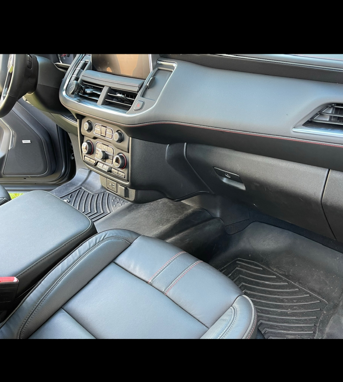

final pics

Very well done! This is truly one of a kind.

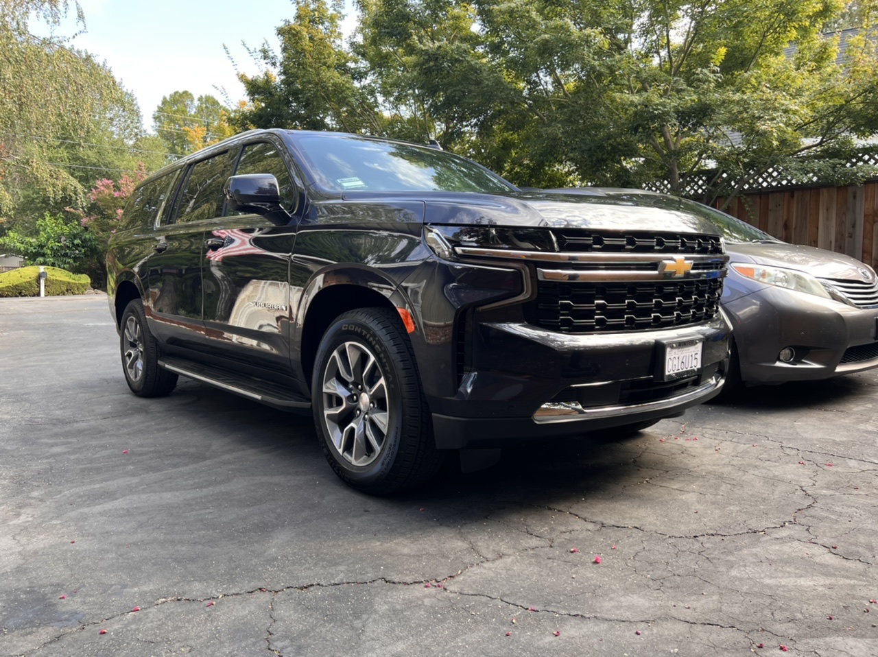

After an 8 month wait, she finally came. This is the most poverty spec duramax I’ve seen so far ;) (4x4, max trailering, blind spot monitor, 20” wheels). Especially around here, where half of all the soccer moms seem to rock a Denali or Escalade. I just couldn’t justify dropping 100k on one. Besides, we still have the X7 for luxury/sporty driving and will likely use the burb for longer trips or when we need to bring a lot of stuff.
Nevertheless super happy with it. Put on 140 miles since picking up yesterday and fuel gauge still shows full (?!) not sure if broken lol.
Appreciate all the inputs here! I’m sure our rather large family will be enjoying it for many times to come. Will be looking into some upgrades next!
