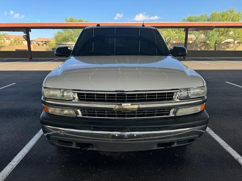

2005 Suburban 2500, 6.0/80E, 4.10s, LT package with heated leather, 3rd row, rear seat entertainment, everything I need and nothing I don't. This popped up on CL in Phoenix and although I considered doing a fly and drive, the schedules didn't work so I just had it shipped. Having driven it for a few days now I wouldn't hesitate to go across country though.
I already pulled off the crazy dark tint and need to clean the interior a bit. For the mileage it's in nice shape and most importantly there is no rust on the body, and minor surface rust on the frame as it lived in Idaho most of its life.

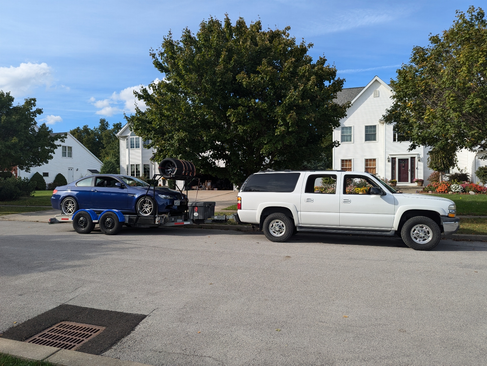

Slapped on a 41930 hitch and put it to the test towing my M3 300 miles round trip down to Watkins Glen for an HPDE weekend. I slept in the truck for 3 nights at the track with plenty of room for all my overnight and cooking stuff. The rig was comfortable and towed great, no doubt due to the long wheelbase and heavy weight.

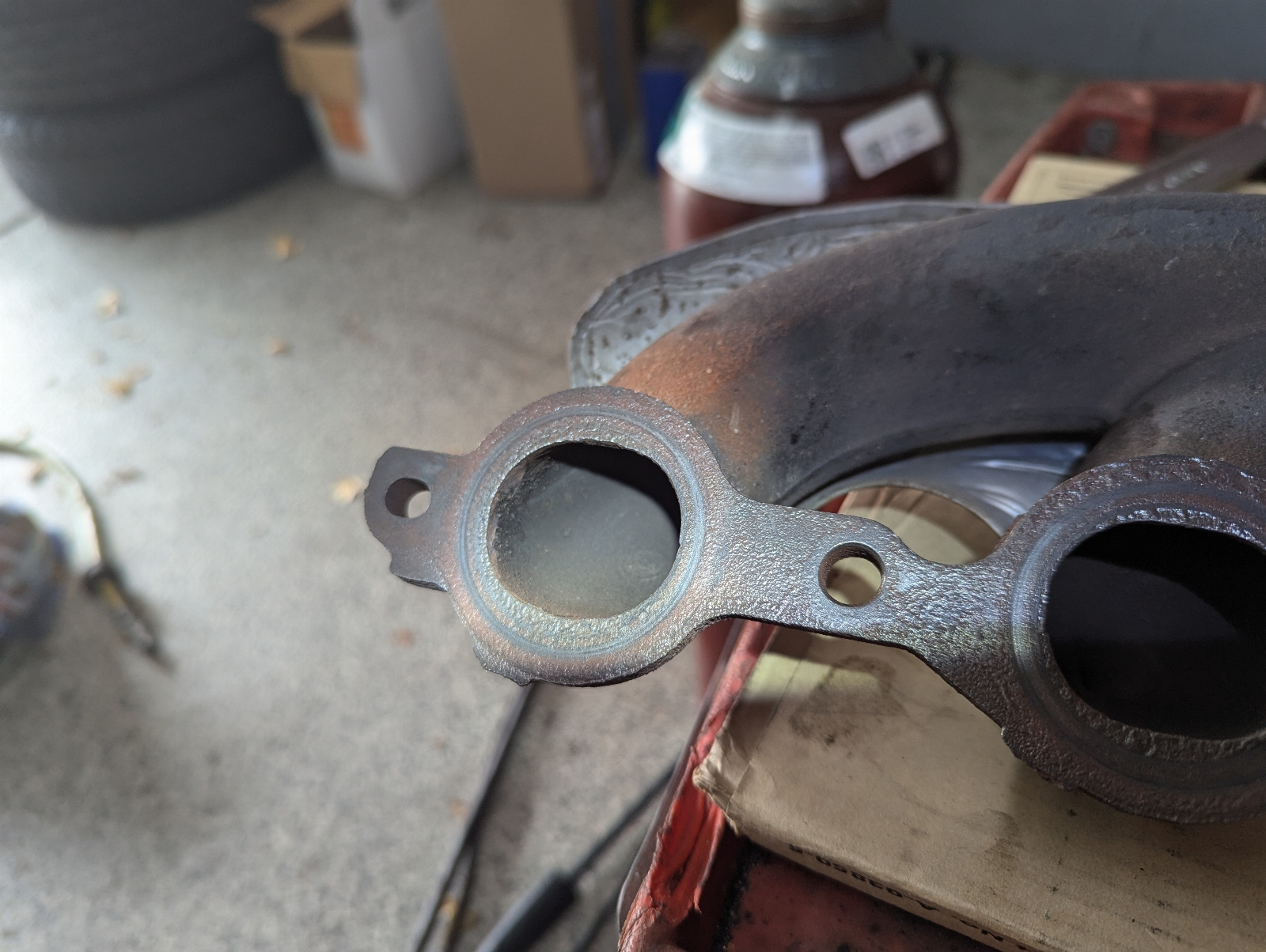

-Needed access to broken exhaust manifold bolt
The frame looks good but was definitely spray bombed by someone in the past. The bare areas show some minor surface rust but that's to be expected for a 20 year old truck. After doing some research I think Woolwax will be the best product for this application.

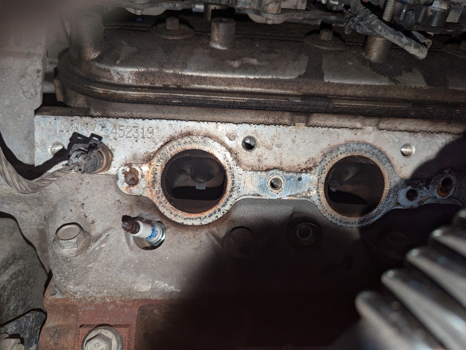

I zipped off the 5 remaining manifold bolts, and one of those broke coming out. Therefore, 2 broken bolts to extract on the driver's side...far back and up front.
Best method ever for removing these: weld 'em up. Done this one every LS I've ever owned/swapped and it works every time.

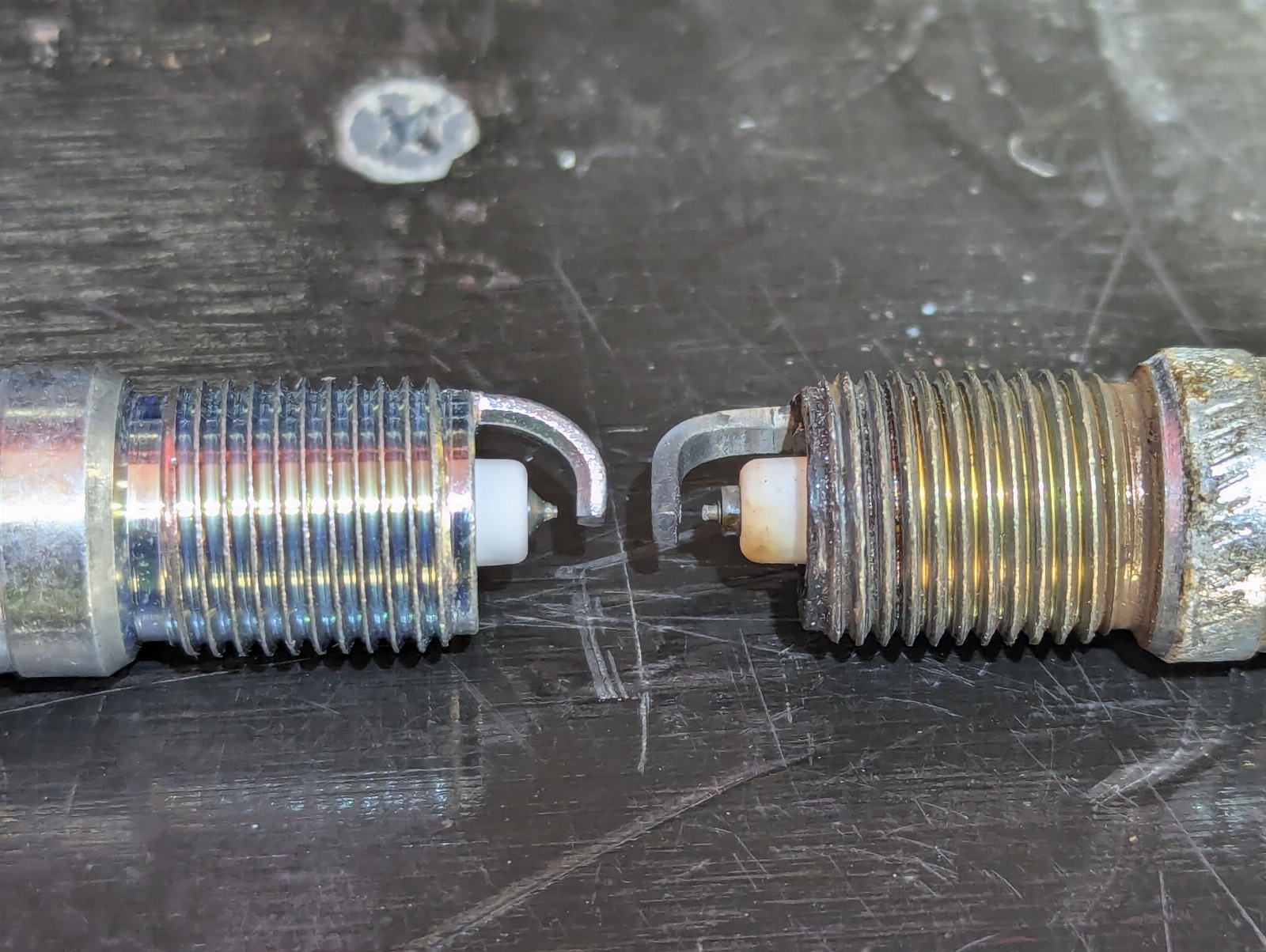

Pulled the plugs while I was in there, pretty decent but might as well
Wire wheeled the gasket surface

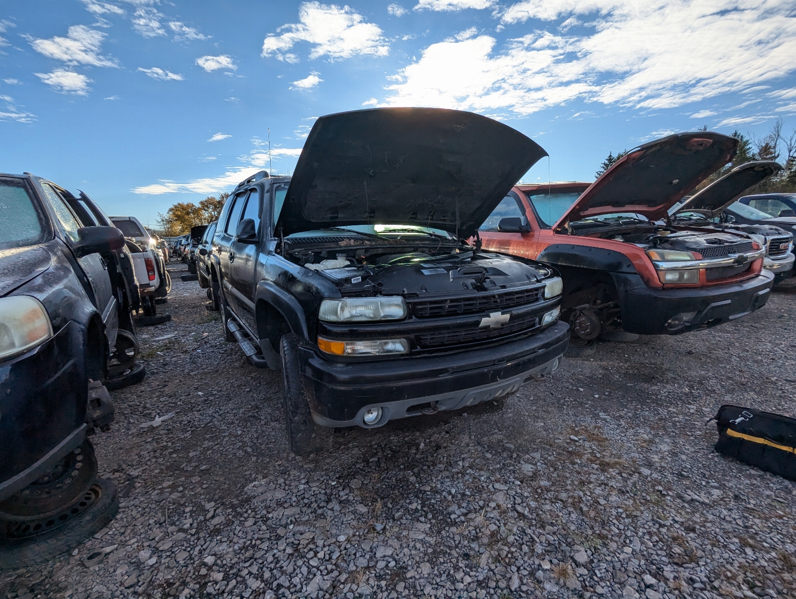

While I was waiting on some parts I made a trip to a few junkyards locally. Picked up Z71 front air dam off this 03 Tahoe and also found a pretty rare 06 LTZ that I grabbed the Z71/Chrome roof rack from. Also grabbed the e-fans from that thing for next year.

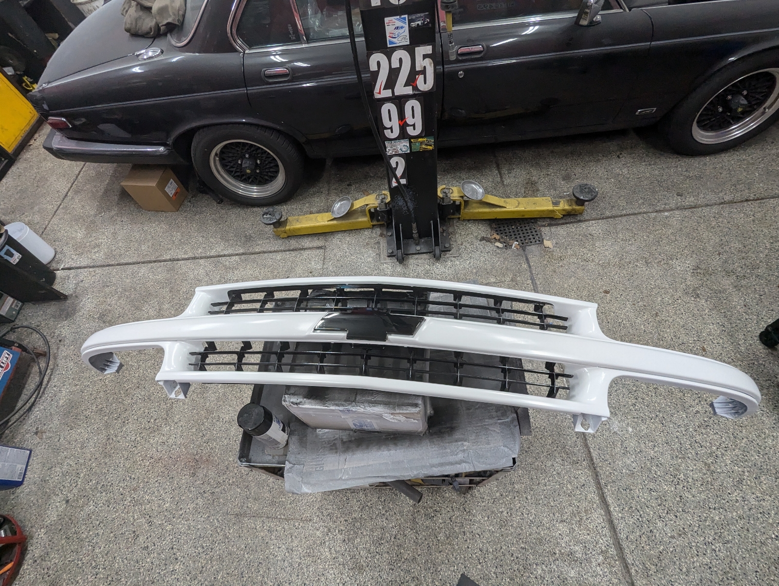

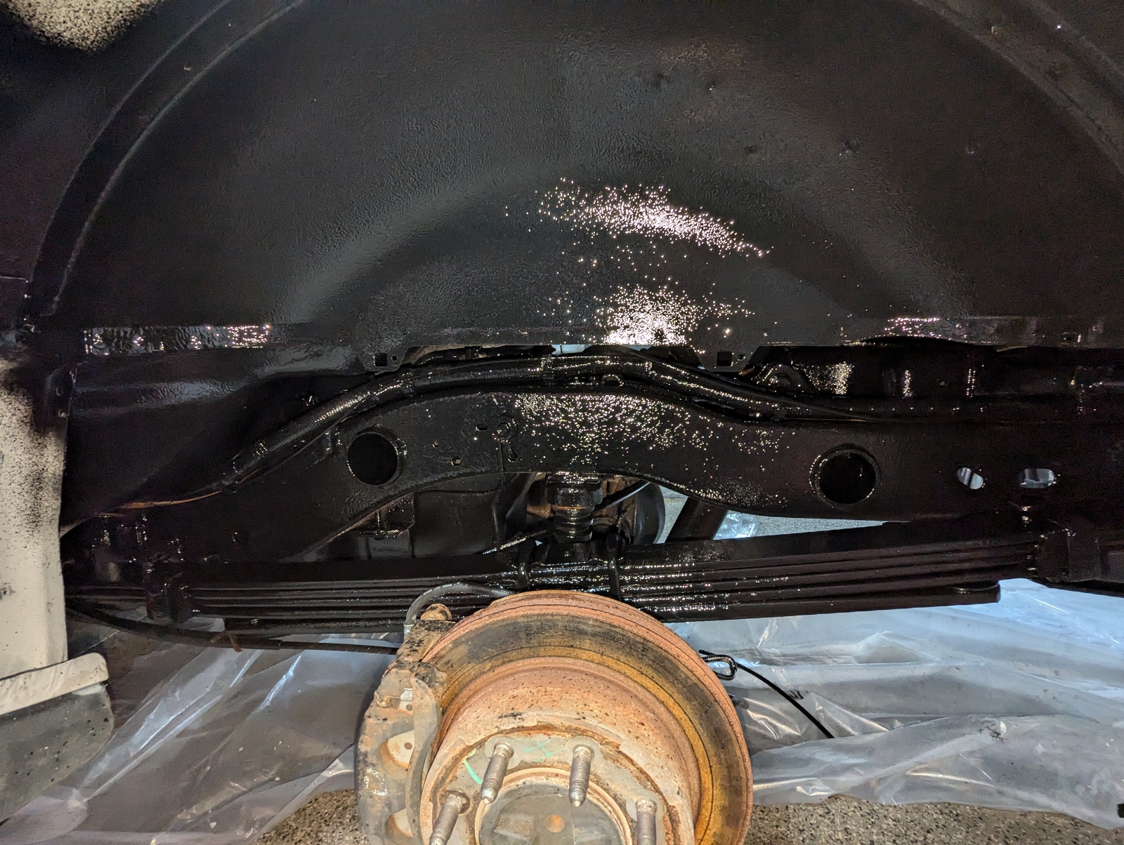

Home stretch with winter prep. Removed the fender flares and wheel liners, started spraying woolwax. Easy to apply with the supplied gun in the kit, just messy and a little uncomfortable laying on my back.

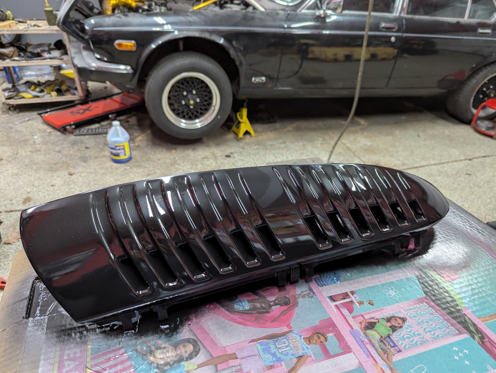

Painted the tow hooks front and rear to modernize things a bit. Stripped the grille down to repaint it body color as well.
Painting didn't go well. I need to do a better job cleaning parts before beginning.

Rolled around town for almost a month with no grille looking terrible. Lots of snow in WNY also. Surprisingly the truck handles it well in 2WD.
More painting frustration. Learning to do a better job of cleaning and timing my subsequent coats so that there are no reactions. Lots and lots of sanding after this...
Many hours later...

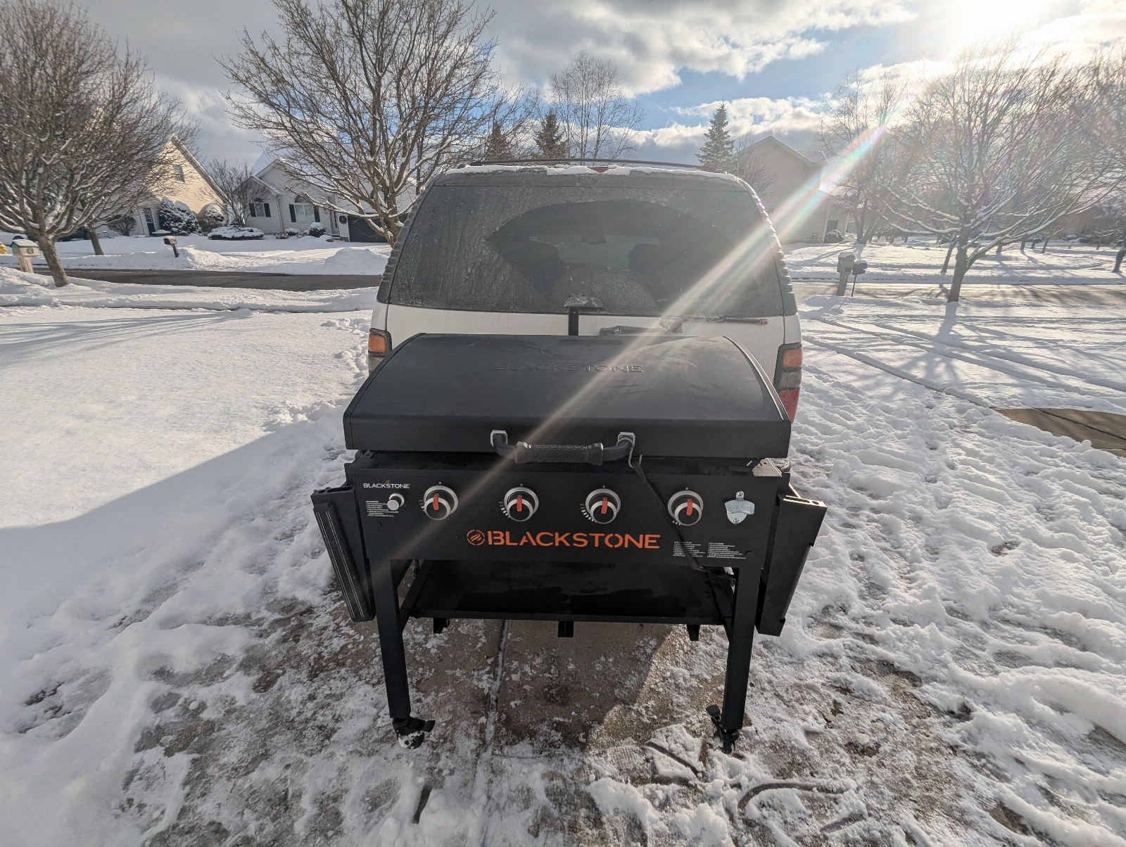

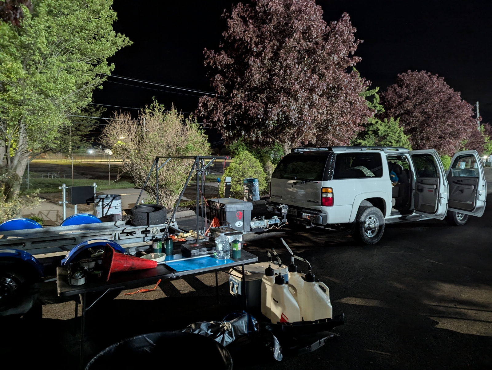

My wife and I bought tickets to a Bills game and we like to go all out with tailgating, so I dug through my scrap pile and rigged up a mount for my flattop griddle. It attaches using 2 hitch pins for easy removal.
The 1-1/4" square tube is also used as a bike rack I made a few years ago

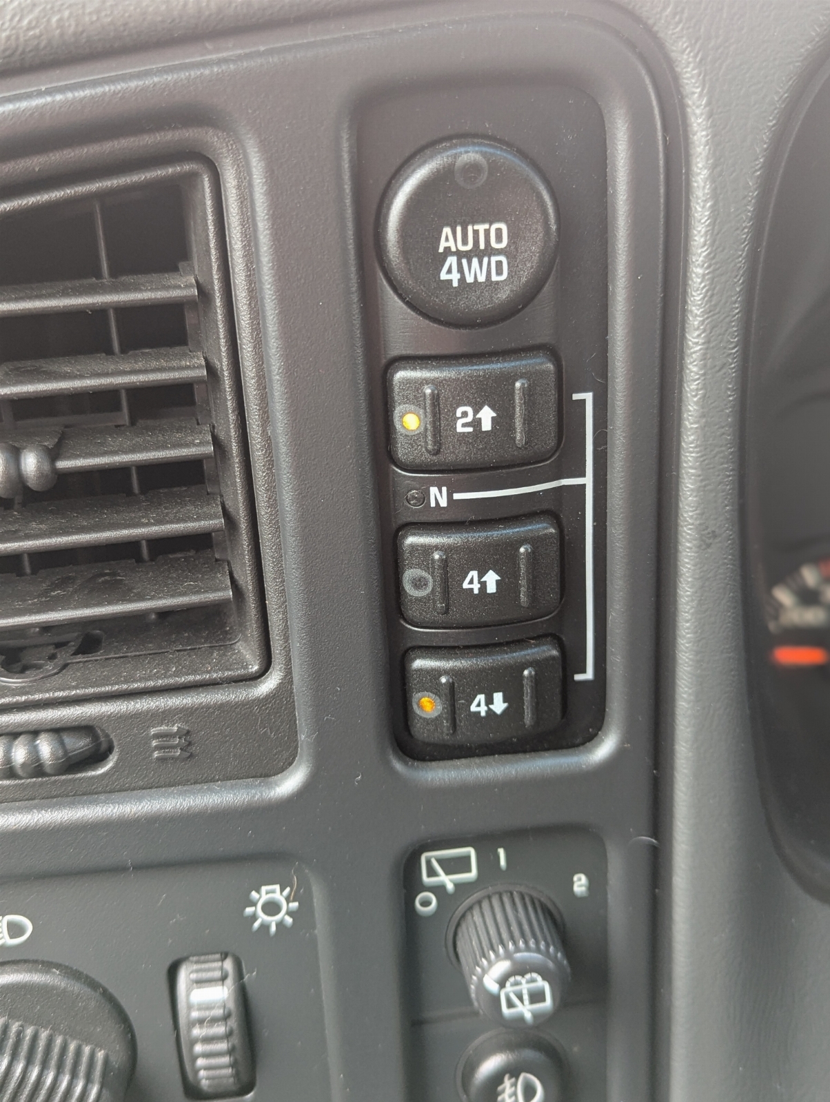

The 4WD system was freaking out and finally started to affect driveability with some weird shifting issues.
I finally got around to installing the new transfer case motor, and cleaned out the electrical connector which was full of green corrosion. Just need to install the new front driveshaft and I'll have working 4WD again.

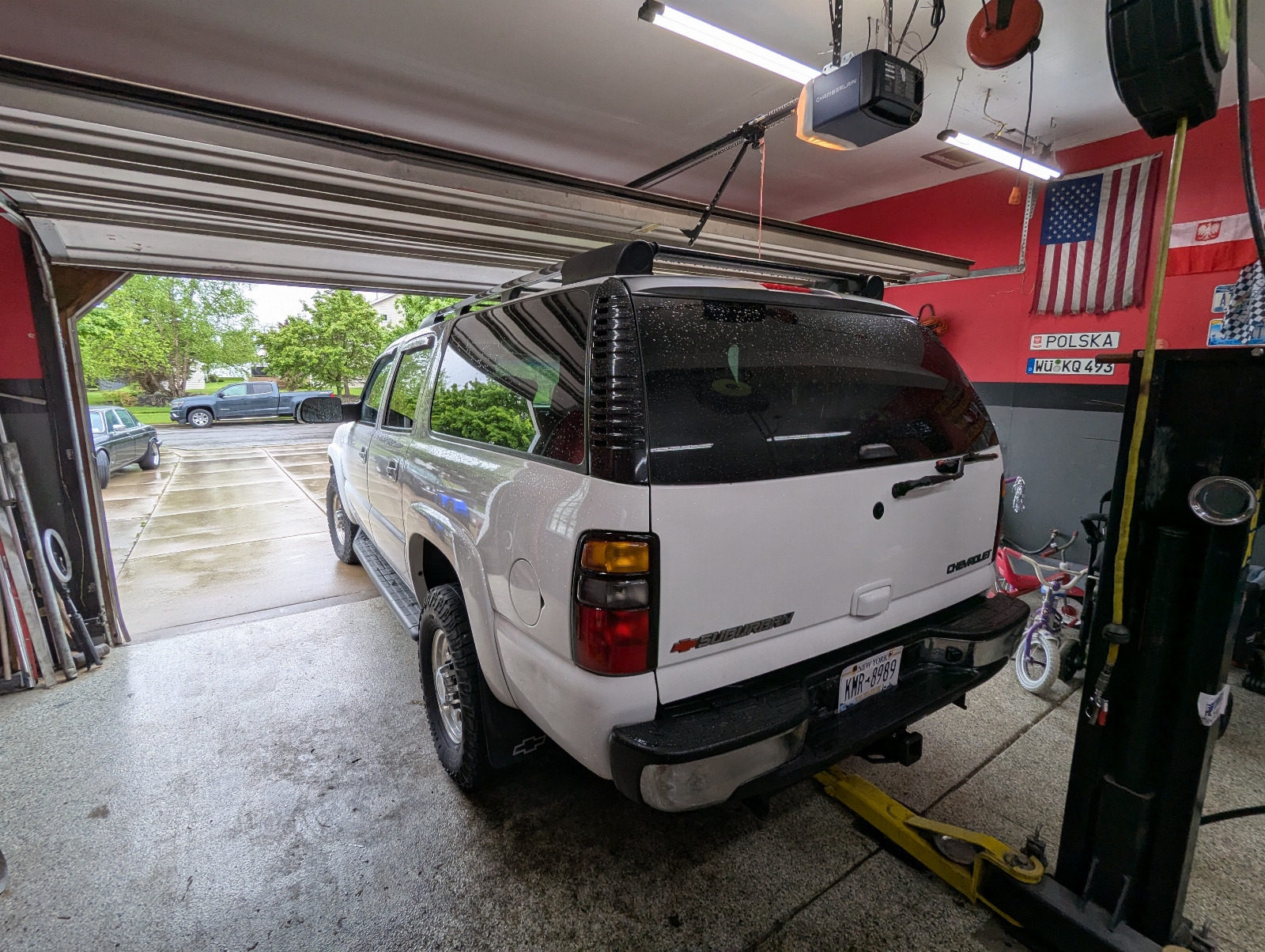

Somehow this is the only photo I have of it installed. Check out that sweet park job. I am standing on the street in this photo.

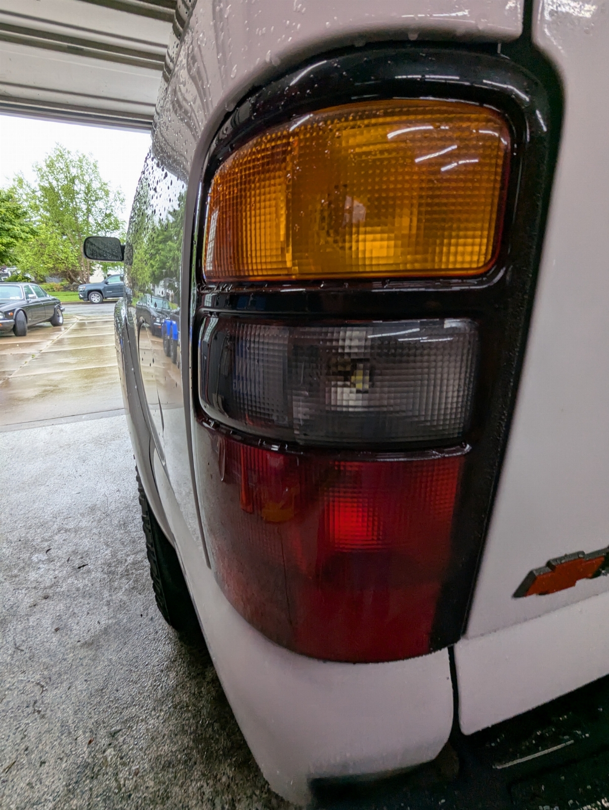

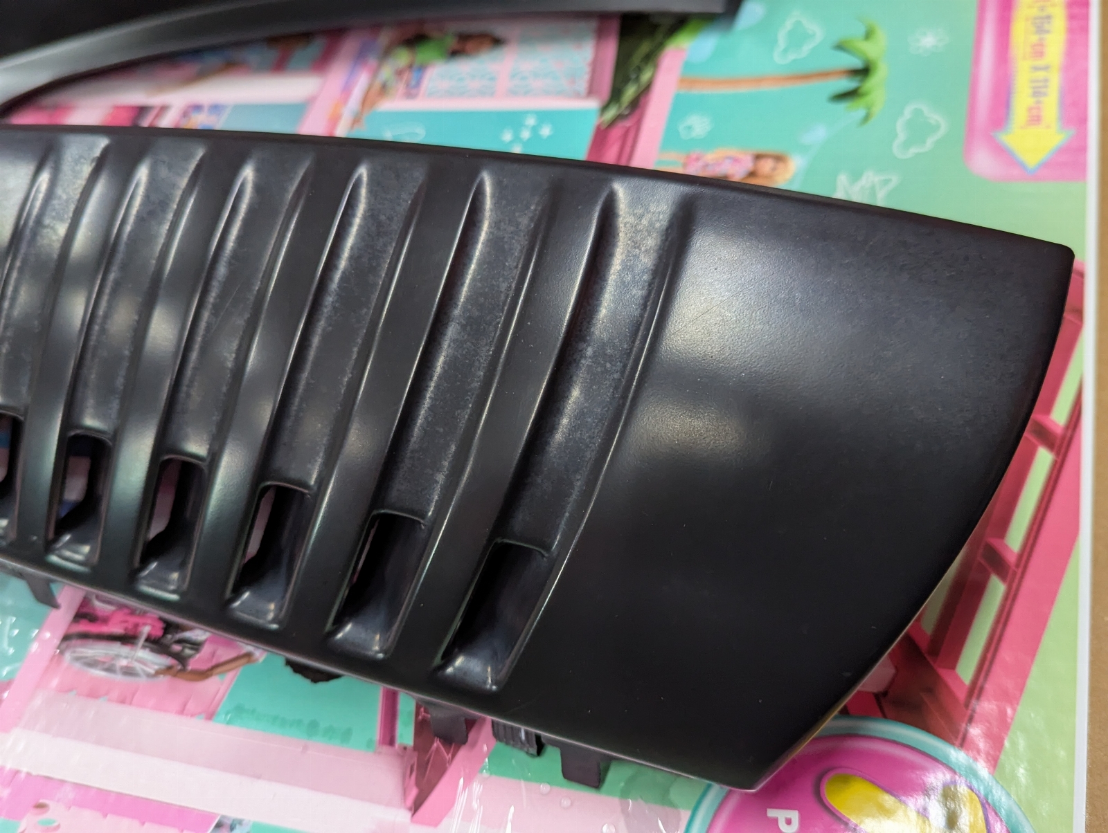

Exterior needed freshening up, 20 years had taken its toll.
D pillar covers before:
After:

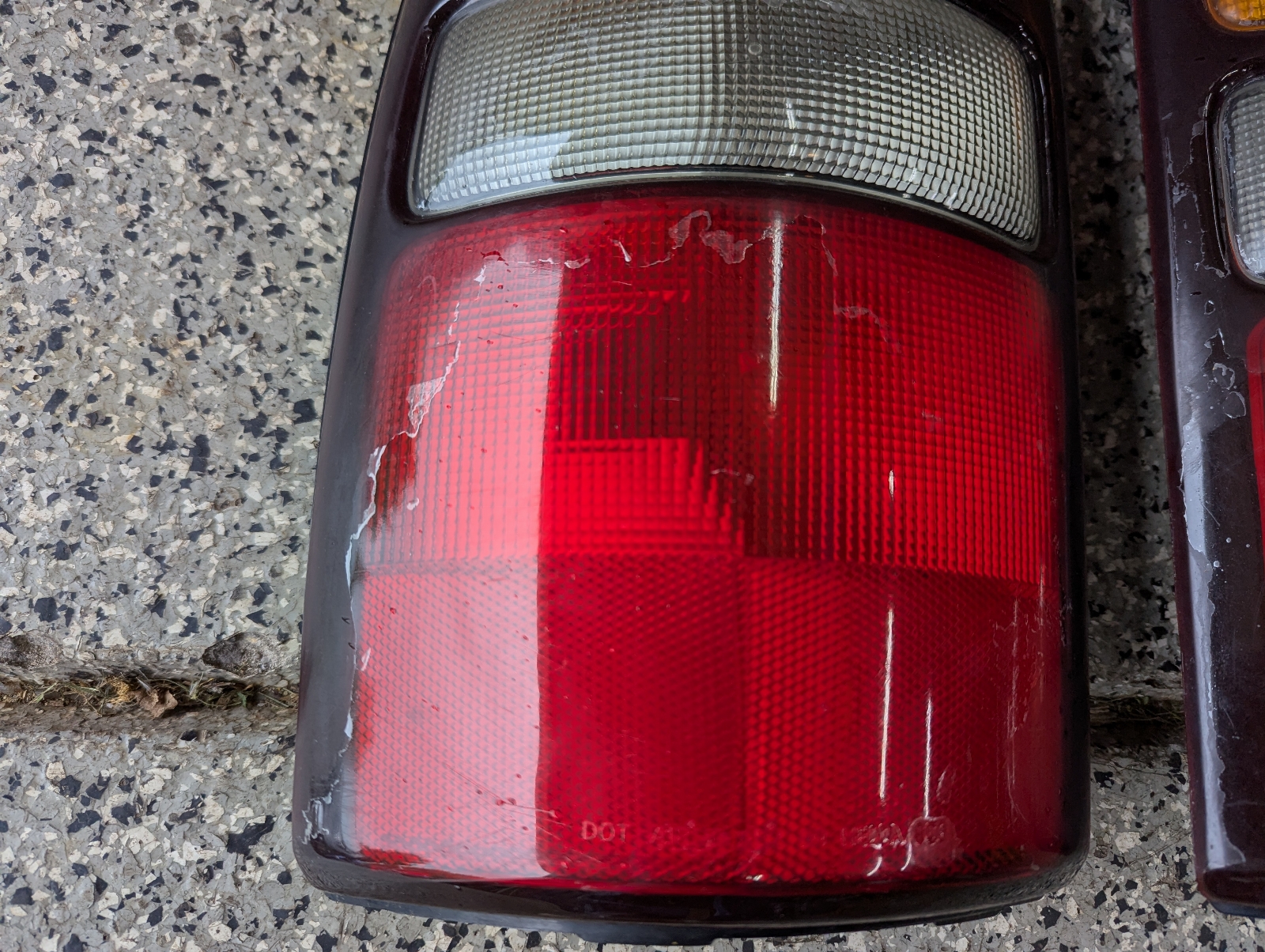

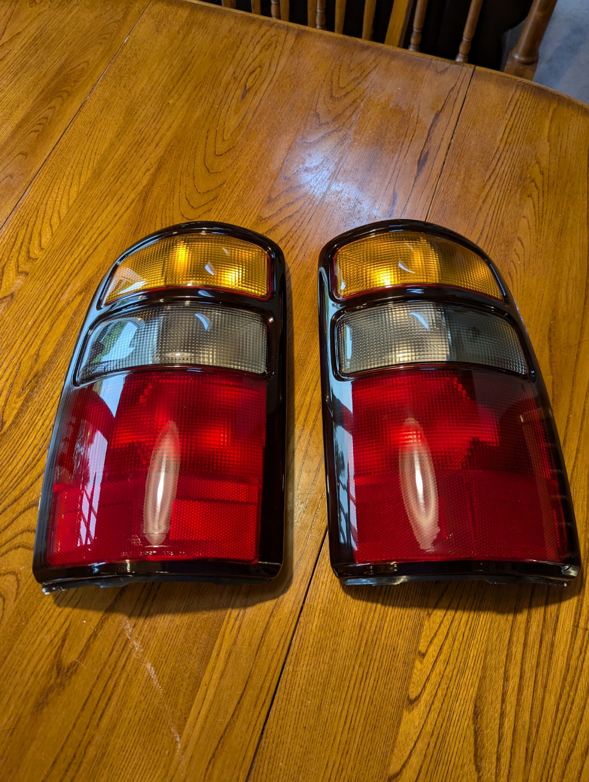

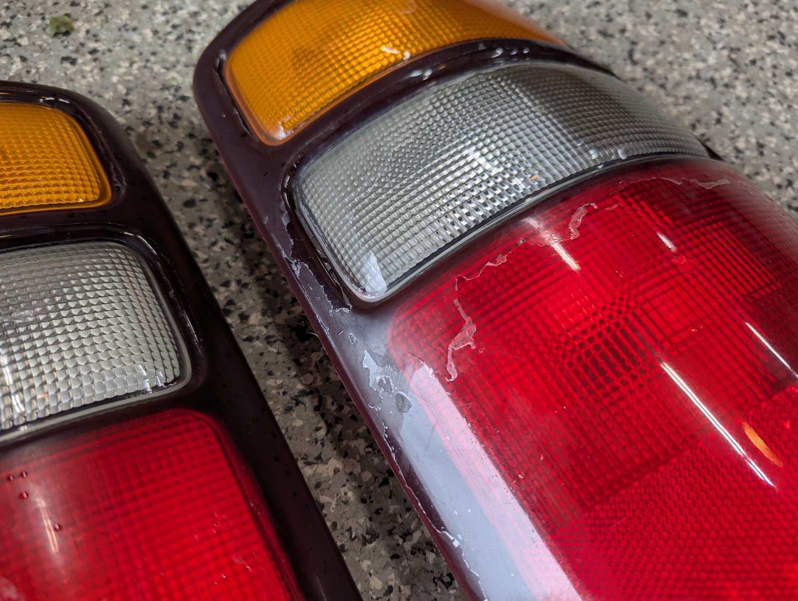

Rear taillights before with odd clear coat peeling:
I thought briefly about sanding and polishing the originals but new ones are so cheap that it's not worth the effort.

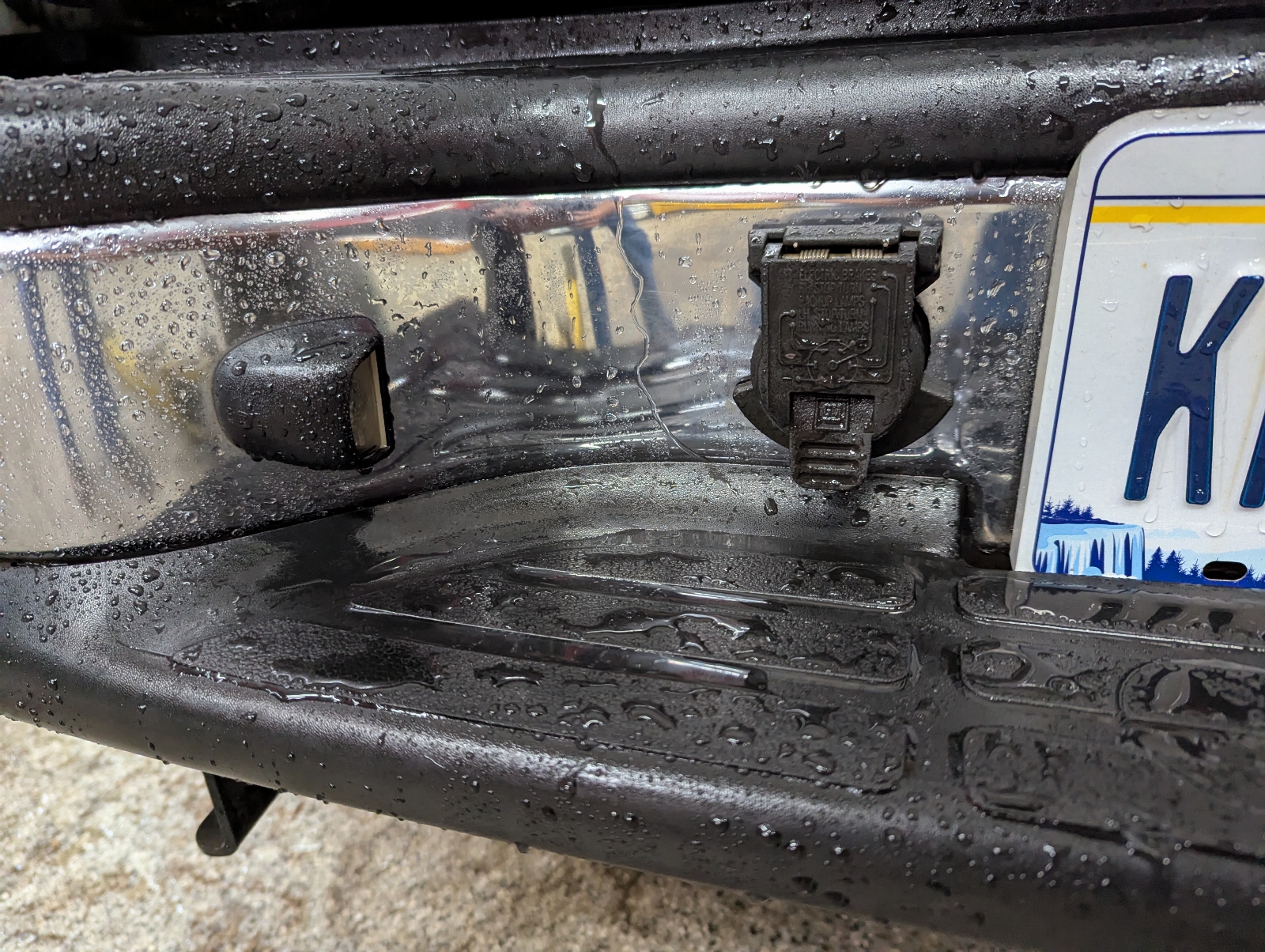

Relocated the 7 pin connector to the bumper.

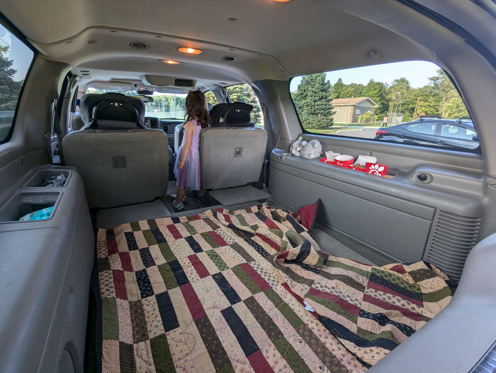

Spent 3 nights camping in the back of the truck at Watkins Glen for an HPDE with BMW CCA.

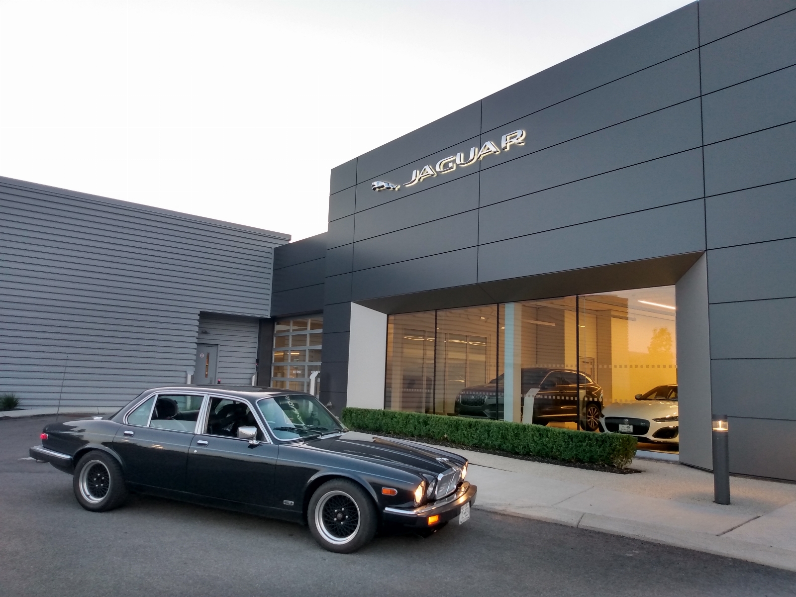

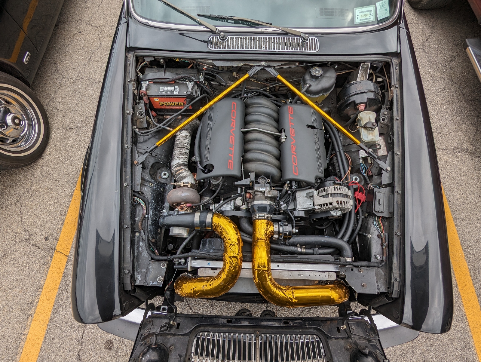

Is that a Jag with Trans Am wheels on it?
It sure is, it also has a turbo LQ4/4L80E. I build it a couple of years ago as a fun summer cruiser.
