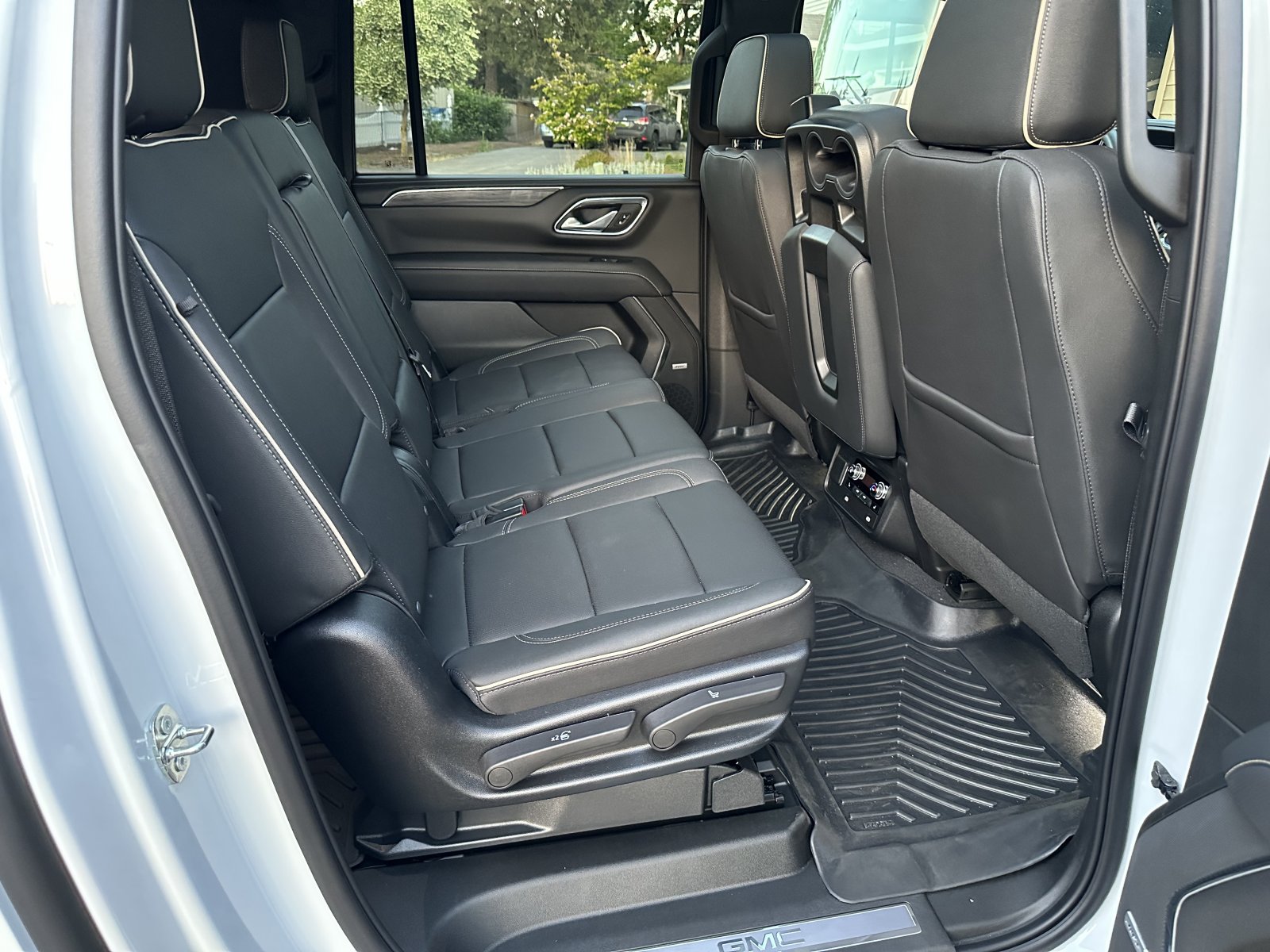

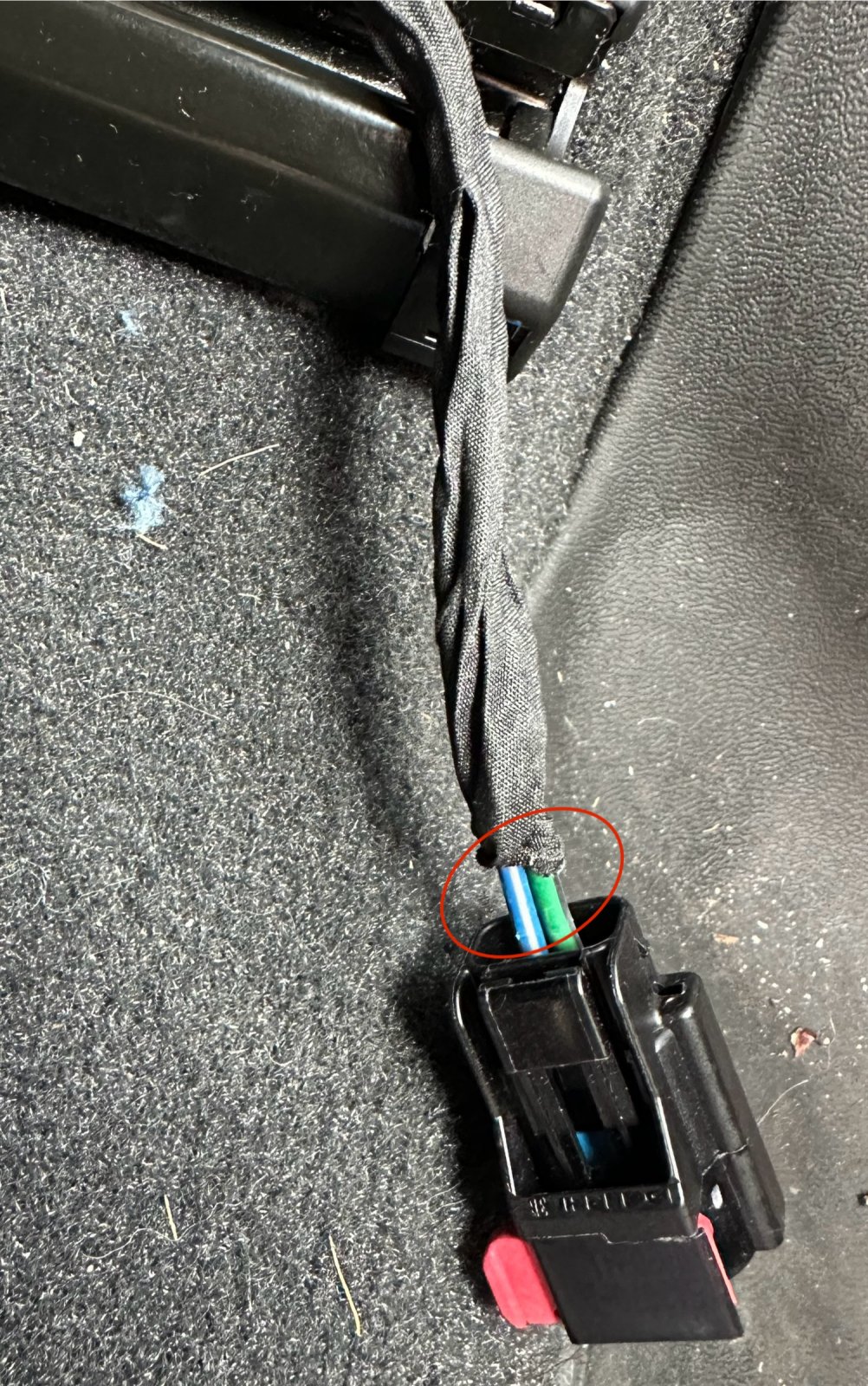

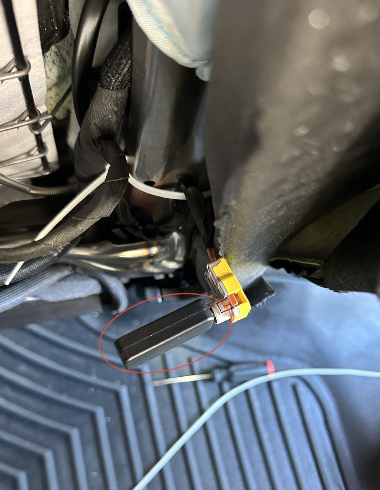

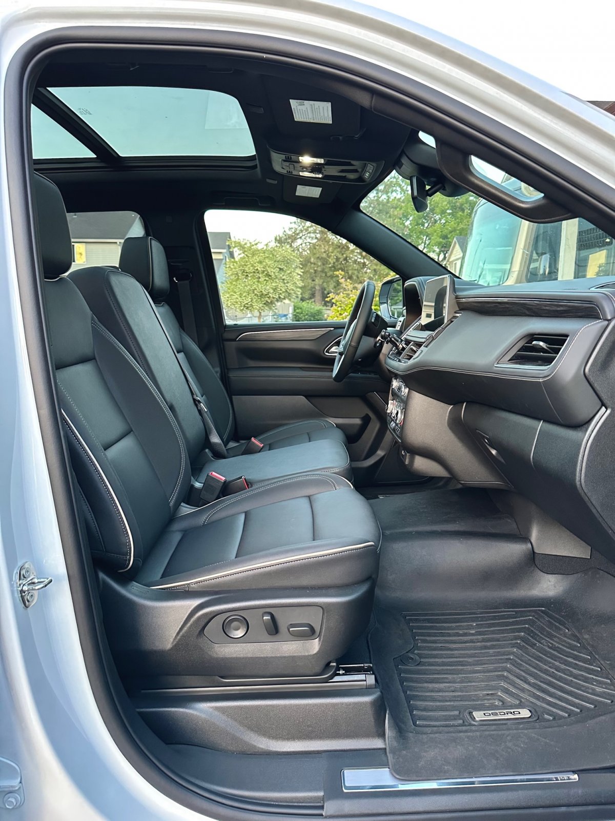

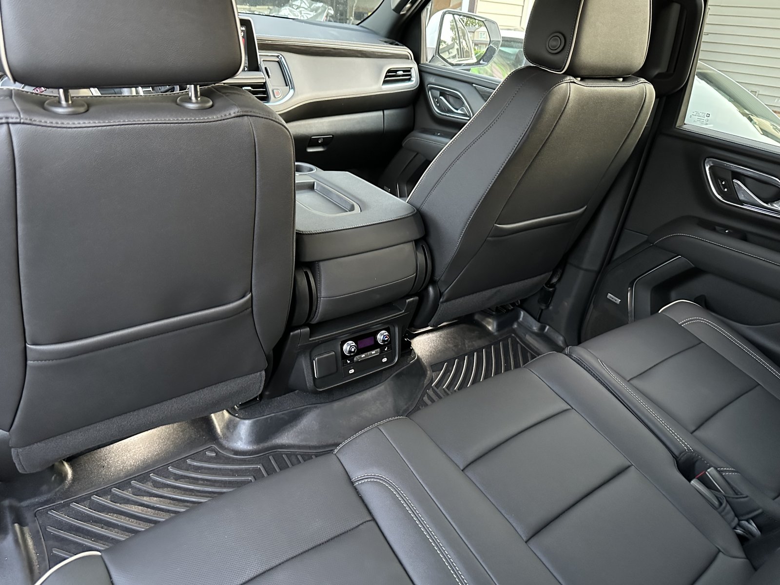

completed the conversion, some photos attached, also I have disconnected the drivers right side seat airbag and plugged a resistor into it so the airbag system works and now this bag will not deploy and possibly injure my child who will be sitting in the jump/center seat. (If you order 9 seat base model Yukon/Suburban from GM this airbag is not installed; and the back seat cover can be removed to access it without removing the seat)

I usually have my 9yr old sit there, she is not tall for her age, she is probably under 4'6"
Yesterday on our 2hr trip to the beach my 14yr old sat there, and he is probably at least 5'6" but it was tight for him.

That airbag (inboard driver seat) is not installed from the factory when you get the 9-seat config. It's a safety concern to have that airbag deploy if someone were sitting in the center jump seat. Mine was built from the factory with the 9-seat config and it very specifically states 6 airbags vs. 7 airbags on the 8-seat config. What was done here by yukon-xl is nothing more than mimic the factory config.
yukon-xl
Nov 29, 2021
63
70
Yes, GM removes that airbag if you choose 9 seat configuration on LS/SLE trim. So if/when I convert it back to 8 seater to have a console, I will reconnect the airbag. I did it for safety issues to match GM factory/build. I don't think silverado4x4 was aware that from factory that airbag is not there when ordering 9 seat option.

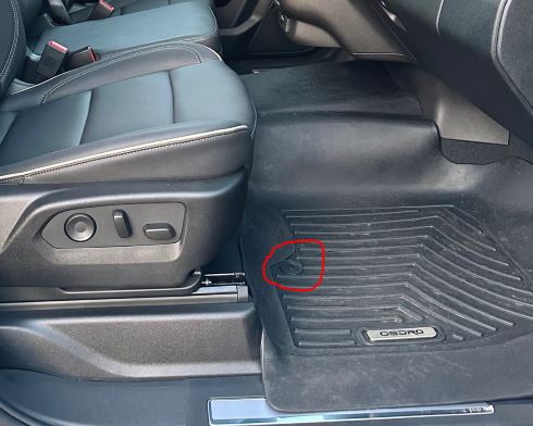

I could not find one piece all season mat for Suburban/YukonXL with 1st row bench, so I bought a set for Silverado 2019-2022 and it fit, it's a little lose on the hump, but works good.
I also added a clip to front Silverado one piece all weather mat because only drivers side had clips and the mat didn't have anything for front passenger side and it moved around (the oem front passenger side does have a clip, so I only had to add the female portion of the clip to the Silverado mat. The kit came with extra replacement clip so I used one and installed it and now the mat holds good on passenger side. (see pic)
I bought a set of "OEDRO Floor Mats" on Amazon for Suburban/YukonXL and also a set for Silverado to use the front mat from pickup truck: "OEDRO Floor Mats Compatible with 2019-2022 Chevrolet Silverado 1500/Sierra1500 Double Cab with 1st Bench Seats"

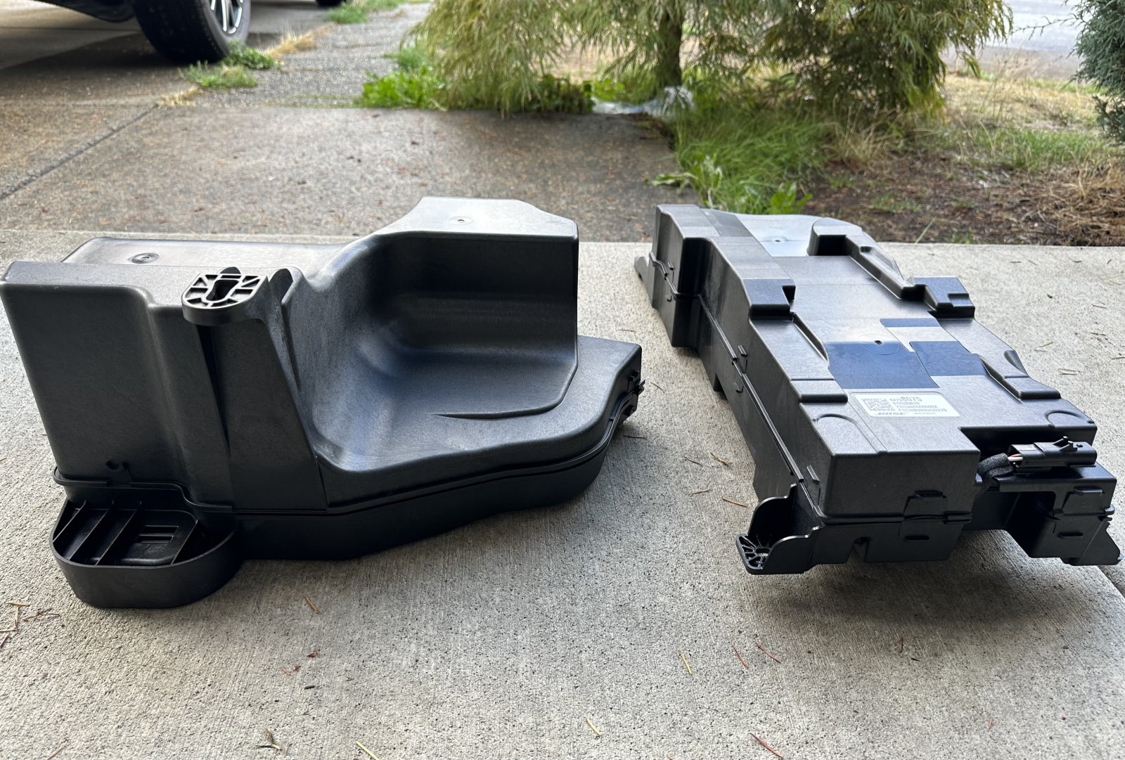

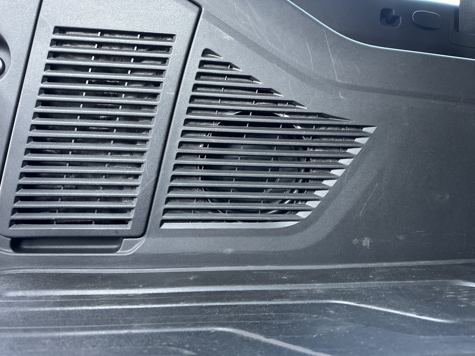

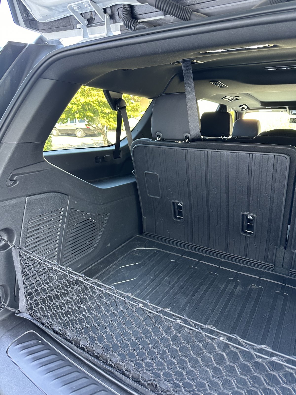

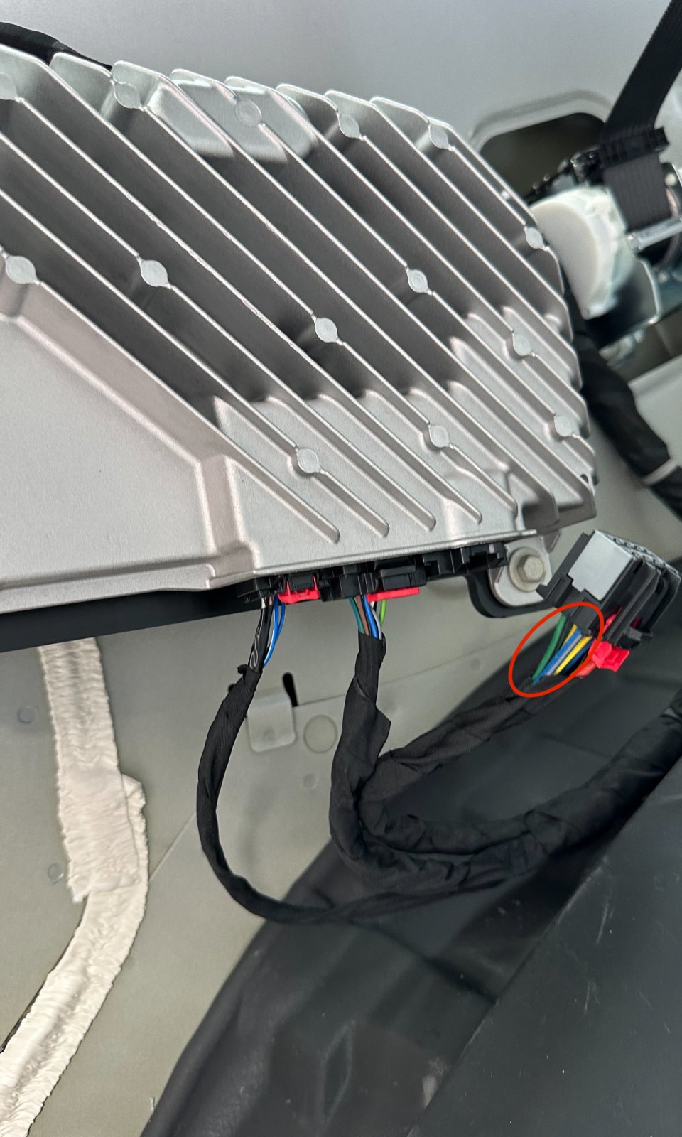

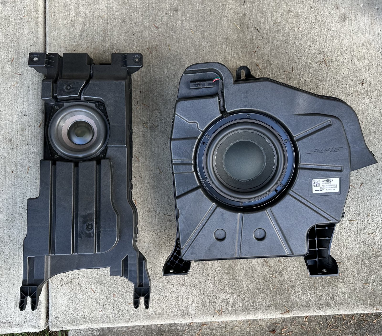

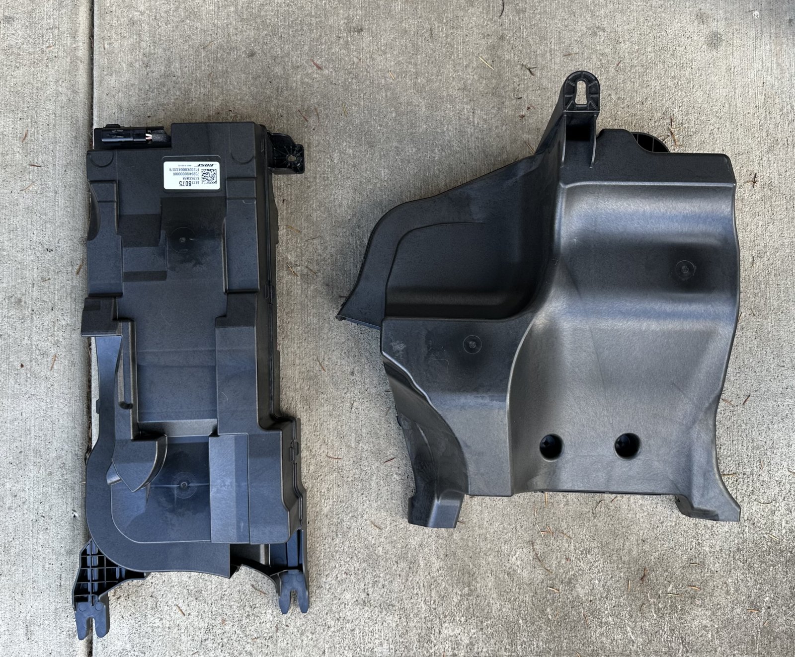

Update on my 9 seat conversation, to Bose OEM subwoofer that had to be removed from under the console and does not fit under the jump seat. I was thinking to extend the wire and place it somewhere in the trunk area inside lower storage area, but it was too tall to fit there. So doing some more research I figured out that I can try to get an oem Bose subwoofer from YukonXL Denali that sits behind passenger rear side trim in the trunk. So I ordered it, and today I plugged each one to see how they play and the one from Denali sounds better even at lower volumes. I was worried that because it is a larger sub it may need more power and that Denali 13 speaker Bose probably has more power than my 9 speaker Bose system. Anyways, should be installing it this week. Very happy to gain the bass back! (See pictures of each to compare)
Final pics: (instead of running the sub wire from front console, I noticed that Bose amp is in the back next to sub location, so I tapped into it)

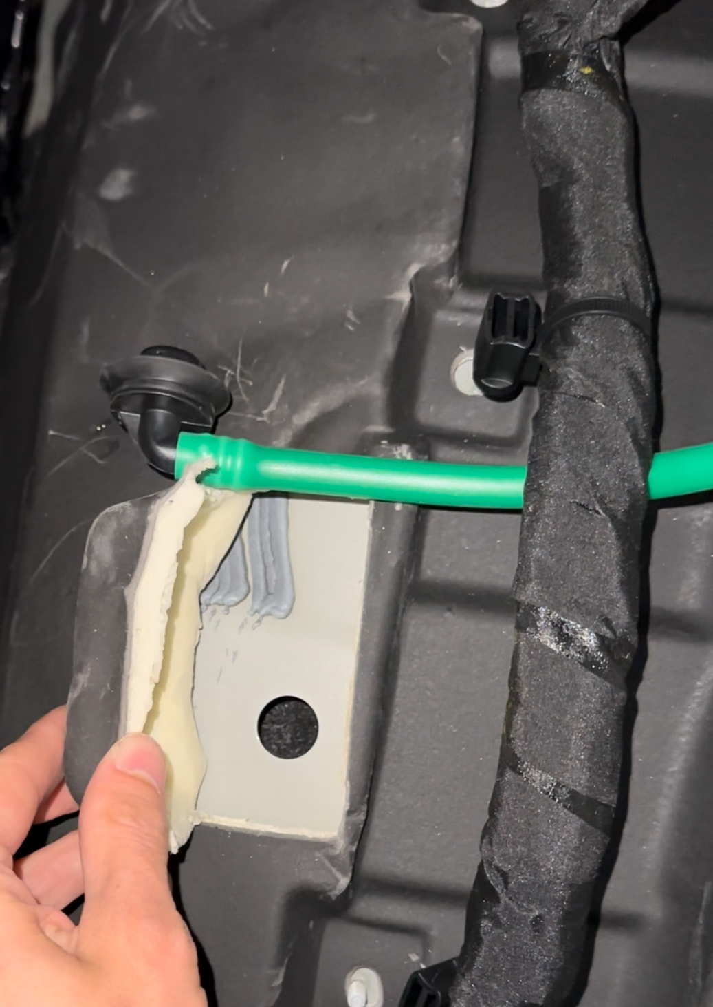

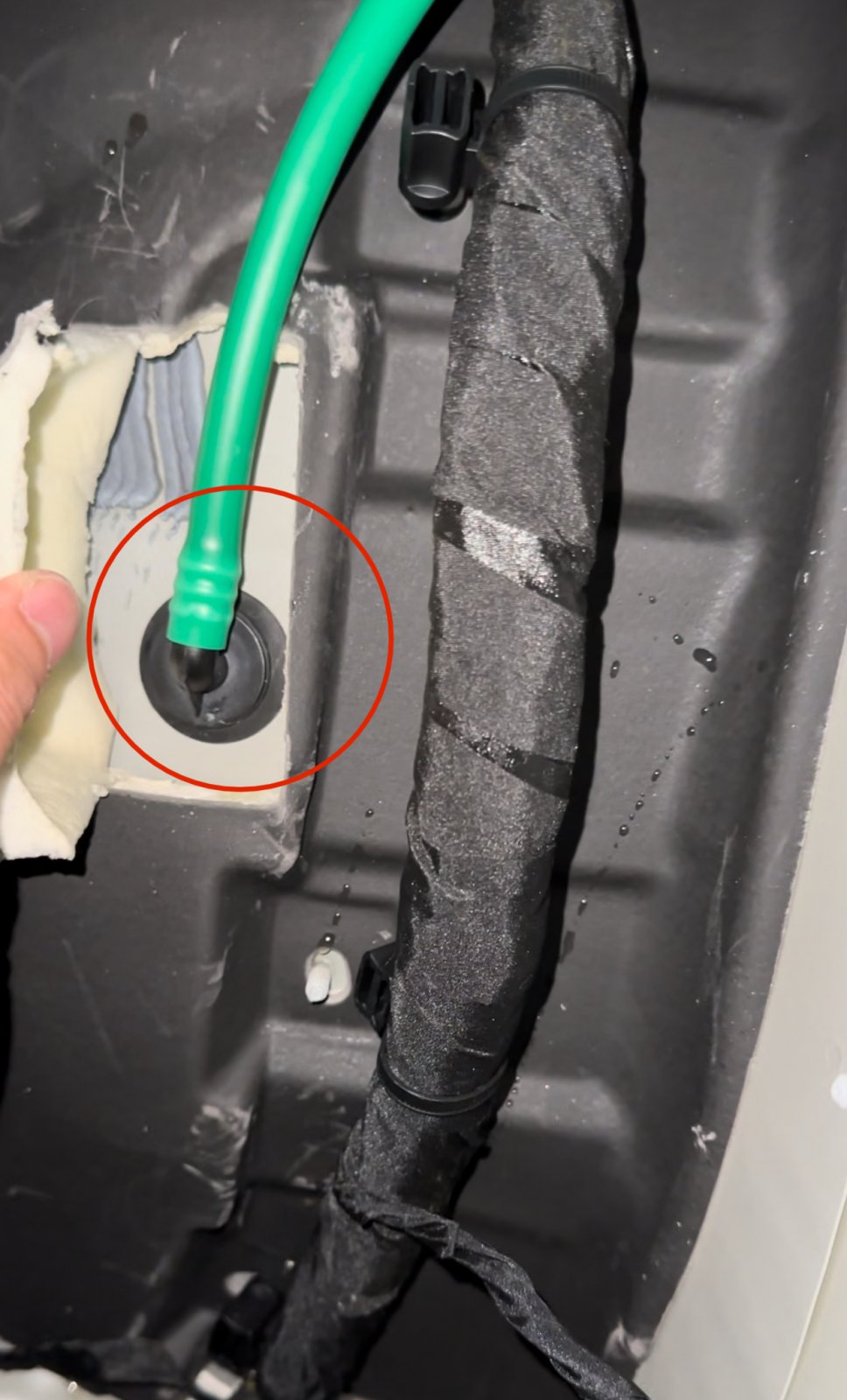

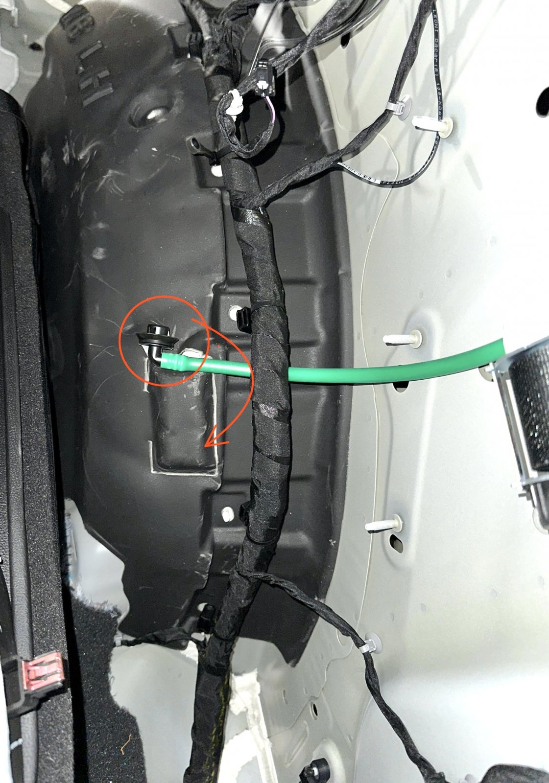

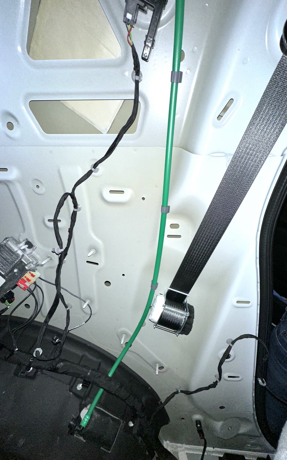

Also, when I had left rear side panel removed, I noticed that the green sunroof water drain hose was not installed and was just laying there… even two clips that holds the hose along the pillar was also not pushed in. See pictures. I installed all clips and plugged the hose into the drain hole. See pics. Now just wondering if the right side has same issue…? (On my 2021 Suburban RST diesel that I sold, I had water leaking inside passenger front side during rain and had it repaired by a delaer… looks like they assemble them quick and sloppy)
