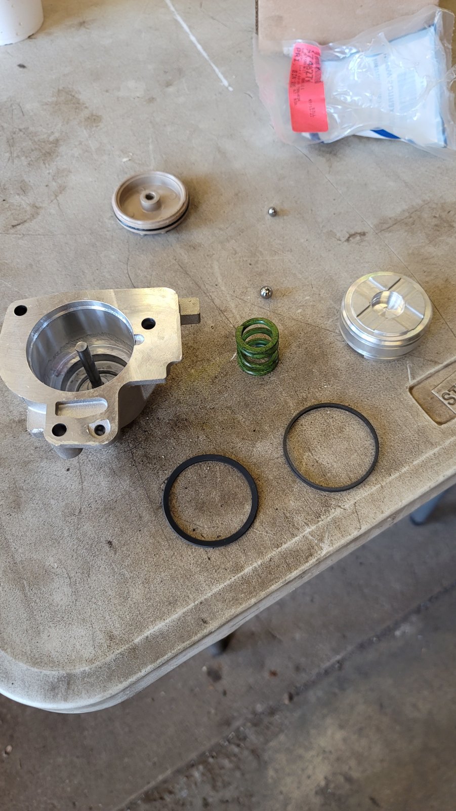

Well I went and ordered a new 1-2 accumulator from gm and the sonnax pinless accumulator. I got them in today and when I pushed the plastic piston out to install the new one I found the accumulator only came with the small spring. Every video I have watched on this shows 2 springs in the accumulator 1 small one and 1 big one that sits around the small one. Did I get ******* here or am I just watching the wrong videos? Any help would be appreciated I just want to make sure I have all my parts before I drop the pan

Post a picture of what you have parts wise.
Everything is brand new. I haven't dropped the pan because I only have one vehicle and can't be stuck waiting for parts

No instructions unfortunately. But I bought them separately so as far as the accumulator it should be what ever stock should be. I'm just not entirely sure what stock for an 04 yukon xl denali with the 4l65e is

So you ordered a whole new accumulator housing from GM and only got one spring? I would just order the big outer one if you are worried about harsh shifts. Me, id roll the dice and hope the one in my trans was ok. Then again i like solid shifts, so even if it was broken id probably just hit up a hardware store and look for a spring close in diameter. Just to keep tension on the piston not even really for cushion.
