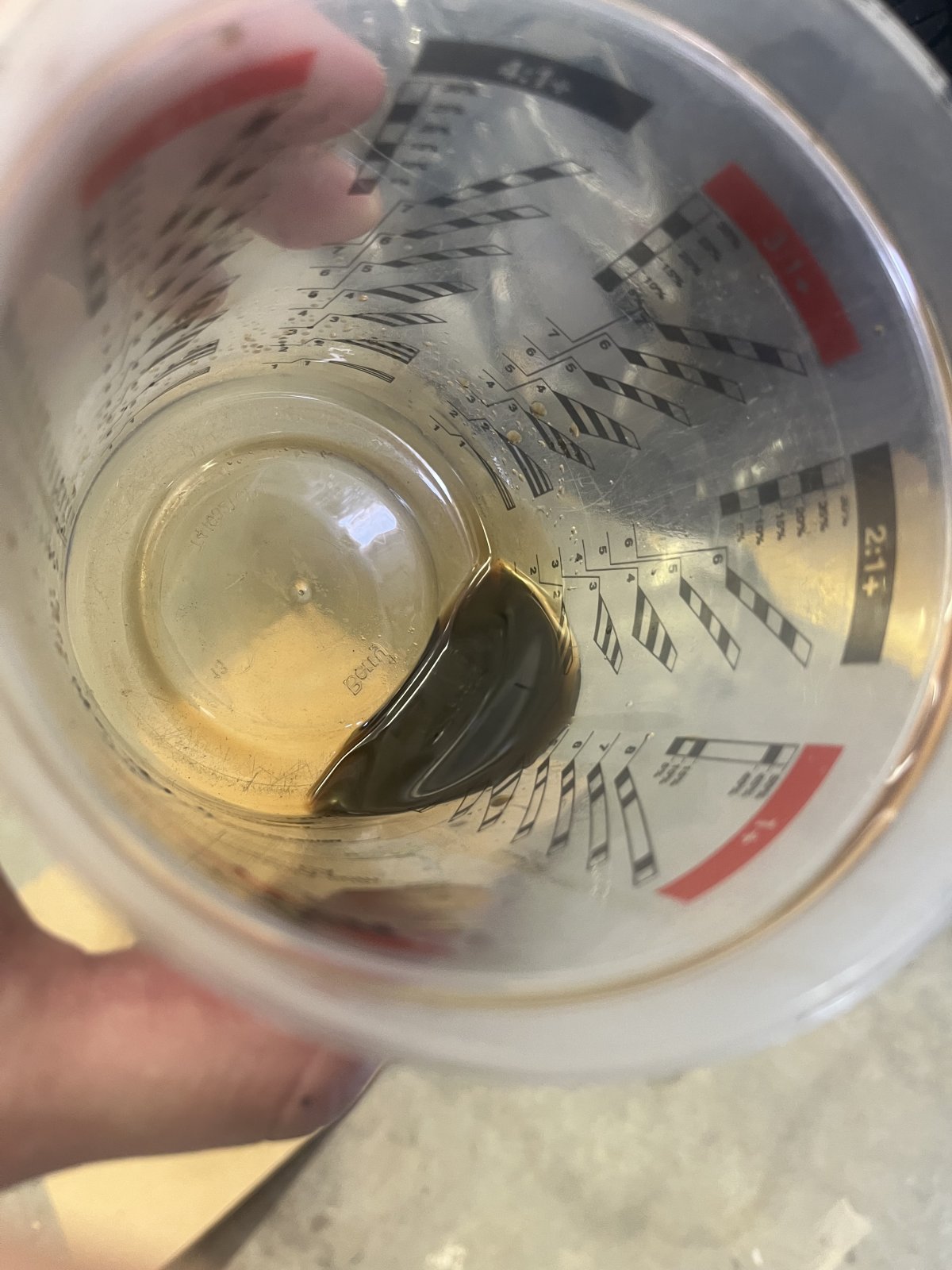

Hello all, just picked up a new to me 2016 Tahoe LTZ with 115K. It was very well maintained and garage kept, but I know its still a roll of the dice as far as the lifters and trans are concerned. I ended up doing a drain and fill on the front and rear diff as well as transfer case. I also tuned out the AFM. Next on this list is address the 6L80, which shifts well now for what it's worth, although the previous owner never serviced it over the 100k they owned the truck. I went ahead and put an upgraded thermostat (GM #85585333) that kicks on trans cooling at 154F, which is working great. It never got over 200F before I installed, but every bit helps from what I understand. I did notice when I changed the part and caught a small amount of the trans fluid, it was black. I am considering doing a drain and fill ( or 2-3 of them over the next 15k miles) to try and freshen up the fluid.
Seeking advice here, is it worth a drain and fill? Is it better to leave it alone at this point and keep my fingers crossed? I don't want to stir up problems but at the same time maybe I can avoid some if it's not too late? If I proceed, is there any value to a "high end" ATF like Red Line's D6 vs standard stuff from the store?

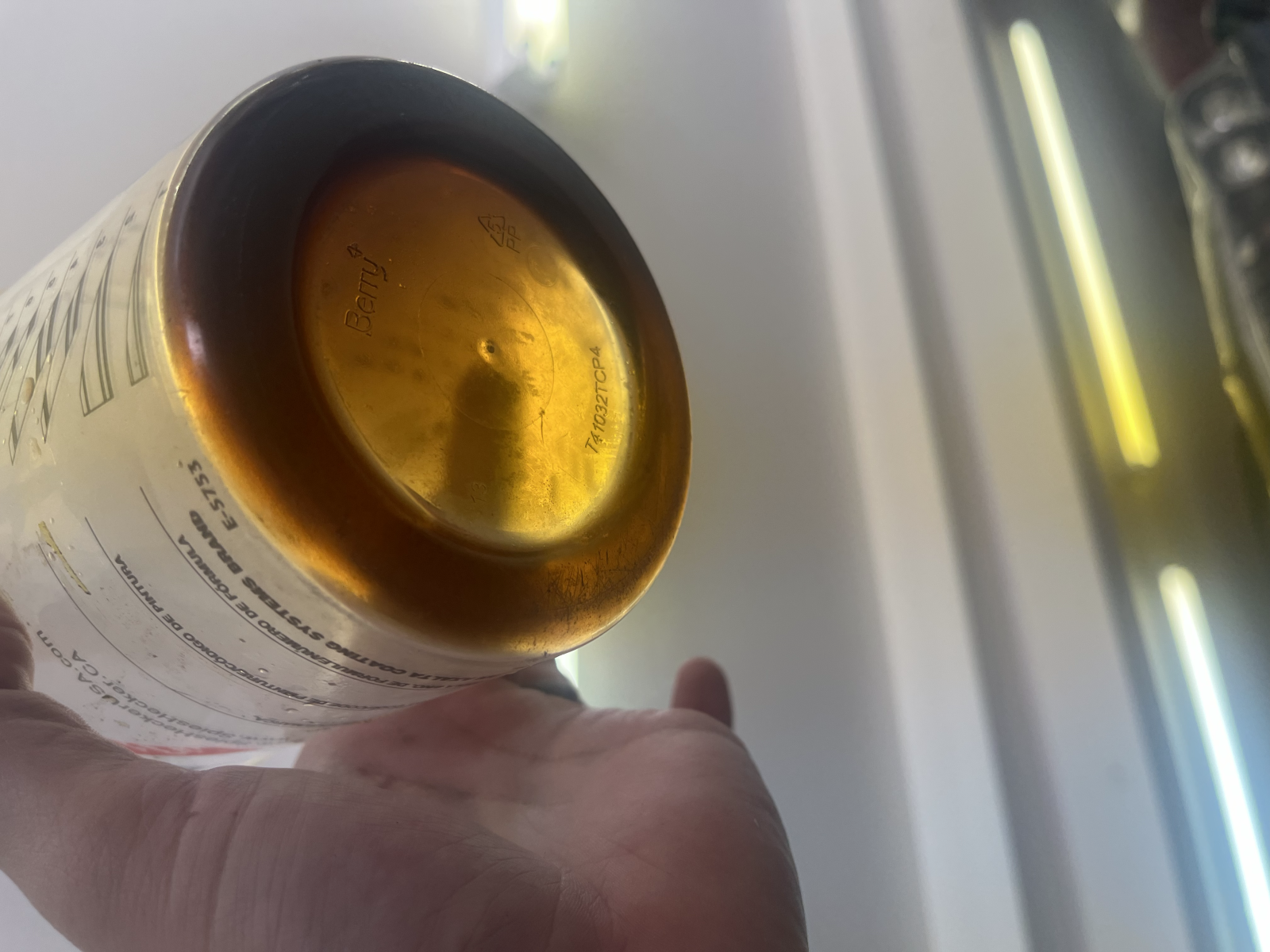

I bought my 2016 LTZ with ~132K miles, but my transmission fluid was still red in color.
I had to replace oem torque convert with one made by LUK. say ~180K miles
It was around ~320 without a core charge.
billet front cover with dual clutch.
It felt like a misfire skip and shudder.
I did transmission oil & filter service probably 6 months before.
I had cleaned the bottom of the transmission pan as well.
also have thermostat delete.
planning on another oil / filter service in the next month or so.
will replace the transmission pan with one that has a plug.
12 quarts for the entire system. the oli / filter was only 4 quarts.
lets just say I buy 3 gallons about every 1~1.5 years.
