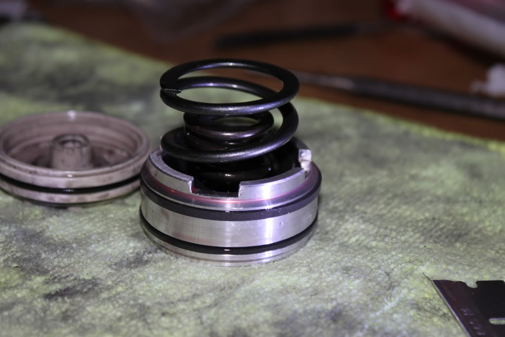

So you ordered a whole new accumulator housing from GM and only got one spring? I would just order the big outer one if you are worried about harsh shifts. Me, id roll the dice and hope the one in my trans was ok. Then again i like solid shifts, so even if it was broken id probably just hit up a hardware store and look for a spring close in diameter. Just to keep tension on the piston not even really for cushion.
Ok so in other words your saying there should be two springs?

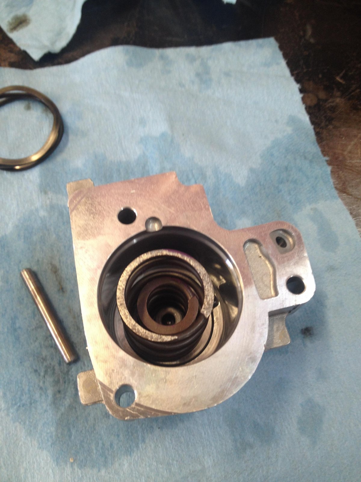

both of these show a large and a small spring

So i would say you need 2 springs. Most people from what i can find, reuse the stock ones. Are yours good? I have no idea maybe not since you have a harsh shift.

There should be 2 springs (big and small). Usually the old bigger one is busted in half which causes the hard shift. Replace it and dont goto the damn hardware store and just stick a spring from there in there. Stick what is designed and suppose to be in there.
Why not? I used a bunch of washers to space my short spring and a chunk of pipe where the big one goes.
