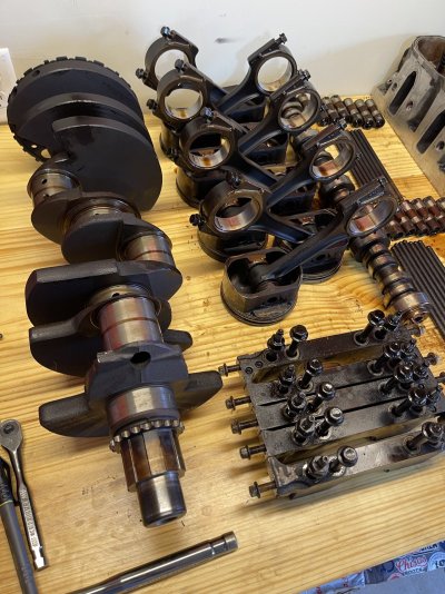

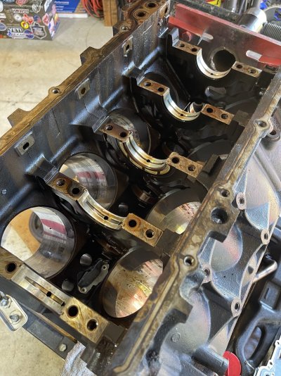

Got the 6.0 torn down and I’ll get it to the machine shop soon. I decided a forged crank would be good insurance… and since I was already doing forged rods/pistons, it made sense (in my mind) to go ahead and do a 408. So the rotating assembly is on back order… And since I’m doing a 408, I decided it would be best to go with 823 heads instead of the 317s. Found some on marketplace that I hope to have soon.
I’m not sure I’ve been more excited for anything in my life. Possibly equally, but not more.

How bad are your cam bearings? Or do you subscribe to the "as long as I don't look, they're fine" mantra?

They seem to be in pretty good shape, but I’m replacing them. A few months ago I ordered the cam kit from Texas Speed, but that was for the 6.0 with 317s. I called and they’ll just exchange for the right cam. They make one for supercharged strokers so that should be ideal

It's interesting how they sell "packages" for all sorts of different engine upgrades (N/A vs. turbo vs. supercharger), but the dyno testing usually doesn't show any difference or significant gains per dollar for special boosted applications.. Head flow, ring gap, and good exhaust flow are the big ones.
I'm no expert, but it's just interesting to see the shift in understanding as more people share their dyno experiences.

Yeah I’m definitely no expert either, so I’m just deciding to trust the experts. I’m sure a bunch of it is just marketing too.
