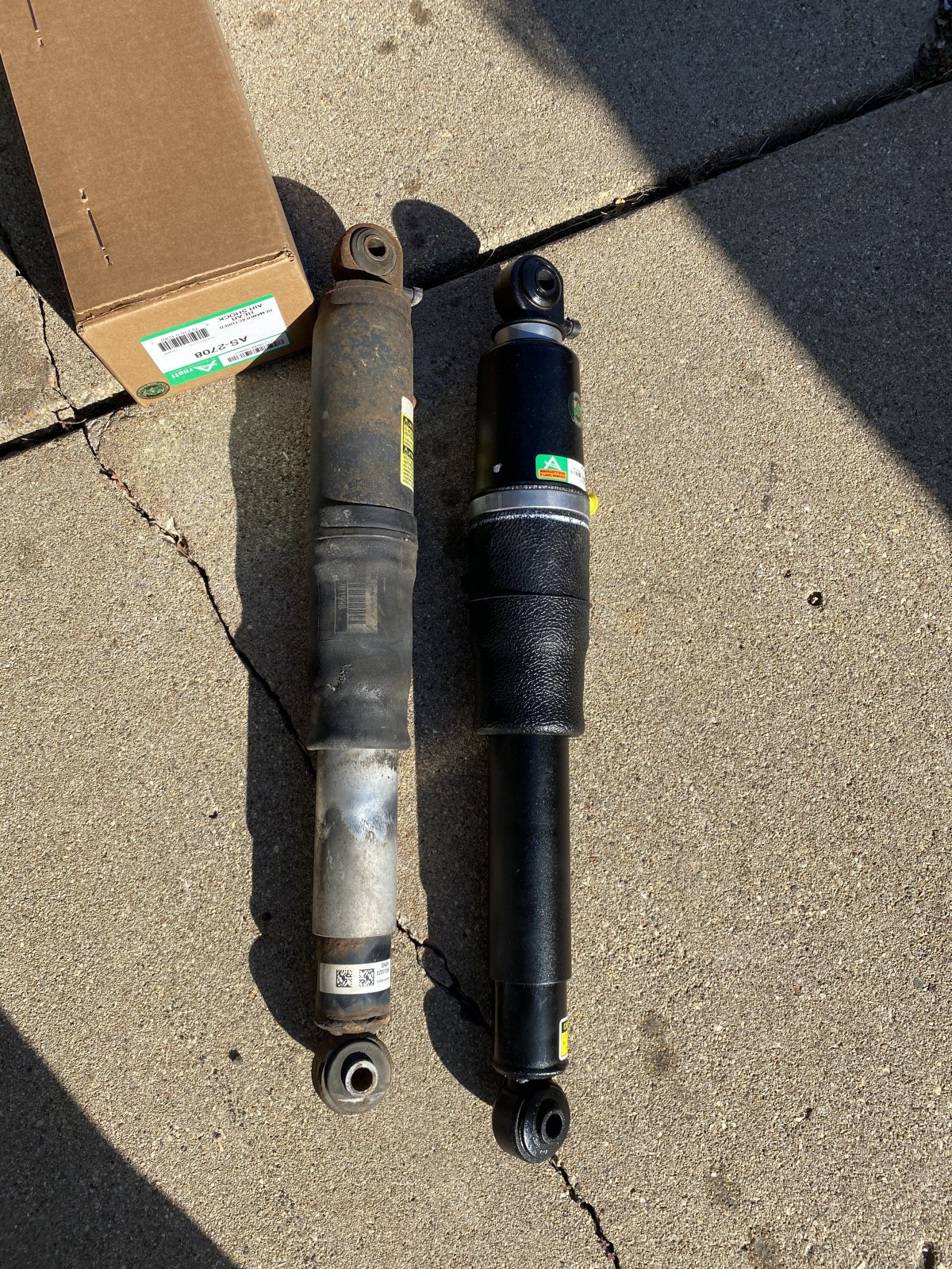

Swapped out rear shocks with a pair of Arnott AS-2708’s. The old one in this picture was leaking.
Was able to remember to check my ABS connections before buttoning everything so I didn’t have any Stabilitrak or Traction Control error messages.
Here is the nice reminder that Arnott includes with their shocks.

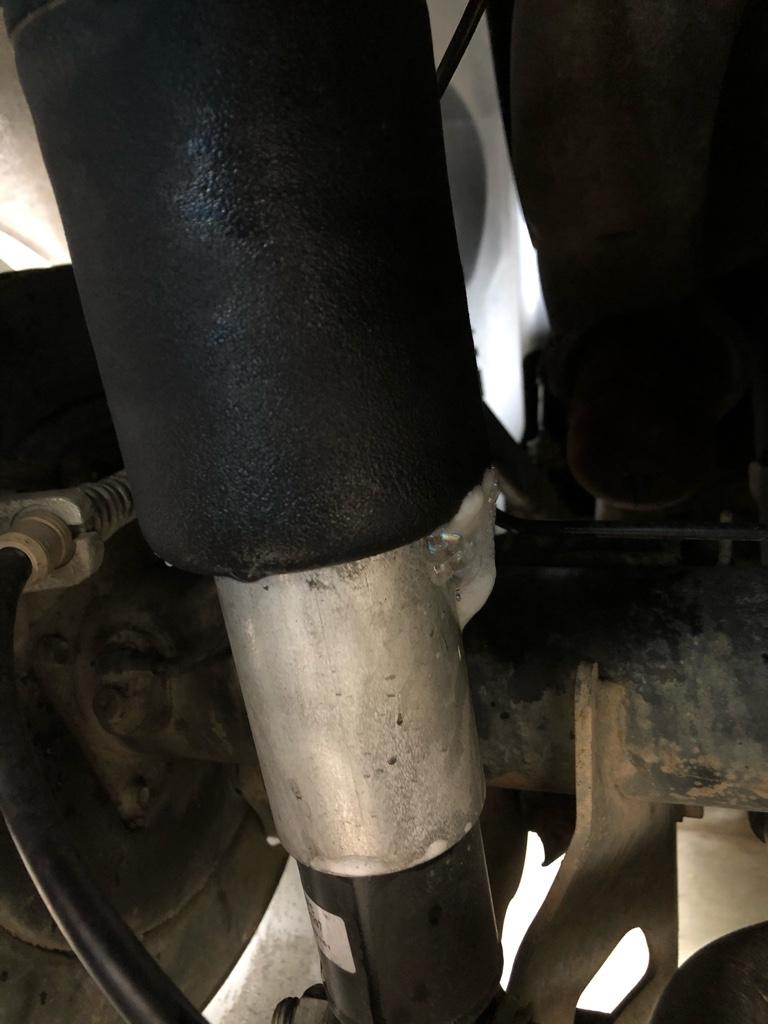

Looks like I’ve got to do the same. Both are leaking on my Suburban.
Are the Autoride (Z55) and Magneride (Z95) rear shocks interchangeable?

Just to give you a heads up, the bolts take a 21mm socket.
I kept the rear tires on, but did end up pulling the fender liner on the passenger side.

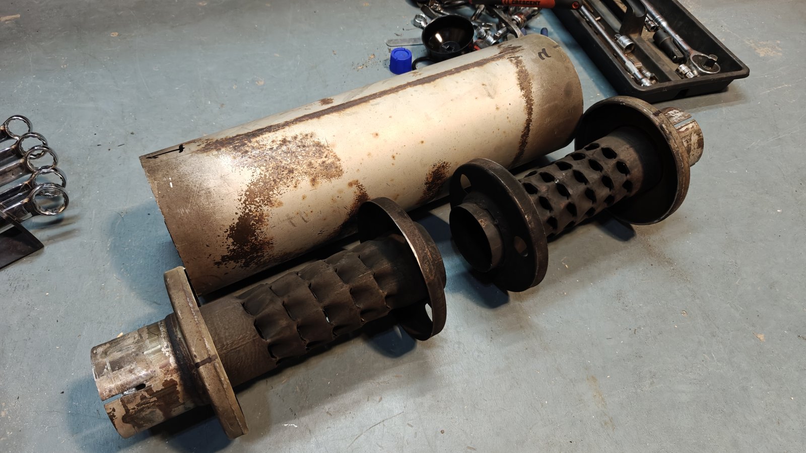

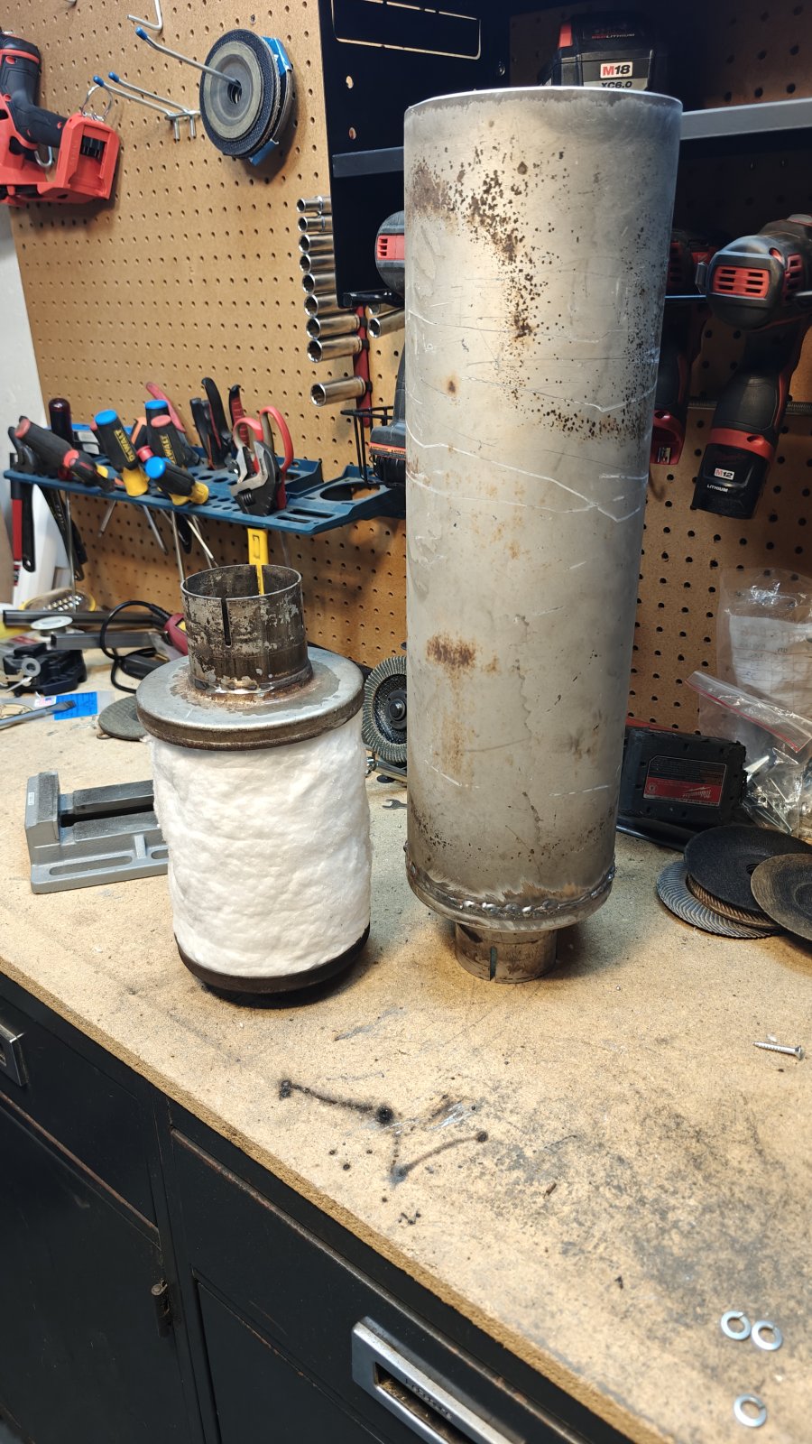

Catback? I like it. Not too aggressive.
Pretty much custom pieced together. Ive cut and had 8 different set ups on this and it shows. Performance curve catback kit, i bought the one without muffler and ordered my own muffler.
I can't find the listing without muffler right now. But was from seller:performance-curve on ebay.
