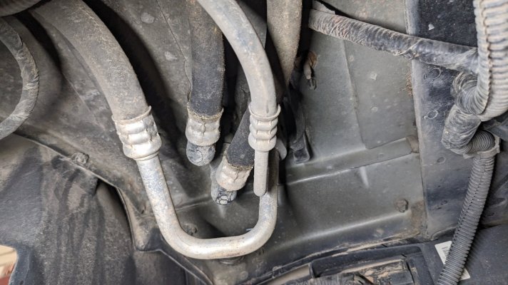

while under looking around, you guys ever hear of the rear heater hose quick connects breaking? cause mine look pretty horrible and it looks like there's not a split, they run all the way to the front? ugh.

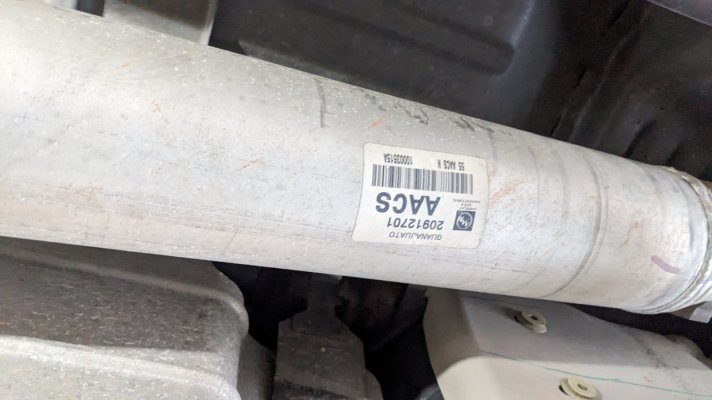

oh and I have a 4in aluminum drive shaft, don't know where gm meausues from, but tip of ear to ear is 41in.. I guess it's stock? don't know if it's would fit anything else but these odd ball trucks.

I was honestly wonder if I can just cut the pipe, flare it some and stick some fresh heater hose over it and clamp.
but I also can't say I've ever seen a thread about them leaking and I hate to fix things till they are broken haha.

If you mess with them, you’ll need right angle quick connects because there’s no room for the heater hose to make the turn from vertical to horizontal if you don’t. I used some Dorman ones because that’s all I could find. Mine were brittle as hell after 21 years, no way they were coming off in one piece. I cut them off with tin snips.Not sure why they weren’t leaking but I recommend replacing them if they’re old. Dorman 800-419 is the part number. The hose will need a couple clamps.I used spring clamps I had laying around.

did you just cut the hose back some or were you able to replace the hose from the metal pipe to the fitting.
I'll order me some of those. I'd hate to do the whole front section and then the back leak.

went and picked up the yukon from the dealer after having the rear u joints and fuel pump done and mf'r is vibrating like a sob.
called them and they said they do not balance the shafts and would have to send it out, so 1st thing Monday i'm going to run it down to the driveline shop
and tell them I need a rush on it already paid for a bunch of stuff for the vacay no time to screw around.
apparently they do not have a QC guy on Saturdays and it was closing time so limped it home even though I didn't want to vibrations f-up the ring & pinion :893Chainsaw-Smilie-:893Chainsaw-Smilie-:893Chainsaw-Smilie-.
They didn’t install the driveshaft upside down after they replaced the joints did they? Best procedure is to balance the shaft, but if you are doing it yourself you can just mark the relationship of the shaft prior to removal.
Could be something as simple as Amateur Hour at the stealership and **** the new guy might have skipped that step.

No other mark, but there is a fresh scratch mark corresponding on the other side but I think I found the problem or part of the problem WTF!
What the actual f*¢k? And this is the reason why I do all of my own work. Negligence and embarrassing attention to detail.
