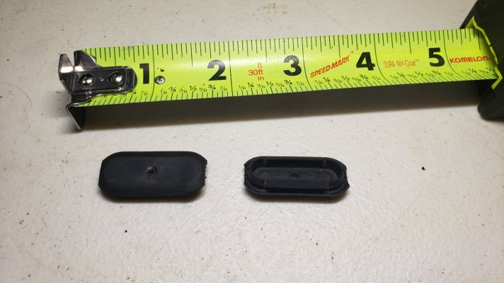

Check your drip weather strips at the rear corner of both rear doors. We just discovered rust bubbling out from under them on both sides. Too much rain to make the repair, I have one gasket and just ordered another and will probably make the repair in November when we get more than one day in a row without rain.
