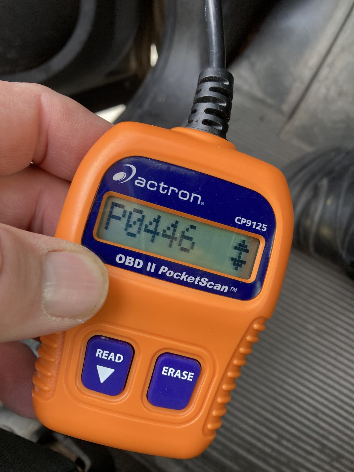

The last couple times I got gas I noticed small pieces of white plastic dropping off from the inside of my gas cap. It also doesn't click anymore.
Guess I'll replace it for good measure. Anyone have a link to the yellow E85 tethered gas cap?
EDIT: Found it on RockAuto for $12. ACDelco GT347
GM OE #20962524
