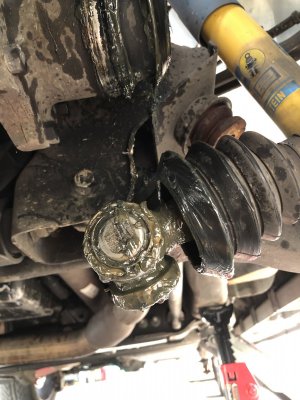

Well hell never mind. So much for diagnosing without an inspection. I just broke a CV joint and tore the boot so I lost a bit of gear oil, nothing major. I ordered a new axle assembly from RA and a couple quarts of oil. I’m kinda embarrassed I didn’t manage to break anything major lol. Weakest link broke instead. I guess I’m lucky.
View attachment 257116 View attachment 257117 View attachment 257118

is the front diff locked up? mine would roller with the engine power, but after i ripped it out i couldnt even spin it by hand

Nah, I actually drove quite a few blocks but the sound of the axle banging around combined with the oil leaking kinda made me stop. Looks like it’s just the cv joint probably from a wot-in-reverse move that I’m sure squatted the front of the truck down and placed the thing at a bad angle and that combined with a bit of power and torque did it in. I heard a bit of tire spin, probably from the rears as the weight transferred forward until the TC moved the power to the front and broke the CV. Every other WOT launch has always been in forward so this was a bit weird. Kinda fun though. I was amazed how well it drove in reverse. @ivin74 i hadn’t even thought about replacing both at 170k but you’re right. I didn’t really want to spend another $280 but I went ahead and ordered a second one. I do have to drain the diff so that’s $50 worth of fluids and I might as well do both at the same time.

Yeah I know right? Well guess what, this just snowballed on me. I was looking at videos on replacing the cv axles and noticed there should be no oil leaking from my diff the way they’re made so I crawled under and took another look. Seems The Beast does have some power after all.
