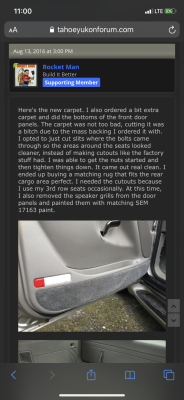

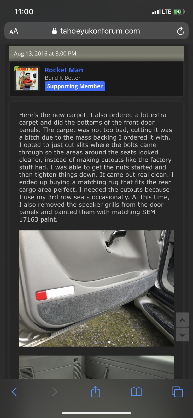

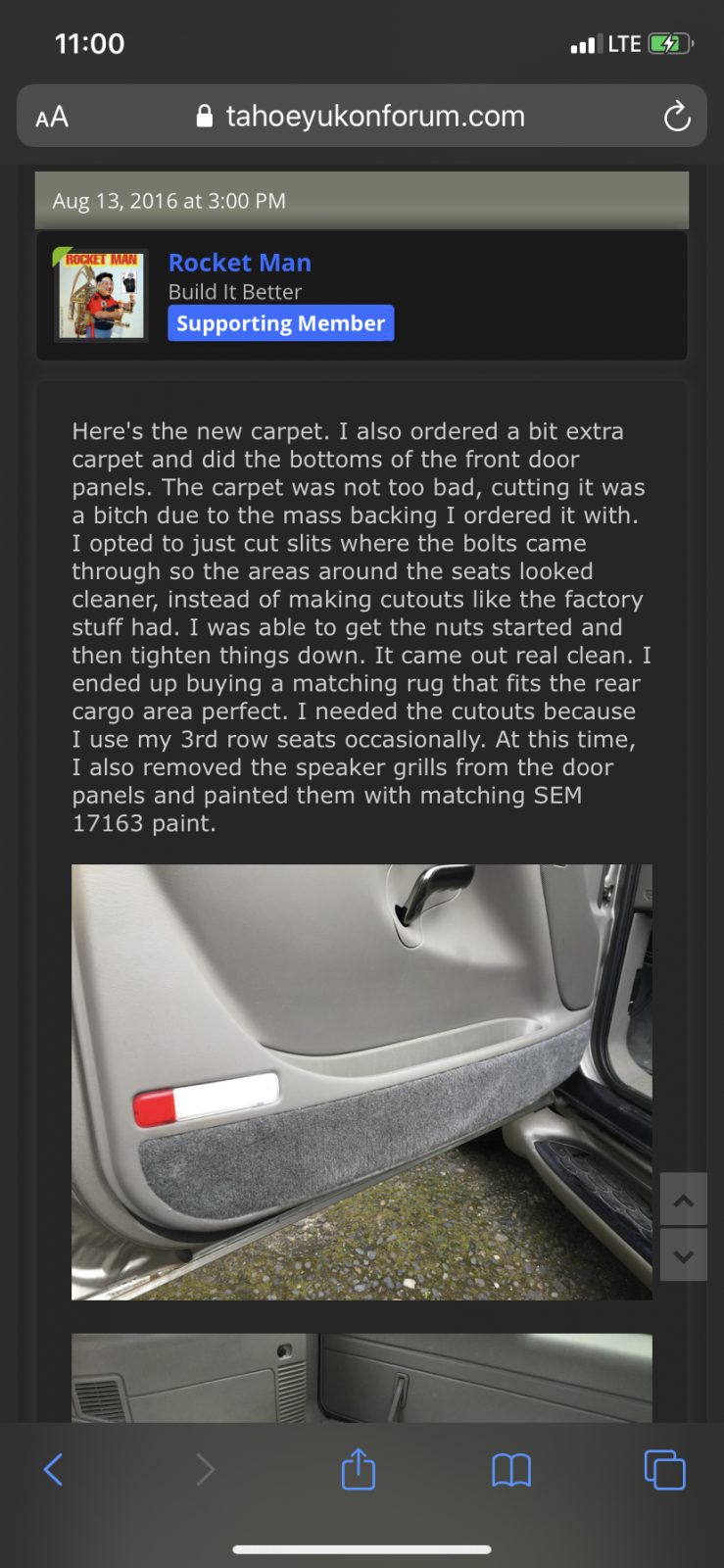

So I was looking for shots of your interior color I seen the part# lol
Great build by the way.

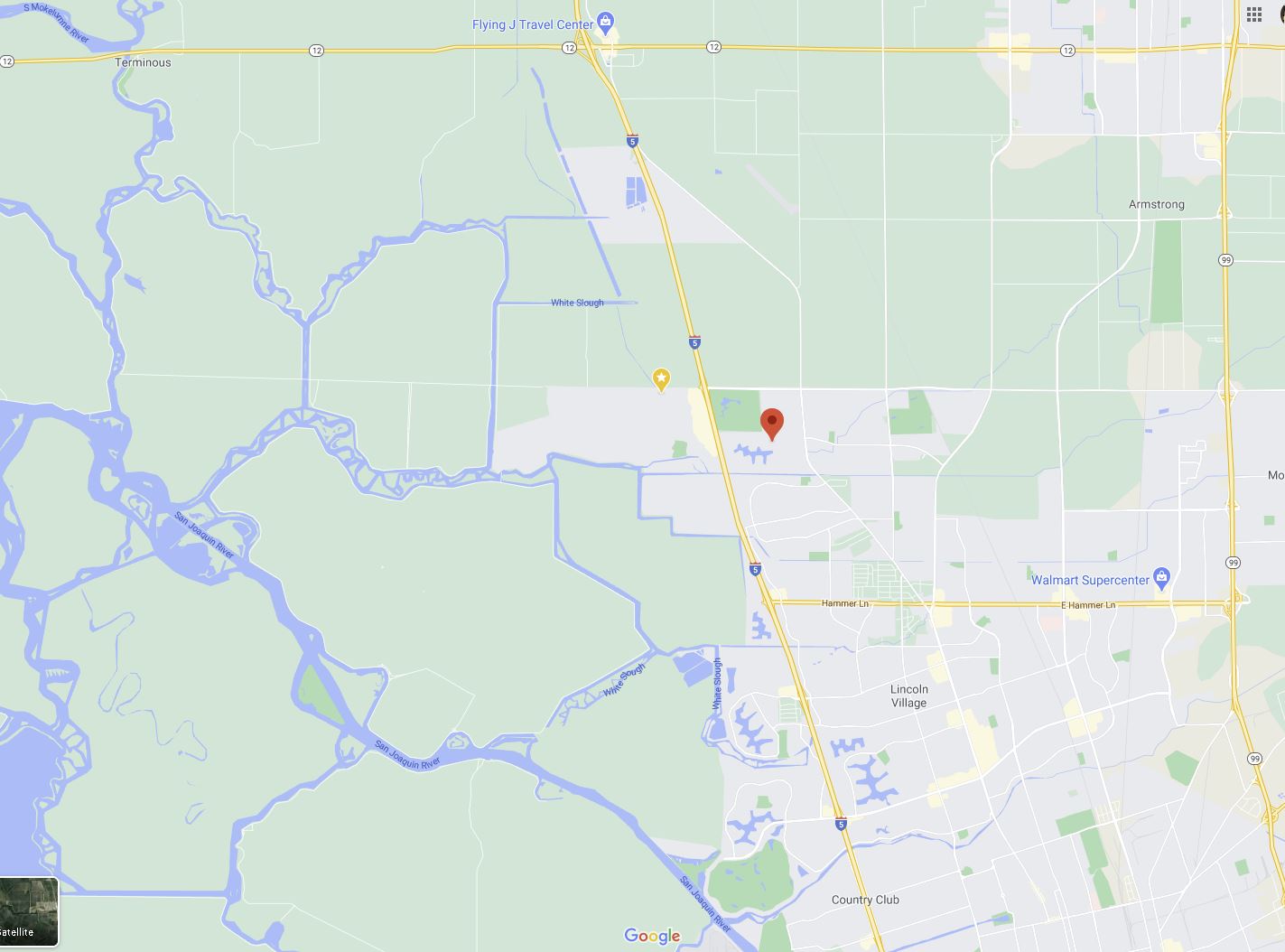

it's just money right? :p, how much forest is around you? around here we are surrounded by farmland and people in the local community sit there and moan about "what if we have to evacuate" ****..... there is literally nothing to burn but farm dirt
30,549
48,003
I live at the star on the map, the west side is all wetland, diverting channel's and farmland, on the east all the squares are farmland, tomatoes, onions, corn, grapes. no forest anywhere
