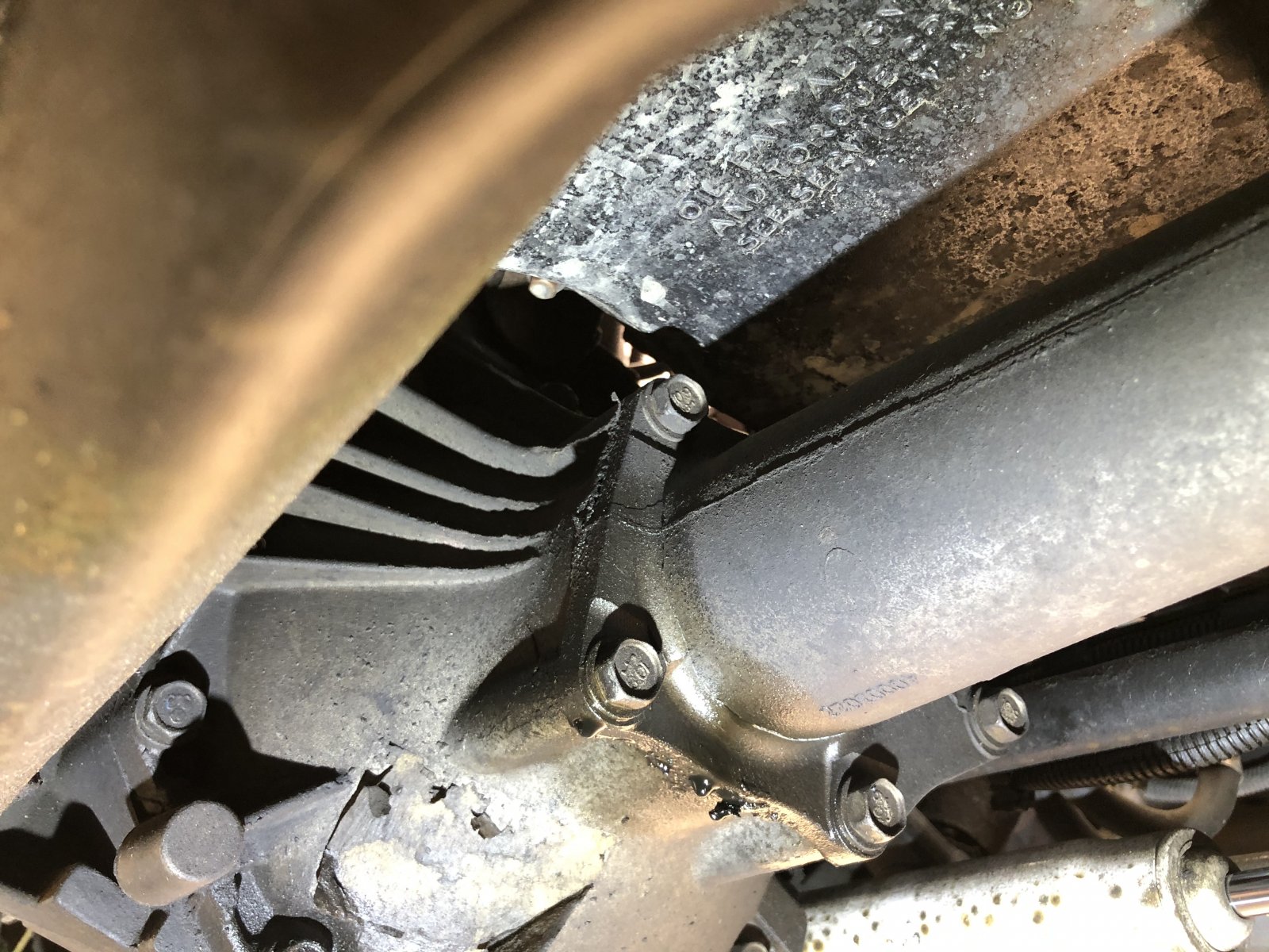

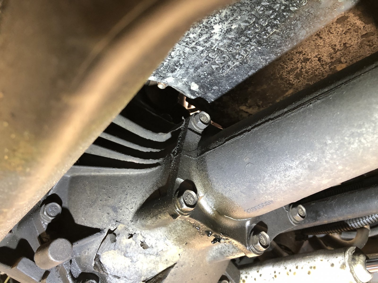

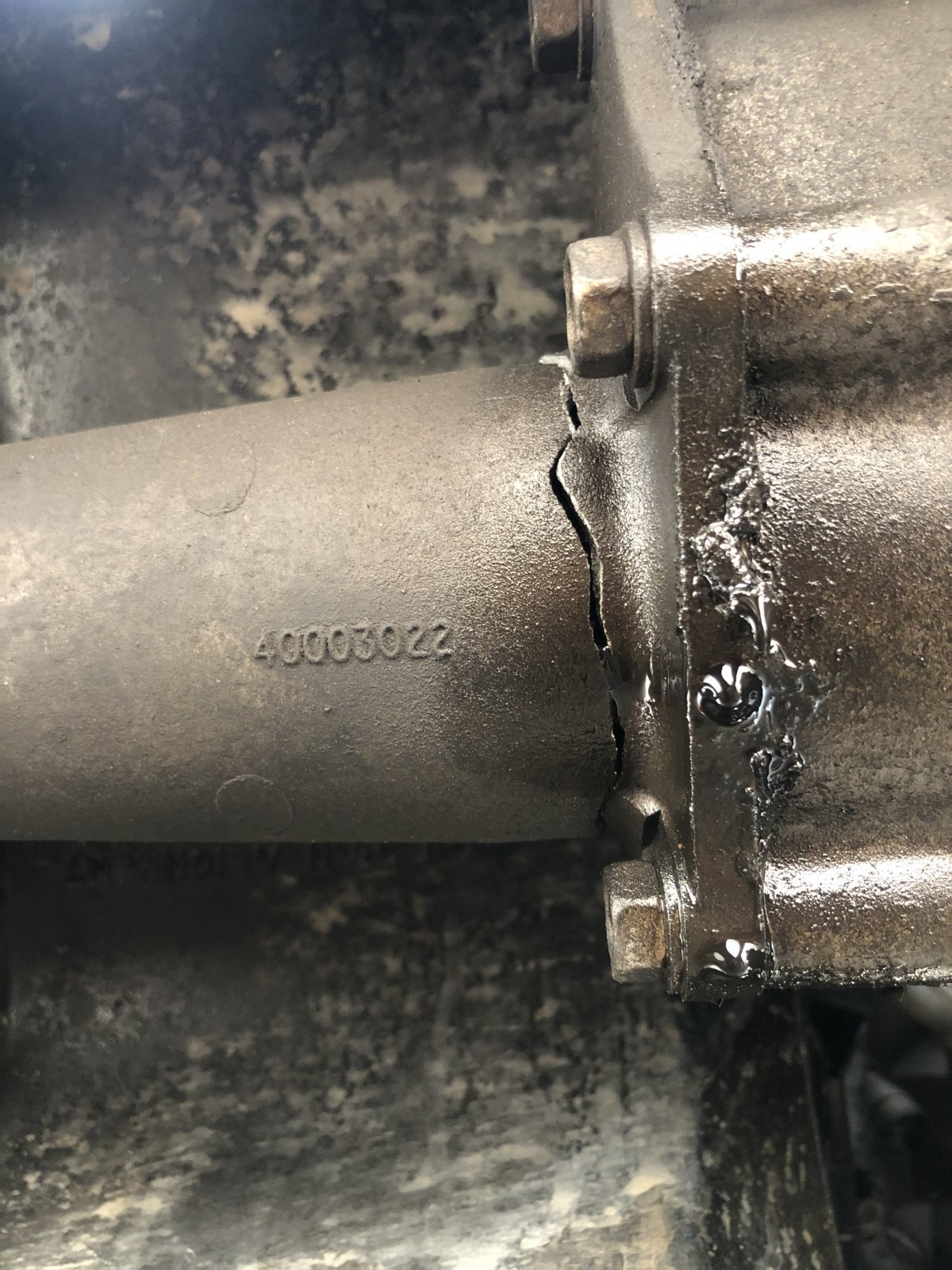

Yeah I know right? Well guess what, this just snowballed on me. I was looking at videos on replacing the cv axles and noticed there should be no oil leaking from my diff the way they’re made so I crawled under and took another look. Seems The Beast does have some power after all. View attachment 257153
Oops! Maybe you can just replace the extension housing along with the CV.

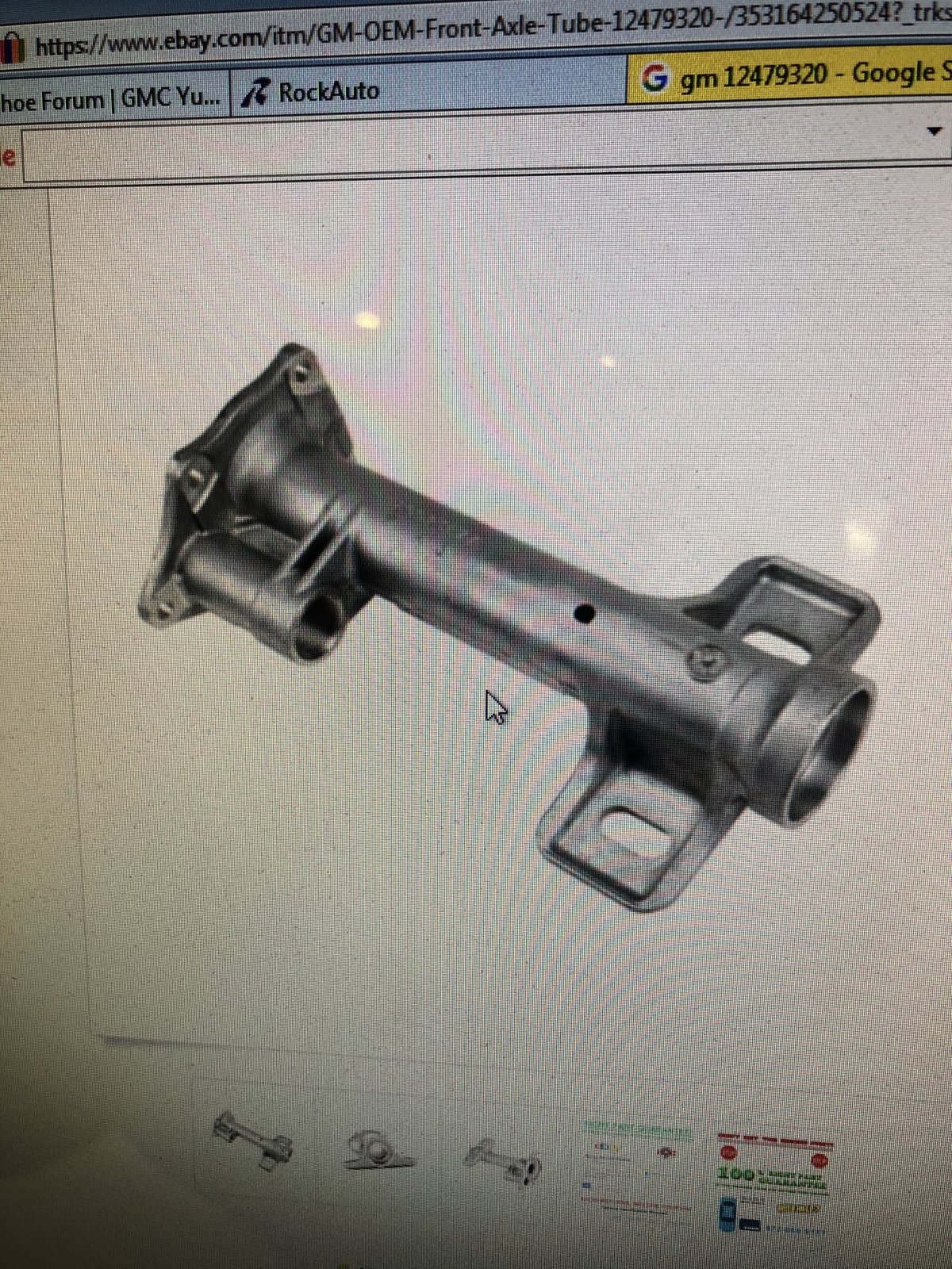

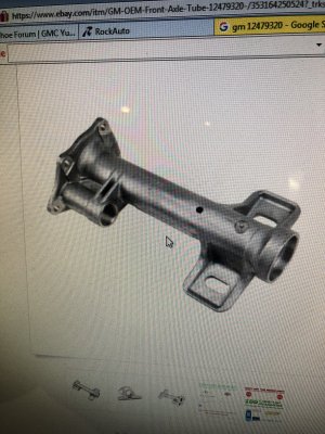

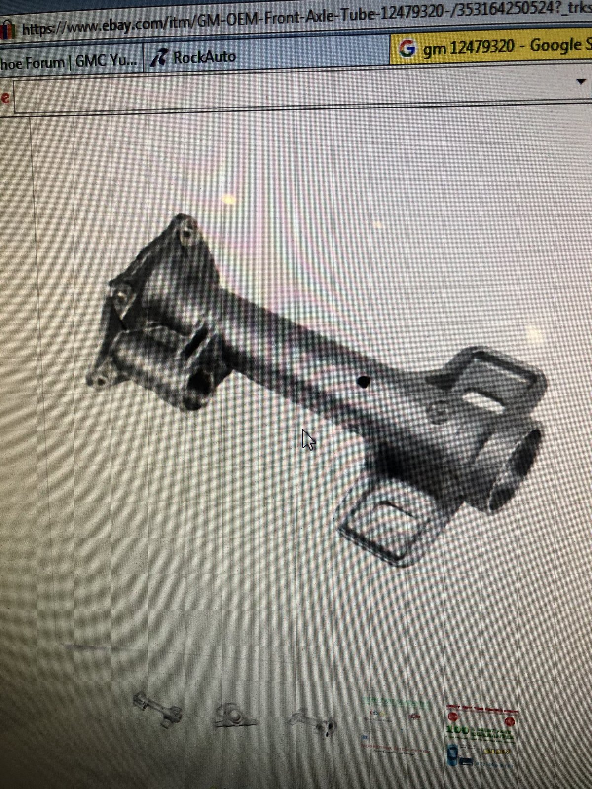

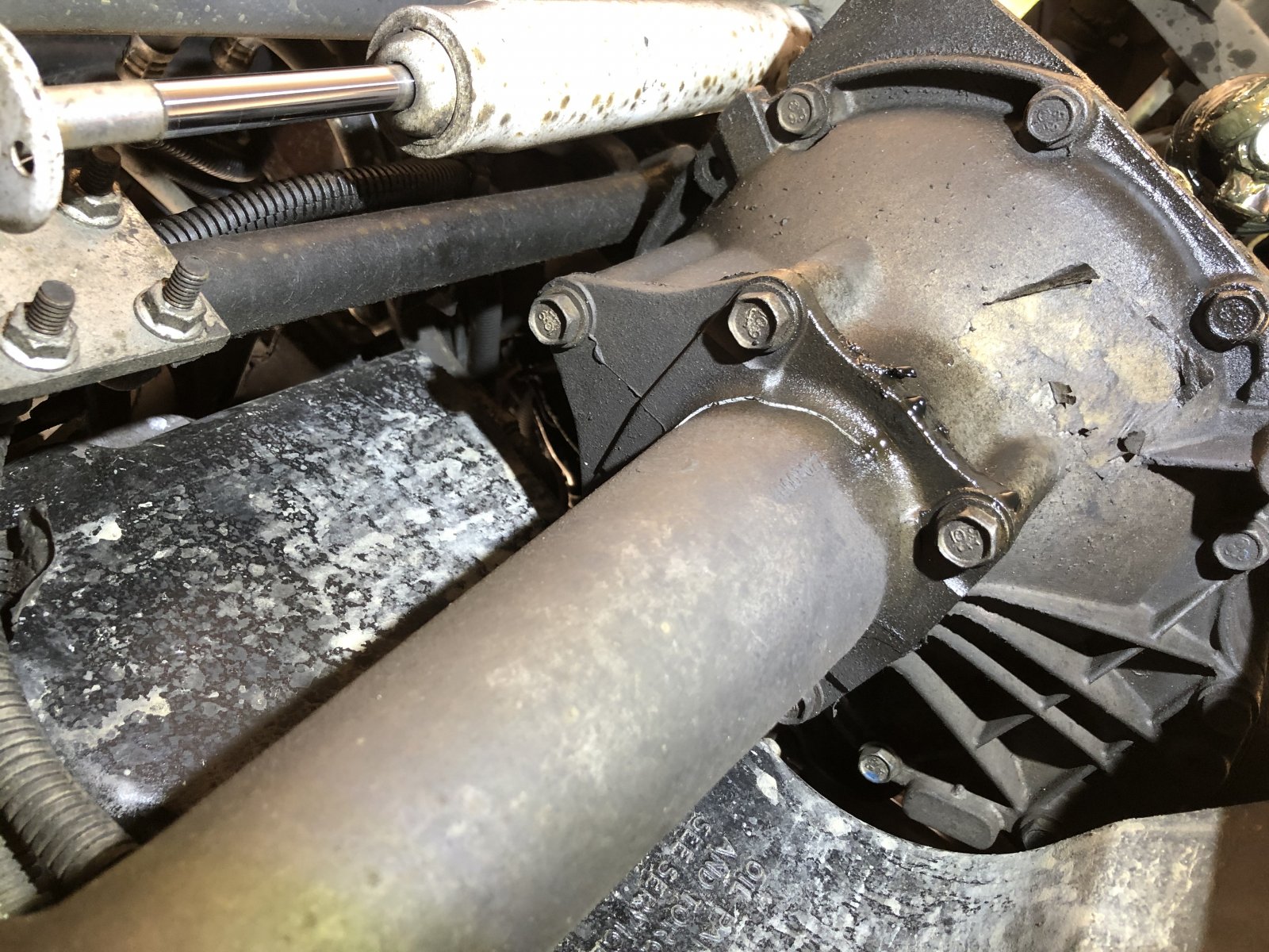

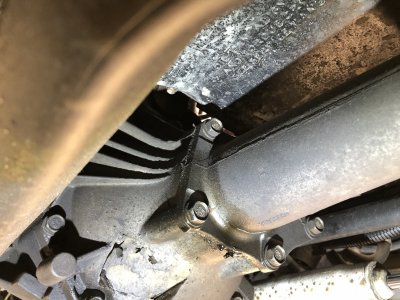

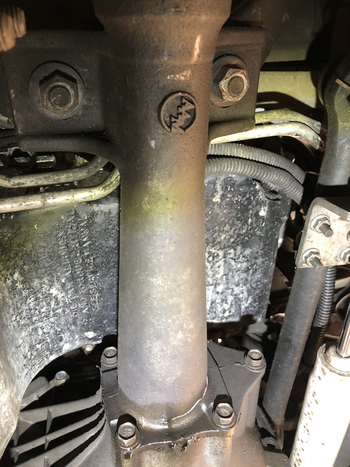

Crap, now I can’t find the part number for the axle housing. I hope I don’t have to buy the whole diff. @915_Tahoe can you help a brother out? Last 8 of my VIN is 2J105097. I need the right axle housing but when I look it up on gmpartsdirect it shows 12479320 for non AWD or 12479295 for Crew Cab (?] even though I’m under parts listed by my vin. Neither looks exactly like mine, those both have around part that mine doesn’t have.
52,956

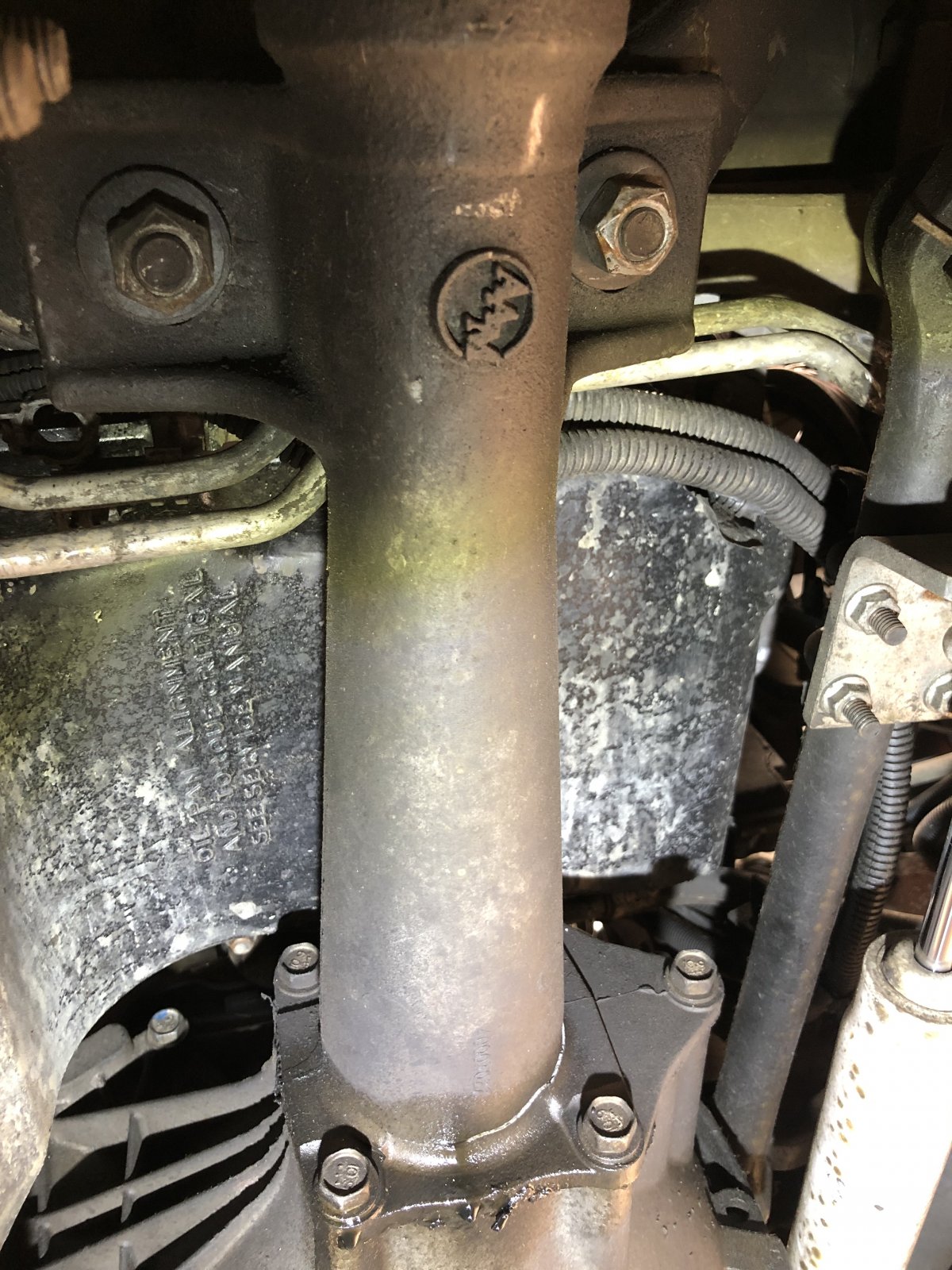

Here’s my axle tube.

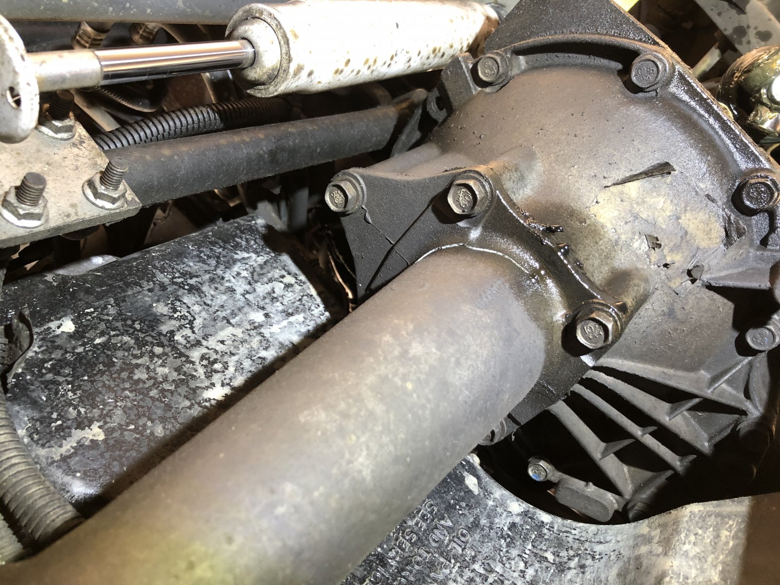

FB8C9DE4-5D63-4429-BEA8-590E75684BDC.jpeg 051F52DC-B751-4BE8-A97D-0A9F0A3F089A.jpeg 61CDC2B1-BB60-4AA8-989D-CB8CADA77057.jpeg
52,956
Here’s the one that shows up on parts lists but some say not for AWD. I’m thinking there’s just a design change to add reinforcement.

Are you sure? There should only be the housing and long stub shaft on an all wheel drive unlike the part time units with the actuator, fork and related parts.
52,956
That one has the spot for the actuator. the one you need is like this one.
https://www.ebay.com/itm/01-06-ESCA...ront-Differential-Axle-Tube-AWD-/274427311040
I can’t find the p/n for a new one. I’m kinda worried that I did more damage to the diff that I can’t see and after spending $300 on parts since I need new bearings, seals, etc I put it back together and it’s still messed up. IDK. $225 shipped for a used axle housing is kinda high. I don’t want to spend $800 for a new diff either but this has 170k on it. Might have to bite the bullet.
52,956
I guess that’s it, just bearing seal and dust seal I think but idk if the diff is messed up either. The new diff comes with everything.
52,956
And it’s $328 plus shipping just for the tube, then I need seal and bearing so more like $400 shipped for everything vs $800 shipped for a rebuilt diff with 3 year warranty with axles included. Thanks for finding that but like I said I don’t know how long the diff will last. If I broke the cv joint on one side and the axle tube on the other, that diff went through some stress for sure so I’m thinking there might be more broken parts inside or they are weakened and will break down the road. Just kind of on the fence here. I’m a bit nervous that I over stressed that diff and it’s not going to do well down the road.
