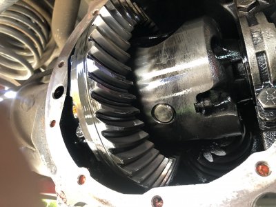

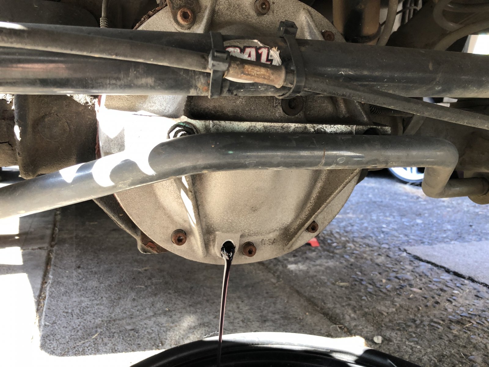

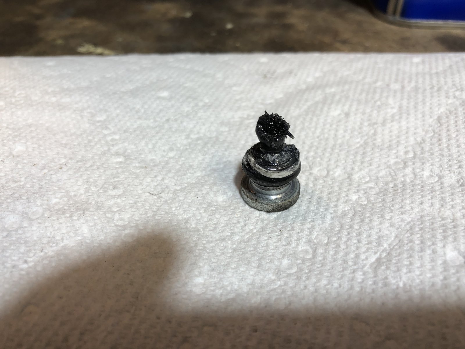

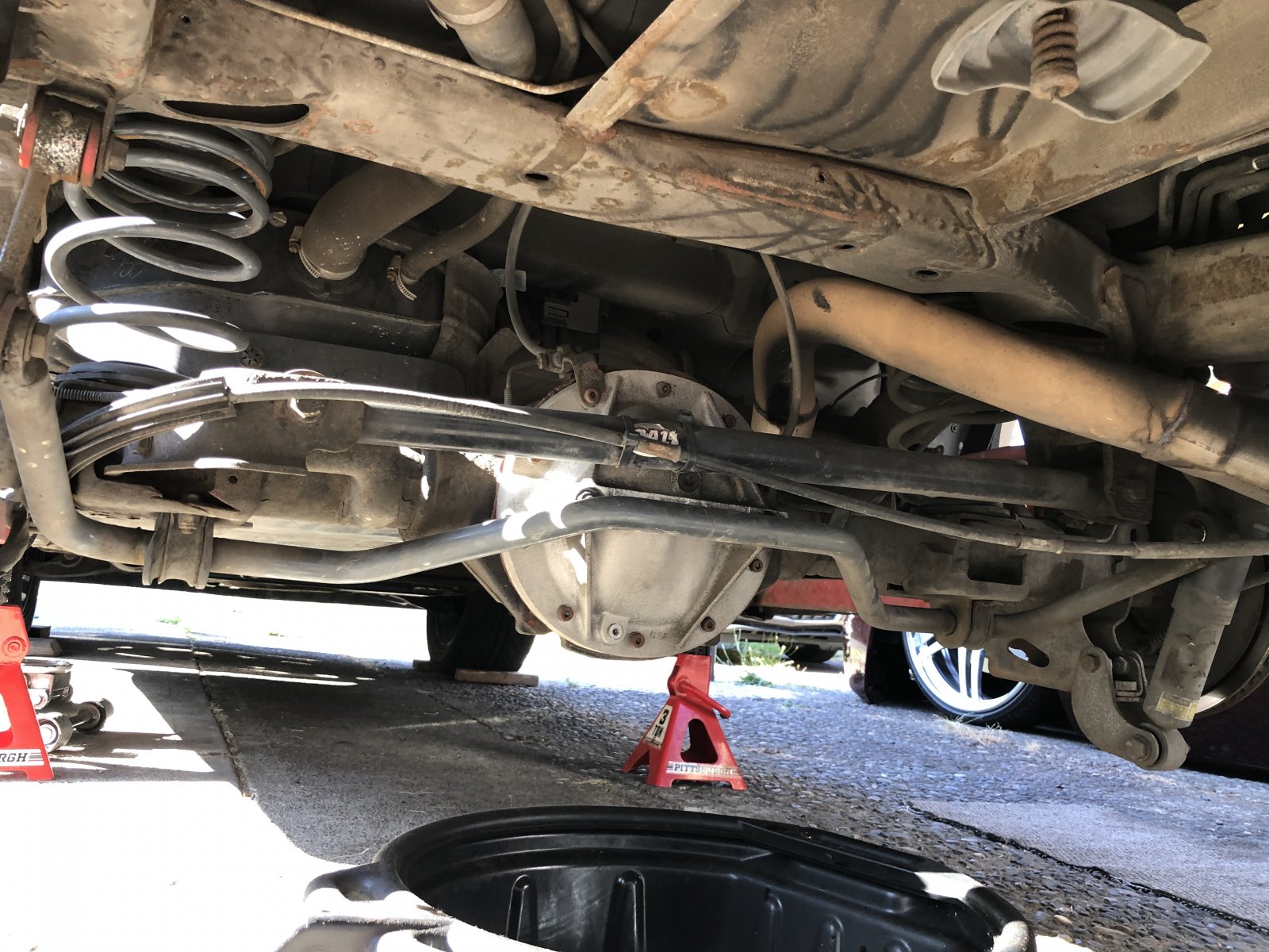

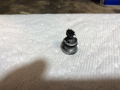

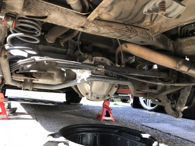

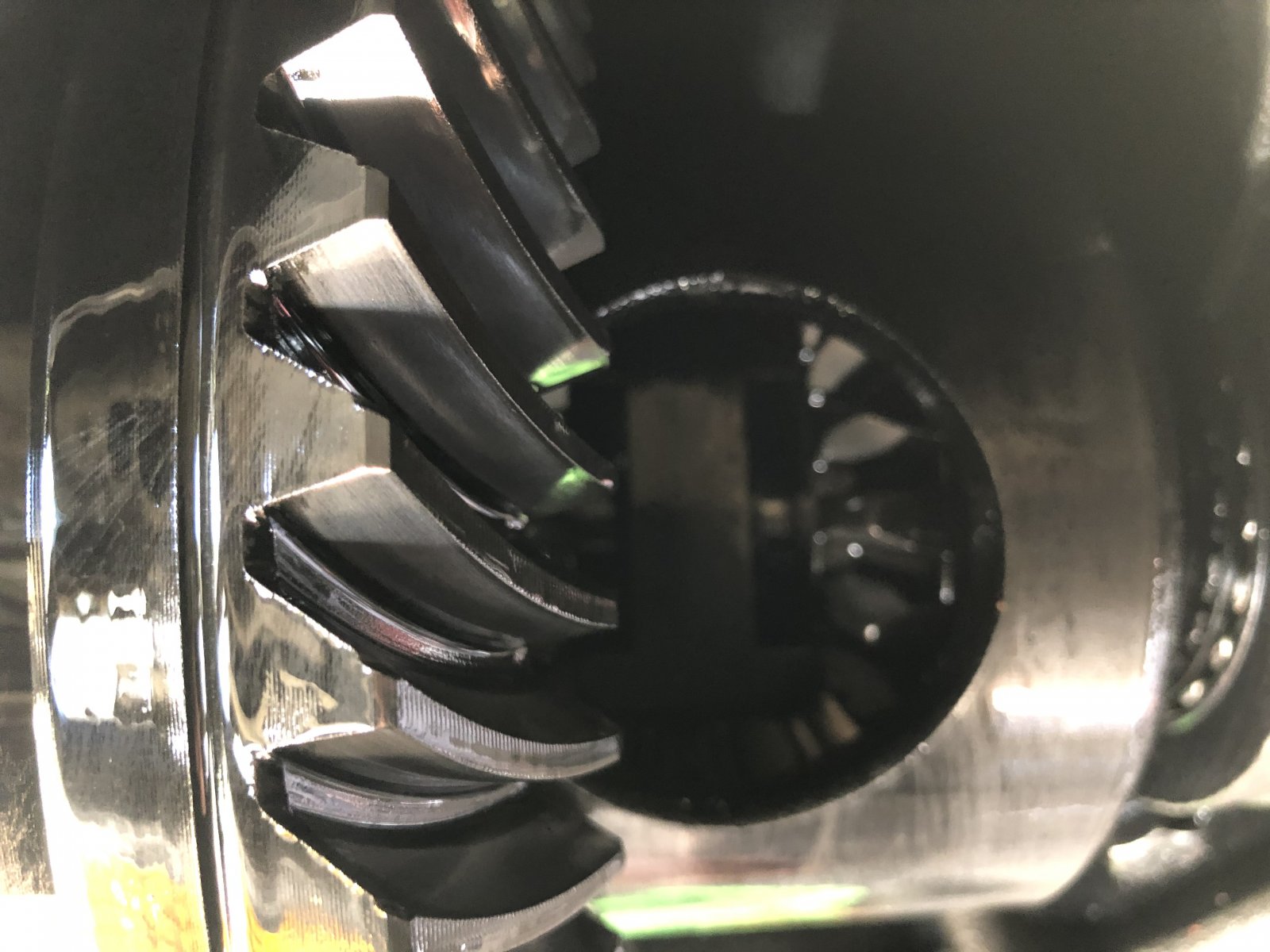

I got the bearings and seals in today. Still need to reinstall the brakes, girdle and sway bar, then refill the diff. Here’s some pics for those interested in doing theirs. After putting it on jack stands and pulling the wheels I noticed his grungy it is again after last Winter so I will be pressure washing when I’m done. The girdle has a drain so that was nice. The magnet had a tiny bit of fine metal but nothing to be concerned with. The gears all look great.

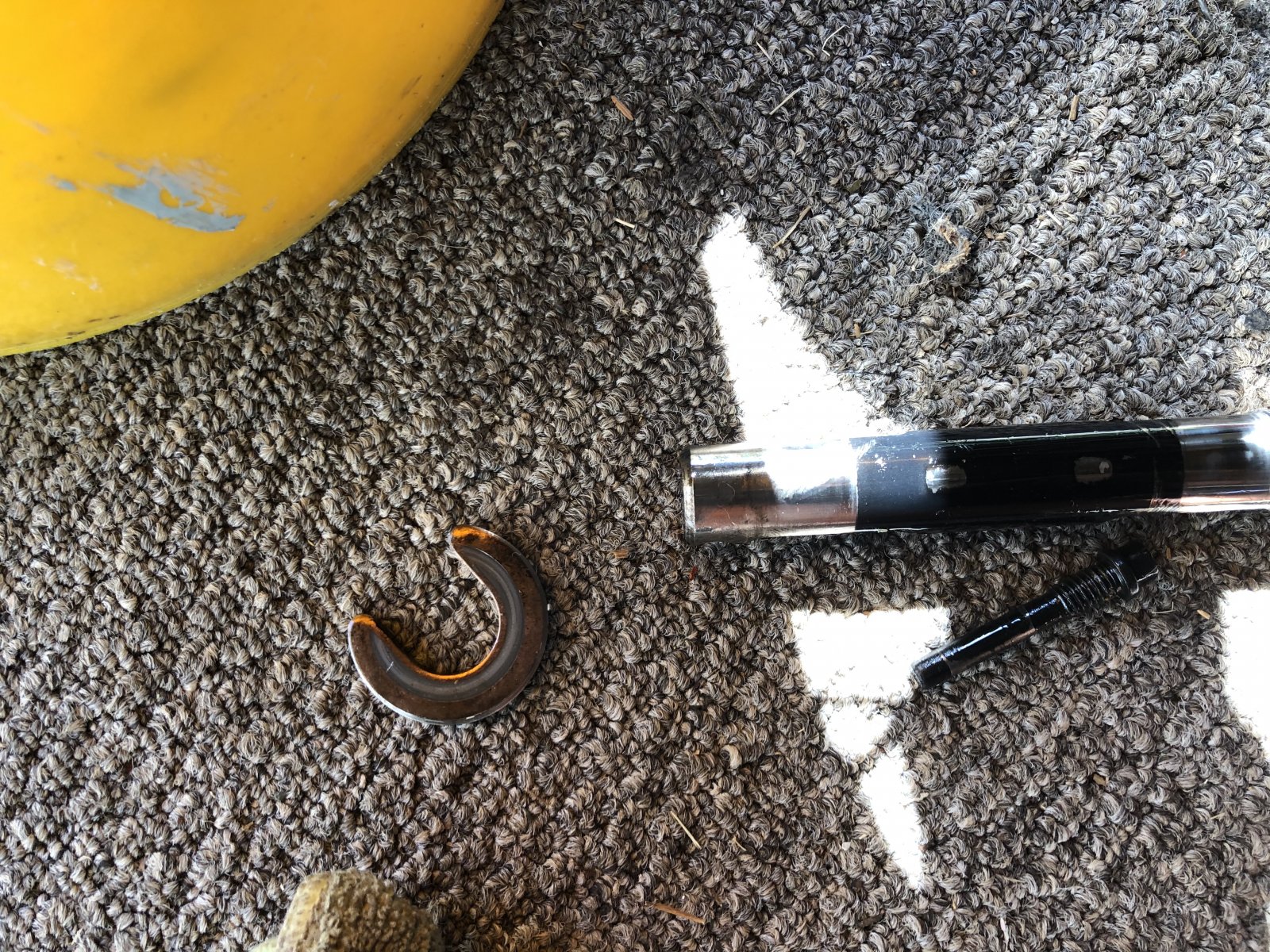

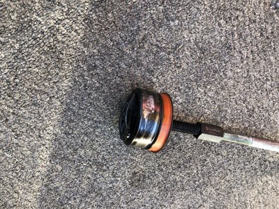

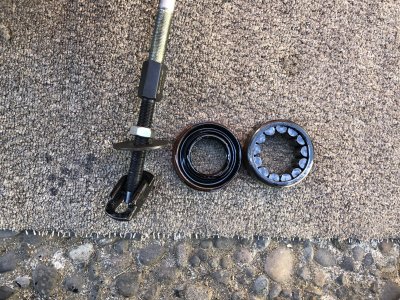

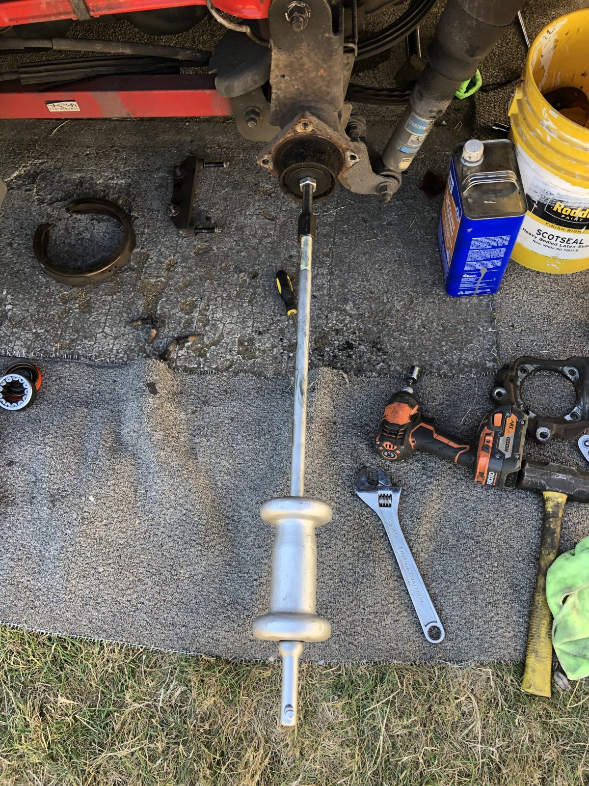

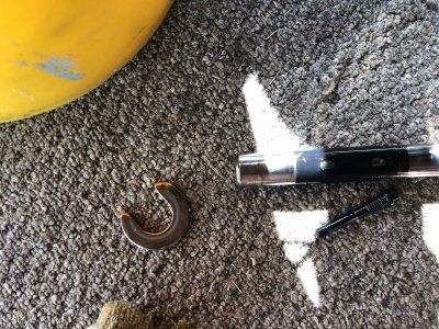

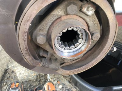

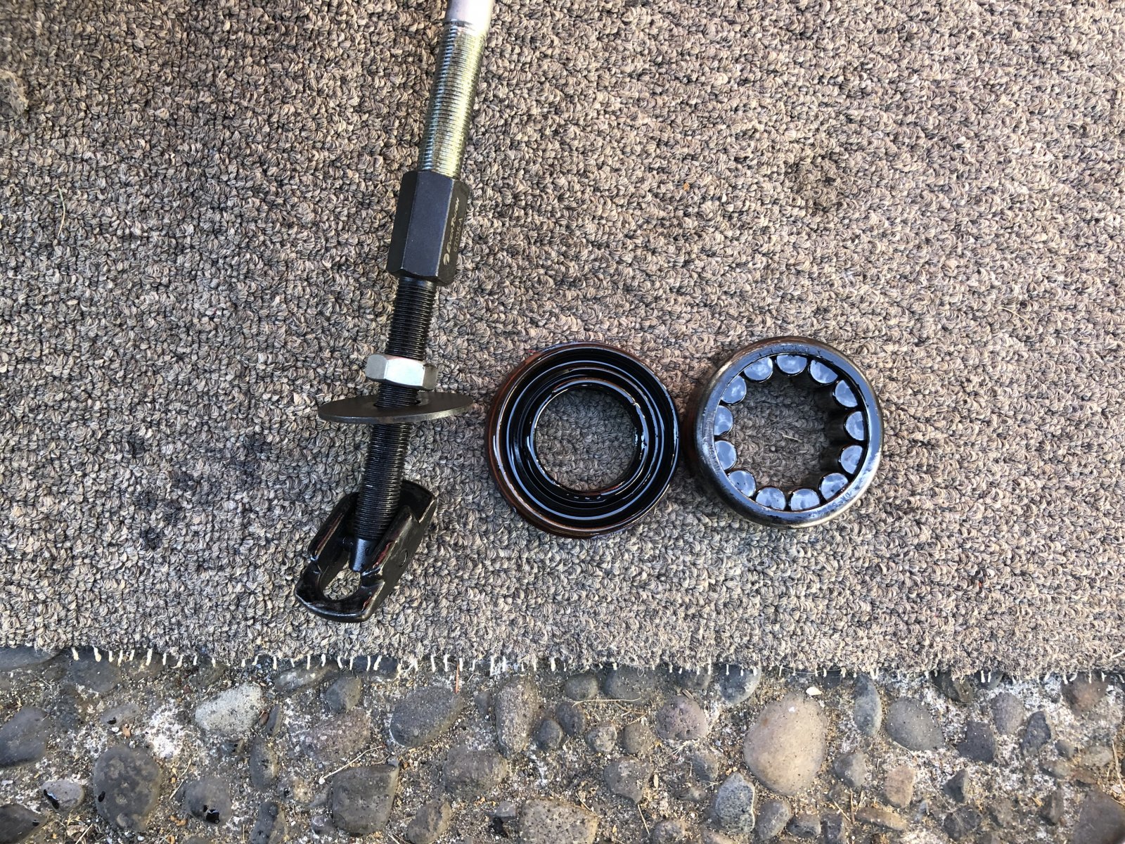

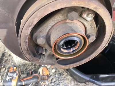

Next I pulled the calipers and rotors. Then the pin in the pumpkin that keeps the axles pushed to the outside. First rotate the driveline (trans in neutral) until the 8mm bolt and pin are accessible, pull thd 8mm bolt that secures the pin, and remove the pin. Then push in on an axle and remove the c-clip inside the pumpkin. A good pen magnet helps. Then the axle slides out. At that point I used a slide hammer and bearing removal tool to remove the bearing and seal, both at once. These bearings have 170k on them snd look like new.

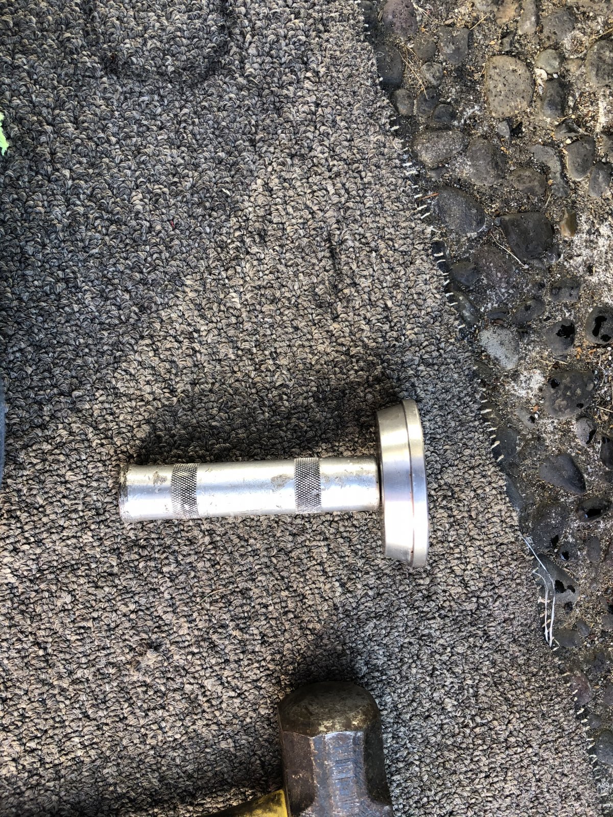

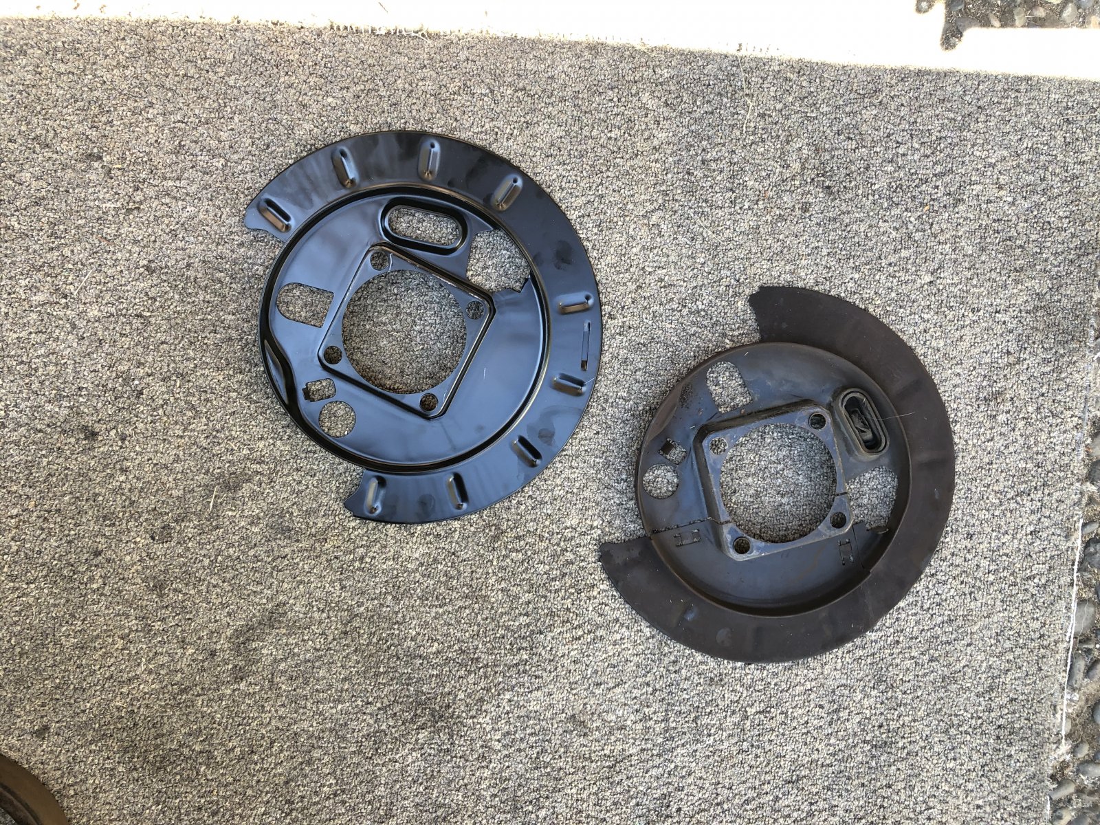

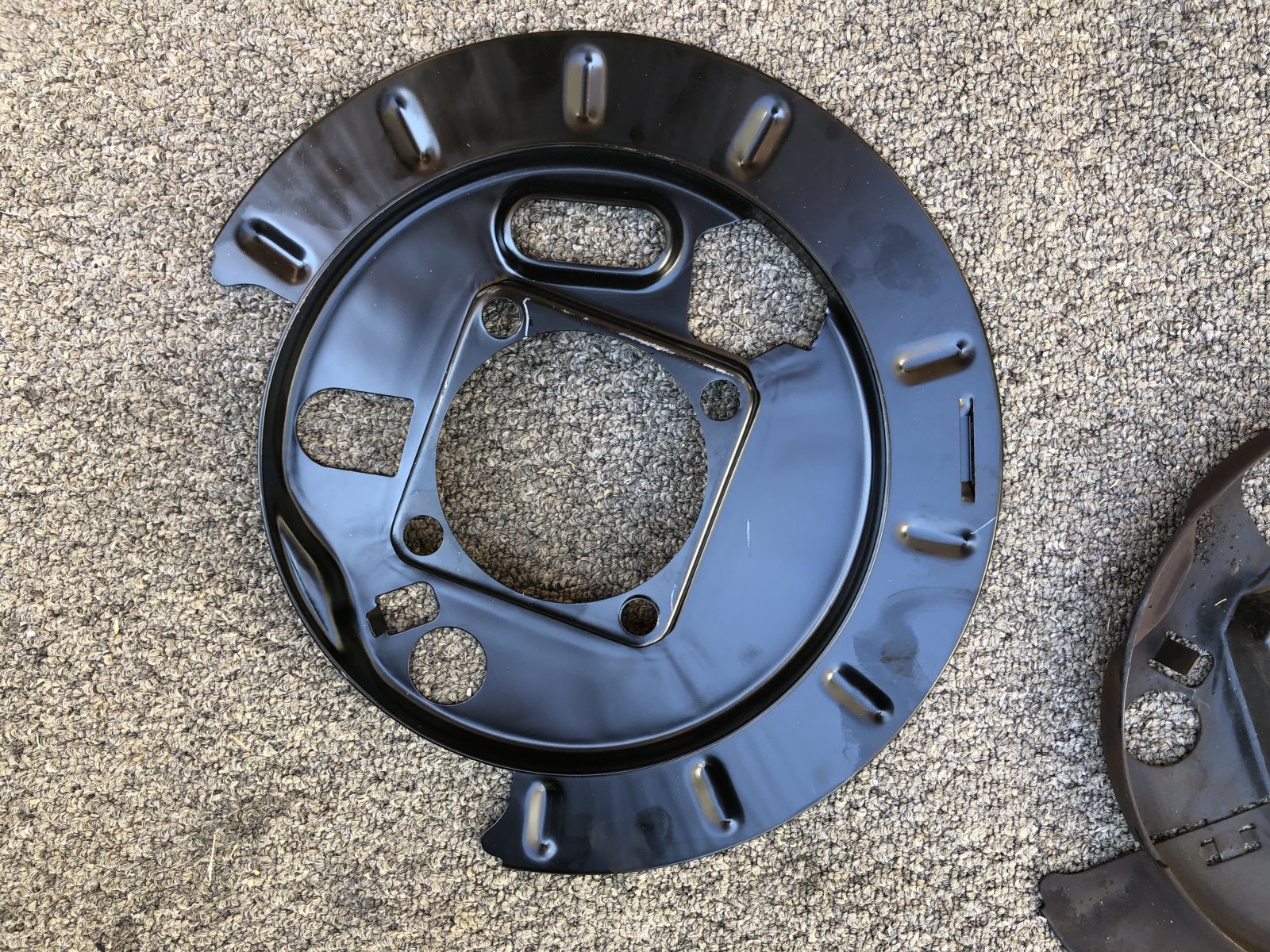

I used a bearing/seal installation tool and a bfh to install the bearings and seals. Just make sure they go in square to the axle so they don’t get bound up. I pulled the parking brakes and heavy backing plates so I could replace the 2-piece dust shields with the AC Delco 1-piece ones. They’re a bit heavier and a larger diameter. I figured since it’s all apart I would install the OEM ones. That’s about it. I just have to finish up tomorrow. If anybody wants a good video, 1AAuto has one that covers this.
