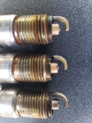

I checked plugs and the bad cylinders seem to be the same as the good cylinder. Took pics of 2, 4, and 5 and they all look the same. I'll share soon.

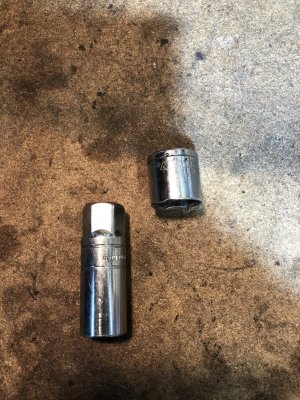

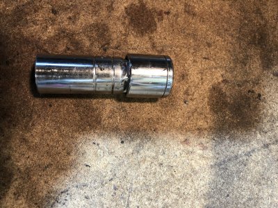

#8 plus is fairly easy if you put a 5/8” plug socket on, and use a standard depth 3/4” socket to turn the plug socket with, the plug socket will accept that socket. That’s the perfect length to put a ratchet on and turn it. I use a short extension in the plug socket by itself to get the plug started back in and hand tighten as far as possible, then switch back to the 3/4” socket to tighten it.
