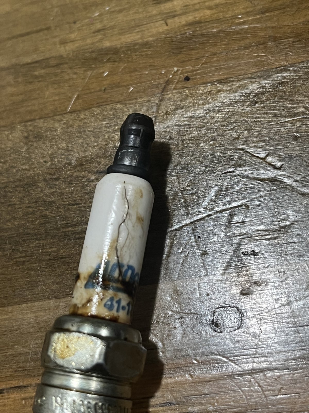

I did notice that cylinder 6 and 4 the plugs were cracked around the middle of the plug where the part number is located..What causes this?

Crack their is usually from poor install.
i dont see how you can poorly install a spark plug? it was gapped properly and not over or under torqued
There's some play in the plug socket, and there's usually a rubber donut inside to hold the plug.
This can apply sideways pressure to the plug end when LEANING on the socket while installing..
Pretty sure that's how I did one of mine in...
OR VietVet
GMT800 2005 Tahoe Z71
Military
Oct 8, 2014
22,993
42,410
Willamette Valley
Like @mikez71 said, you can use a socket that does not have the rubber insert, like a spark plug socket would. You know, any old 5/8" deep socket will do. And even if you do use the correct socket, if you tighten by just pulling/pushing on the ratchet and not holding the socket completely straight on the plug, it can and does happen. But, if you think that my response is full of it, have a good day. I mean, I am new at this and never installed plugs before, but I did sleep at a Holiday Inn last night.
