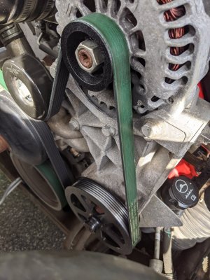

Well I installed my LSX Innovation lightweight alternator and PS pulleys. After fabricating a mid 90s GM V6 puller/installer to work.
