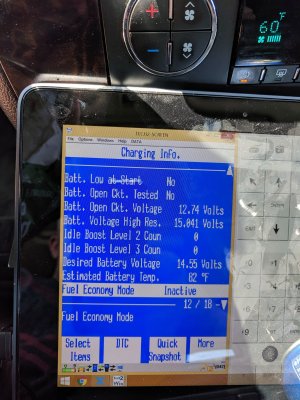

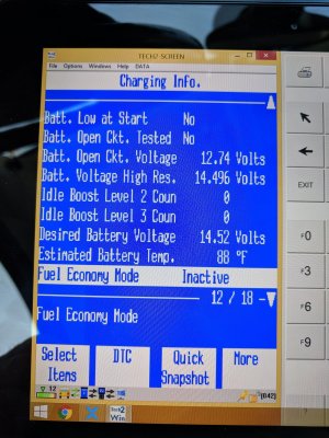

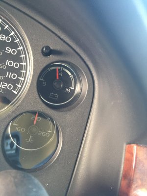

Did a little more testing on the charging system now that I have mechman installed and both battery's insulated, no matter what I turned on or off the fuel economy mode is staying inactive and battery temp is staying lower it was 92 today and even after I let it sit for 20-30 minutes in the sun after a 30 minute drive it didn't go above 88, it stayed 80-82 while I was driving, so maybe the insulation helps? Not sure guess I will check again next time it goes over 100deg, voltage is staying above 13volts and it's not draining the batteries with negative amps
