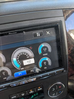

perhaps not but when the voltage is dropping to 11.3v that may as well be a dead battery, 11.8v at 3000+ rpm

fighting with this RVC voltage regulation, unplugging the sensor doesn't make any difference, has anybody ever tried to go back to the old 4 pin system or had the rvc programmed out? I thought maybe the alternator was funky again so swapped in the oem one still have the same issue voltage will drop down to 11.3, I have 2 battery's one is slightly newer than the other so switch them just to see and no difference either, I just ******* want 14v steady is that too much to ask??????????
Doubie, maybe different voltages on the batteries are confusing the system since they are hooked up in parallel.
In stock form (with rvc hooked up) and with a dvom on the back of the alt whats it putting out at idle? 2000rpm?
Whats volts at each battery at idle? 2000rpm?
Whats resting battery voltage?
Volts in morning?
Maybe one of your batteries is losing a cell??
Do all the tests above isolating each battery....with secondary battery connected and disconnected then with main connected and discon.
When i was researching I remember one article mentioning with a parallel system if the batteries are different...voltage, type etc it will funkify the system.
My batteries are exact type, size, and the voltages are with .2v -.3v of each other..
You could always try swapping to a smaller pulley. That way it will spin the alternator faster while its idling, well it will spin it faster all the time but you understand what I'm getting at.
When I had my 1st gen Esky I got rid of the mechanical/engine driven fan and upgraded to the GMT900 dual electric fans.
When my 160A alternator finally crapped out I had a friend of mine that owned a rebuild shop rewind it to a 200A.
He told me he could rewind it up to a 260A but that it basically would not charge at idle.
When I got it back from him it still didn't charge as much as I wanted at idle so I swapped to a smaller pulley from an old alternator I had laying around, it may have been from an old S10 I don't really remember.
Anyway, that did the trick and it charged well at all speeds. The only down side was I had to run a slightly shorter belt to keep the tensioner happy.
