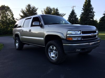

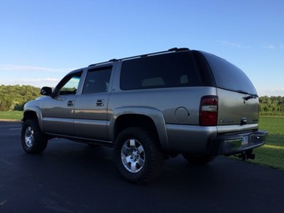

Here are 2 rigs of members on here that I saved pics as inspo... sold my 05 Denali for good coin and picked up an 02 Denali for cheap to do the same. I'm thinking of taking off all the moldings and throwing flares on it, spacers, 275/60r20 like the gray one

That's a good looking Tahoe you got there. And now that Denali is great canvas to start with. I've always liked the Denalis and if I could do an even trade, I would trade my Burban for a Denali XL in a heartbeat.

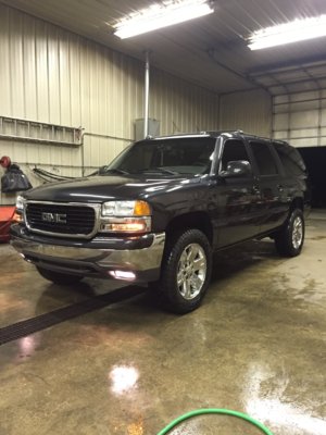

Parts should be here in a few days so here are a couple before pictures. I think it has a 2/3 drop kit installed because I’m at 33” in the front and 34” in the rear. My Tahoe was 34.5-35” in the front and about 36.5ish in the rear before I lifted it. The Yukon is also resting on the bump stops. Im also getting a clunking sound under hard acceleration when it squats. Only does it when I’m going slow and floor it. so I think it being lowered might have something to do with that. Checked everything under there and serviced all the fluids and nothing was loose. So hopefully when it’s lifted it stops.

Might be the slip yoke. It's actually a fairly common issue on the NBS trucks. The driveshaft needs to be removed and some grease applied to the splines inside the slip yoke where it slides into the transmission. Then put it all back together. Takes about 30 minutes to do, it's not hard at all. I would definitely try that before throwing parts at it trying to get rid of the clunk.
I’ll definitely give that a shot when I install the lift. Thanks for the advice buddy.
